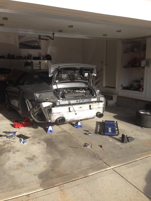

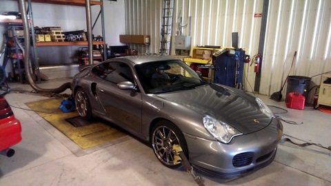

Hi guys I'm smiling , but there is always story behind . Sunday morning dyno day , so I'm disconecting front diff , 15 minutes work and going to fill race gas exited to see the numbers , 14 gallons of 100 oct - wide open throttle - misfires
did couple more pulls they gone , but started to worried , went on the dyno ended up with 462 and 550 tq at the wheels I knew something didn't worked right after talking to Markski we decided to change the plugs and coils , I changed them in my garage using stands thank to DIY provided by vividracing in 4 hours ,
could get it done quicker but I checked everything I could get to . pretty easy job , second time will be a lot easier , Denso double iridium gaped to 0.024 , put everything back together , started up , I didn't realized it was my car

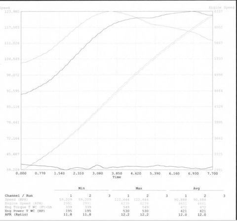

so yestarday I went to dyno it again , but no rash this time, fans , logger , flasher (I tried different tunes)

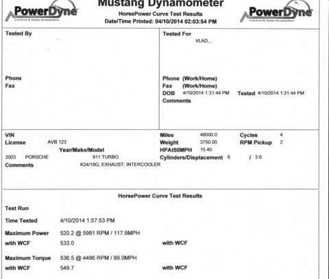

couple pulls the numbers where constant 530 rwhp/550 ft on the rear wheels , but adventure is not over yet , I had a slight clutch slip and my oil pressure sender dead on the dyno . After talking to 911tuning Markski again we both think I have more room to play with timing and boost I hope for best , I know 911tuning can do it and max it out Thanks man for you help !

You running a 5 bar or injectors with those 18g's?
Old Apr 11, 2014 | 01:30 PM
fairbird's Avatar
Joined: Jul 2013
Posts: 294
From: Omaha
fairbird has a spectacular aura aboutfairbird has a spectacular aura about
3.8 bar stock FPR , 62 lb injectors .

Do you have intercoolers upgraded? Numbers seem a bit low for 18G's and injectors.
EDIT: Just missed your last post. Hmm. I would have thought you'd be closer to the 600whp amount.

yep we think the same with Markski and it's a mustang dyno , on the dyno jet with current soft it will do 560 or so .

There is couple things that makes the car faster : ignition timing and boost with proper fuel
In my case just by changing plugs and coil packs I added 70 whp which is a lot ! What I'm saying is that car can be pushed harder , and to do it I need new clutch I can't even log the car . If it was a dyno jet for example the hp reading was about 560-570 hp , now another point it's conditions , outside temp , humidity , those pulls where made on 85 F , for example on 65F wether the reading would be 545 or so , so it's not just turbos and injectors is it makes sense ?
