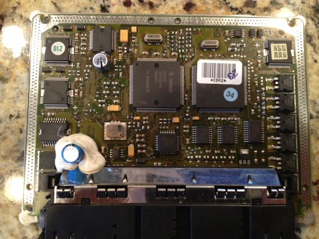

Hey Guys! I'm a proud new owner a black/black 996 turbo and absolutely love it. I'm hoping to have a little fun with it and am stuck on software at the moment, here is my back story and hoping the 6speed community can help me out.
I purchased the car from a dealer a few weeks ago with intake, exhaust, and software. I was told the software was EVOms, and drove off a happy camper. 500 miles later, I threw a p0420 code (probably from exhaust) and quickly cleared it. A day or so later when I drove the car again, it felt a bit slower. I couldn't tell if it was me getting used to the car, or actually dropped in boost ( i have a few other fast cars as well ).
I called EVO they said they didn't have the VIN on file. They said it's possibly an older tune (before they kept vin's) which COULD happen, but there's really no way to tell. I check the boost gauge and it's hitting .6Bar and holding constant, to which I find out is stock boost (unfortunately i didn't check the gauge when I bought this car or before this started).
So...after talking with EVO (my experience has been great so far!) they said to pull the ecu and send it in, it would have improved software either way, and would be a much better feeling car. I pull the ECU and it has the EVO sticker on it...hmm...I take the ECU apart and send pictures in to EVO and they said it looks like the OEM hardware.
I decide to go for it, and send the ECU in to EVO, but to my surprise the USPS messed up and sends it back my house (facepalm or blessing in disguise?). Now i'm second guessing myself, wondering if there was a boost leak or some other issue and that's why it's not hitting 1Bar OR it could possibly be the stock ecu. I'm nervous about sending the ECU off WONDERING if it's going to come back night and day faster or not at all faster. Another part of me is thinking about doing the k16 billet upgrade which includes software, which would mean my money to EVO would be a waste.
My question is this : is it possible for the car to go into limp mode and revert down to .6Bar? The car still feels strong at .6Bar though... Is it possible for the software to revert back to stock? Or is it possible that the ecu IS in fact chipped, but there's something else reverting it down to .6Bar? I'm hoping you guys can help me out.
For reference, here are some pictures of the ECU when I pulled it out. Thanks to anyone / everyone in advance for the help / suggestions!

can you lift the board off of it and take a pic of the other side? or is it glewed?
older ecus form them had giac software and they often had custom chips soldered onto the eprom chip or it was actually removed...
good luck

I tried to lift it up, but it feels attached. I could try harder, but afraid it would snap something. Is it glued from the factory, or does giac do that?
Factory glues it. Leave it alone.

Does that mean is factory? Why would it have a random evo sticker on it?
It means evoms tuned it.

If it does have the old GIAC software in it, why would it only be hitting .6-.7 Bar?

Any idea on this ECU deal? I suppose nobody has a picture of a STOCK ECU they could post up? Not even sure if that would help me in the first place...

Call me. Had same issue. I will explain.
P.S. Looks same as mine.
