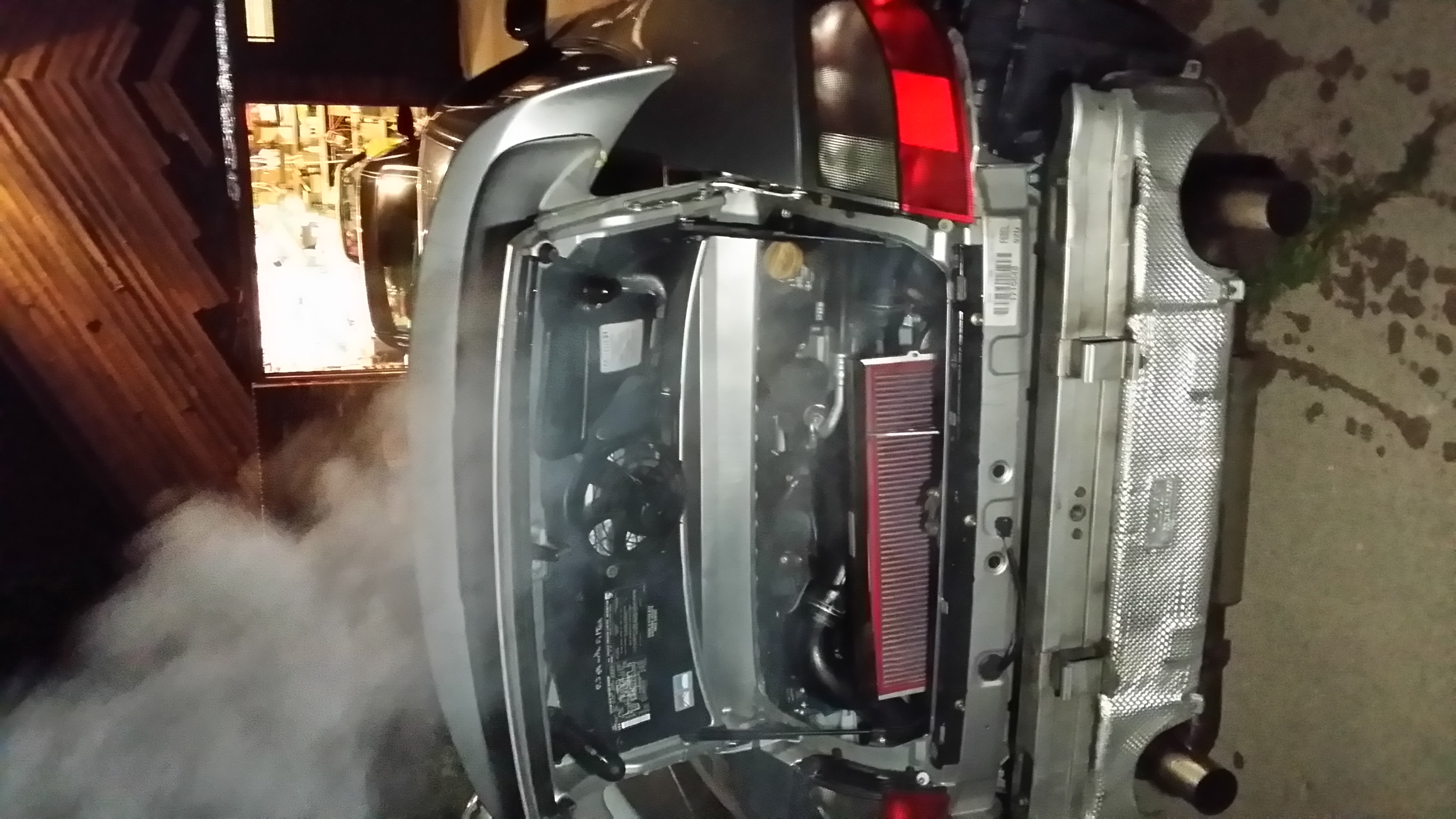

Smoke test it. Are you sure you put all the connectors on the right devises IE injector or cam actuator..

I will do a smoke test / pressure test.

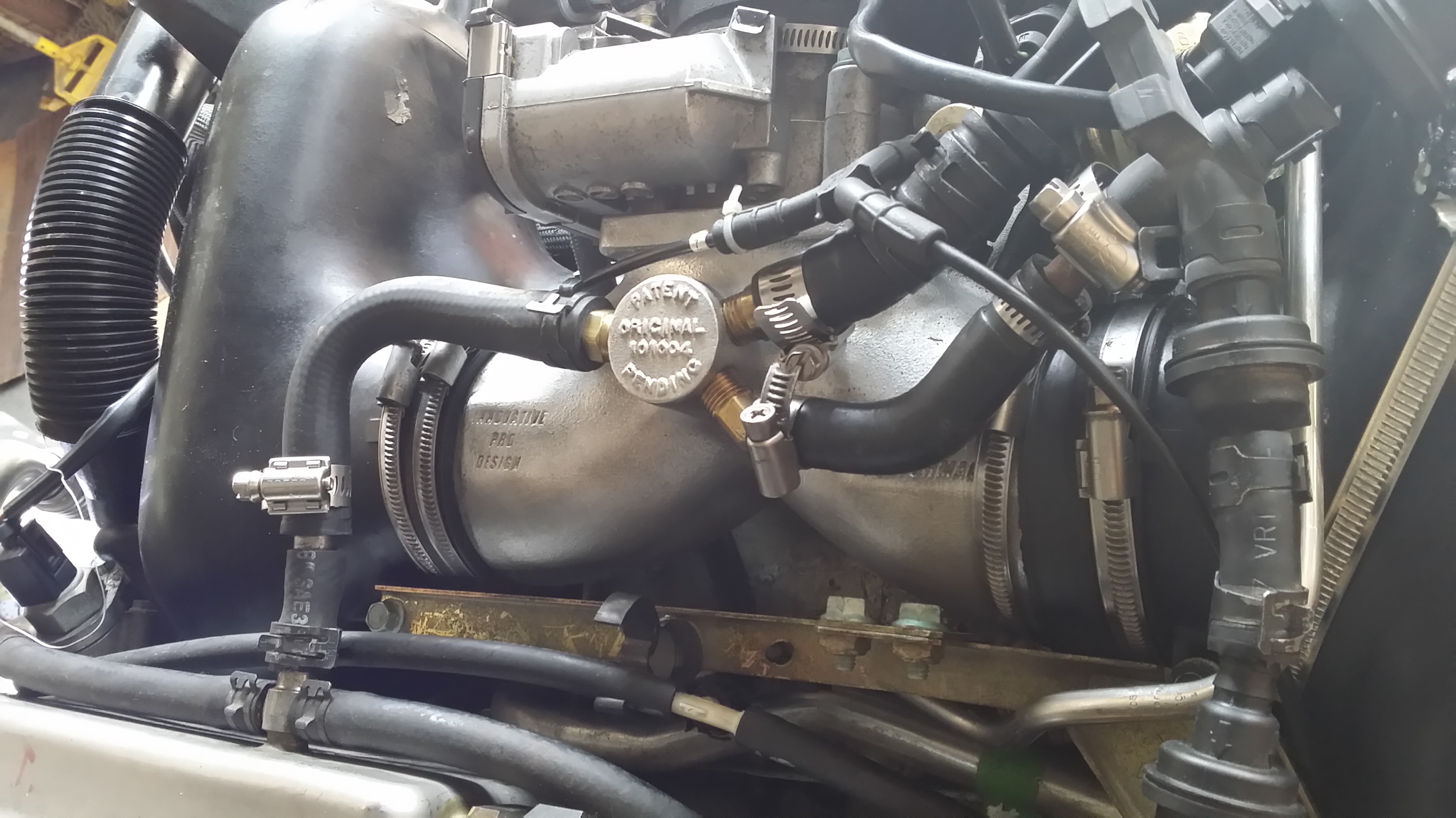

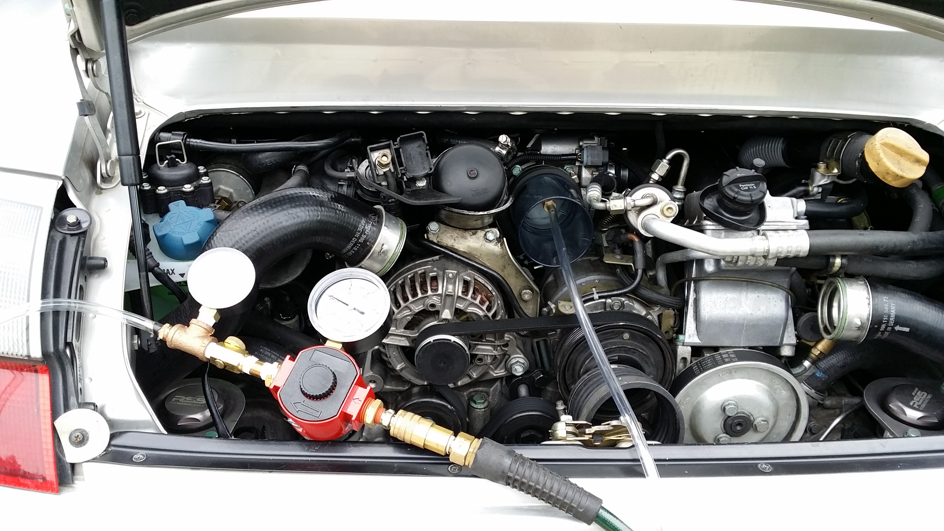

The plenum popped off.

So the plenum popped off and that was the issue? Backfiring can cause that...hoses to pop off, etc. I'm thinking a timing issue. Like what 32krazy mentioned. Let us know.

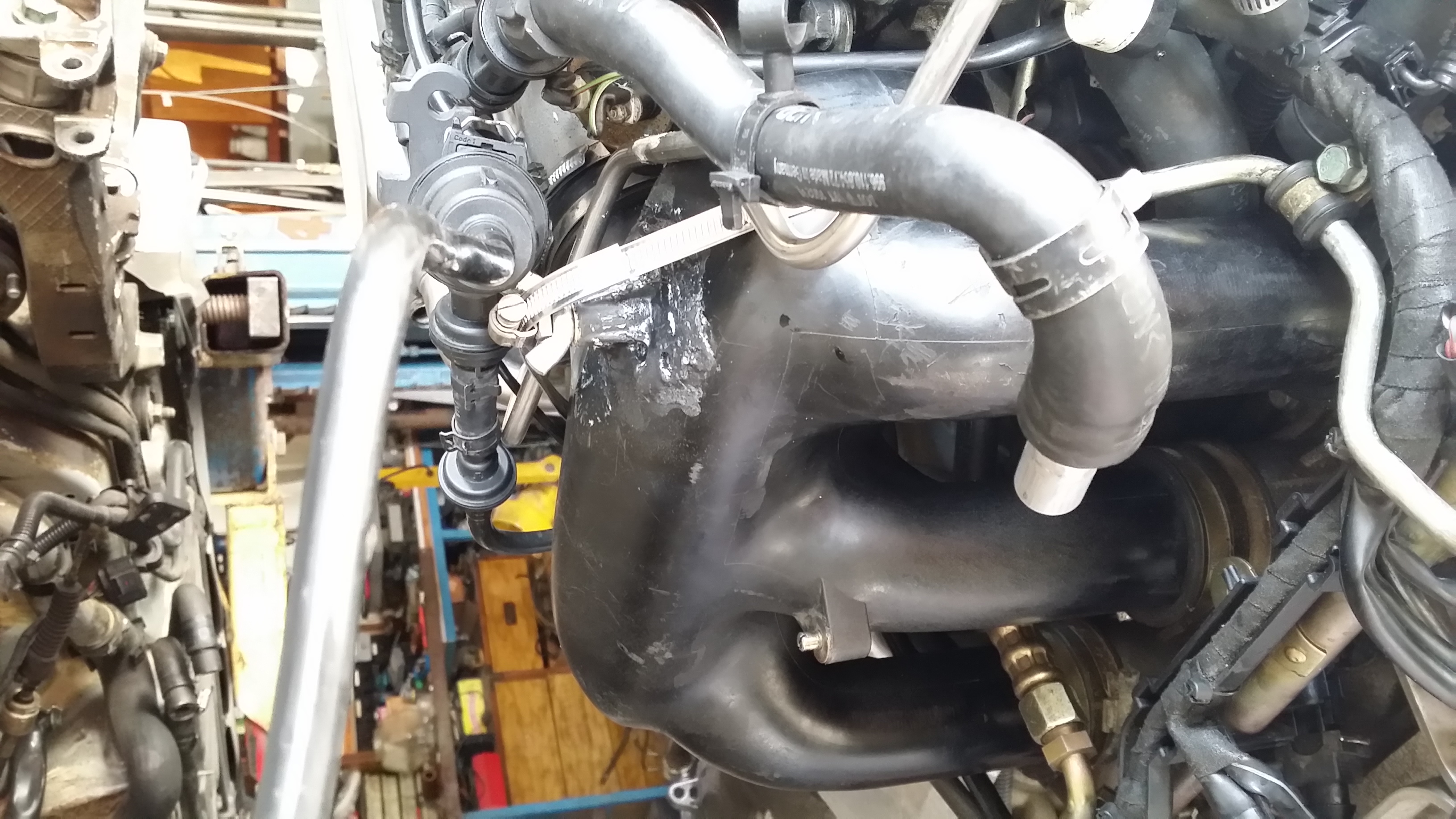

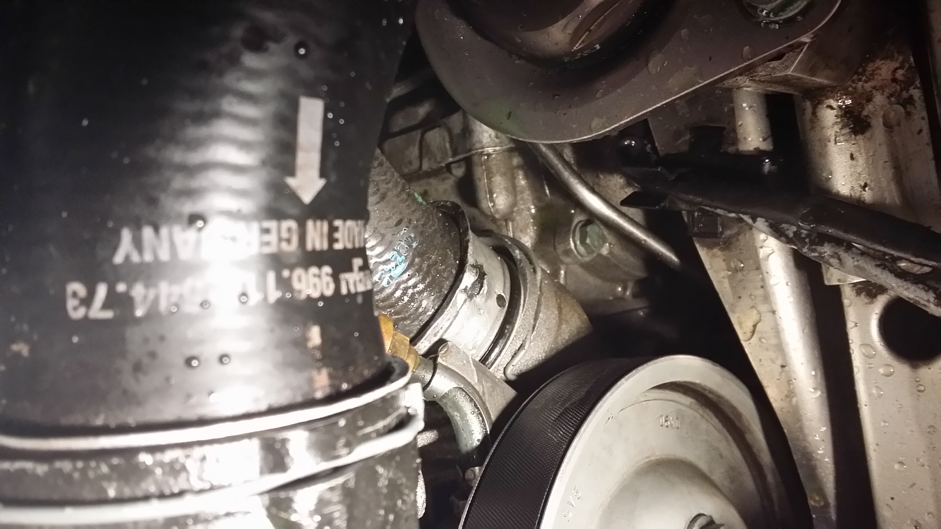

We double checked all else and all seems fine. Added a hose clamp on the plenum were they all seem to crack. Should be a few days and we try her...

I clean the hell out of the rubber couplers. I use brake cleaner to do so. Any oil in there or on the intake will greatly help the intake to pop off

We put everything back together and it is running fine.

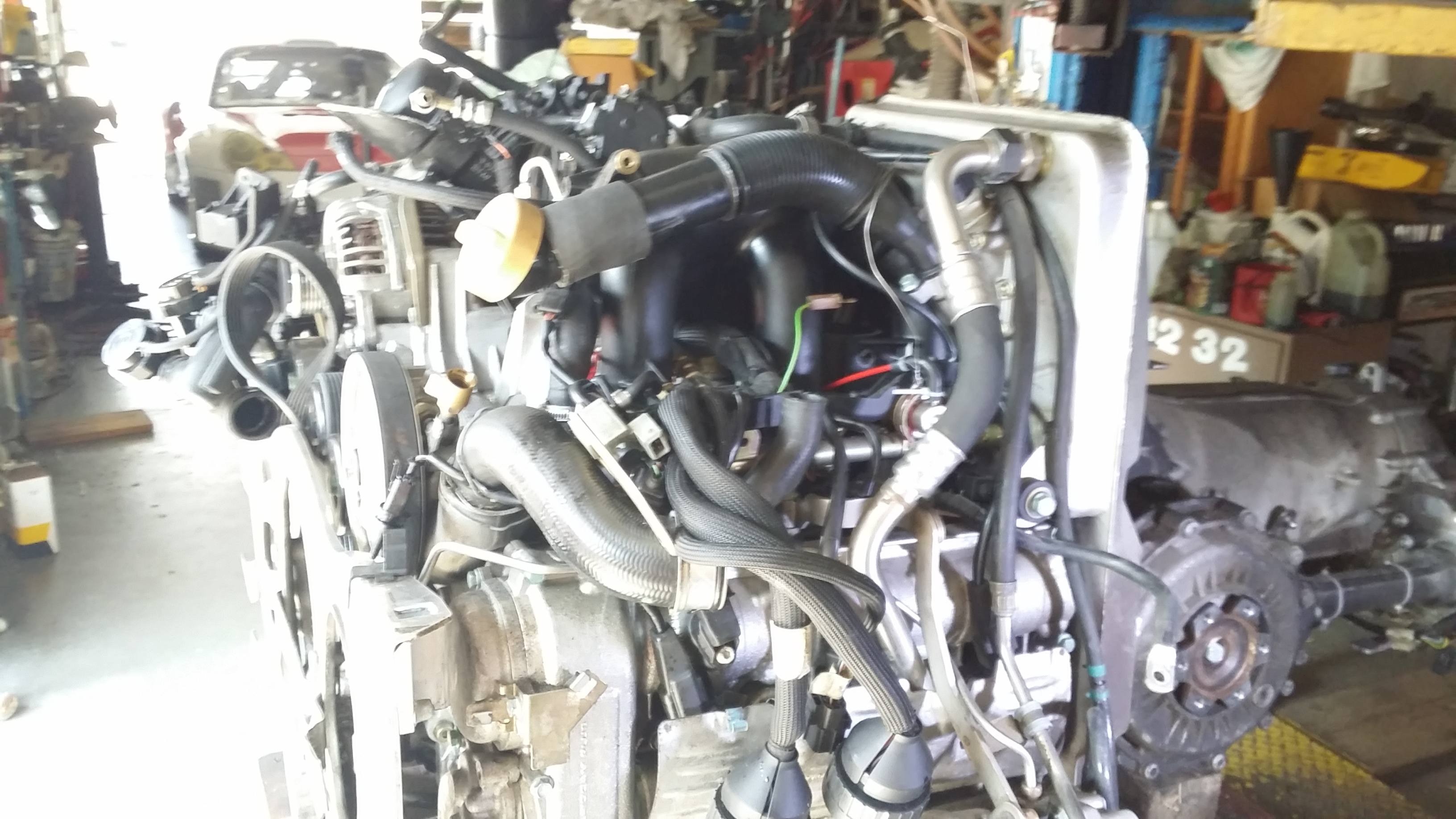

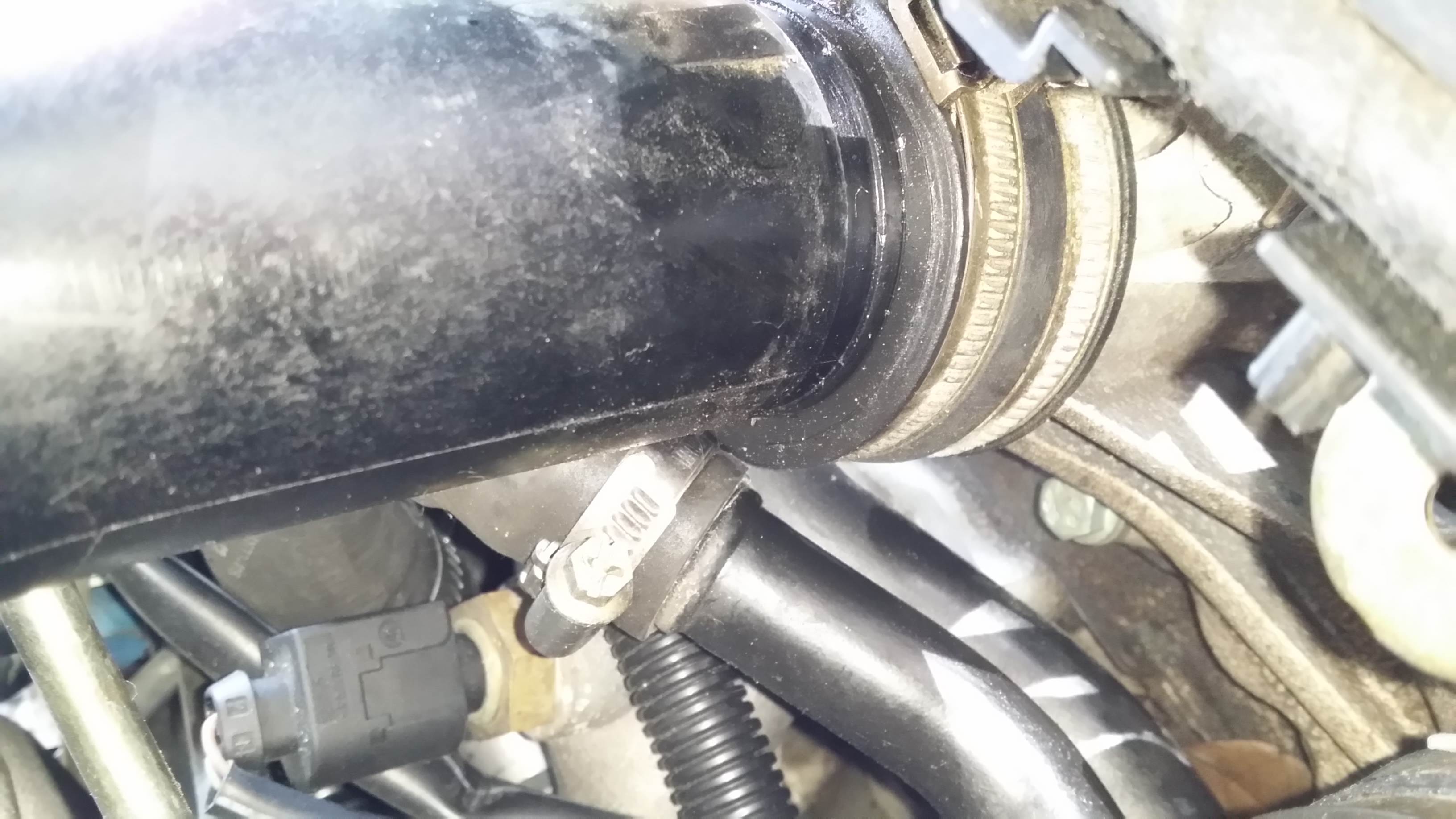

Note to self... this big coolent hose has a clip on both sides to hold it in. The clip is just slightly different on either end. They interchange but are not interchangeable. The hose will pop out if they are wrong. I looked it up on the drawings. They have different part numbers.

Yes the one that goes on the engine side is slightly bigger then the one that goes on the body side.

I found it while doing my pressure test! If you look at post #110 you will see there is in fact more than six types of clips…Not to interchange!

Boost leek . Found it . Looks like we forget to put the check valves in.
