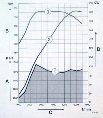

Well, that and the boost curve that is pre-programmed into the ECU:
#1 = stock boost curve on K16 turbos

Notice from the graph that the stock turbos start making boost at 1100 RPM.
