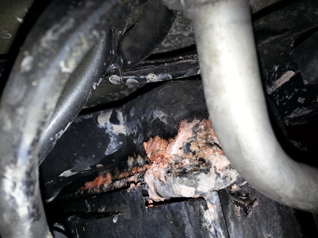

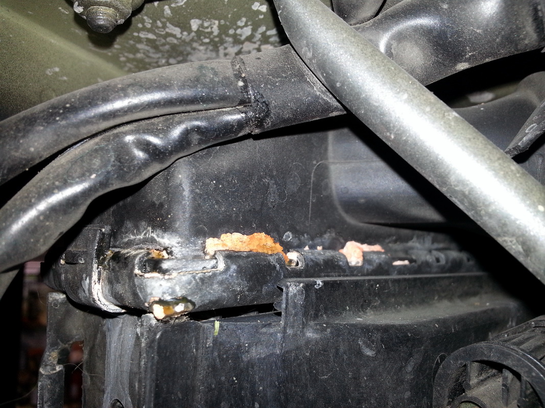

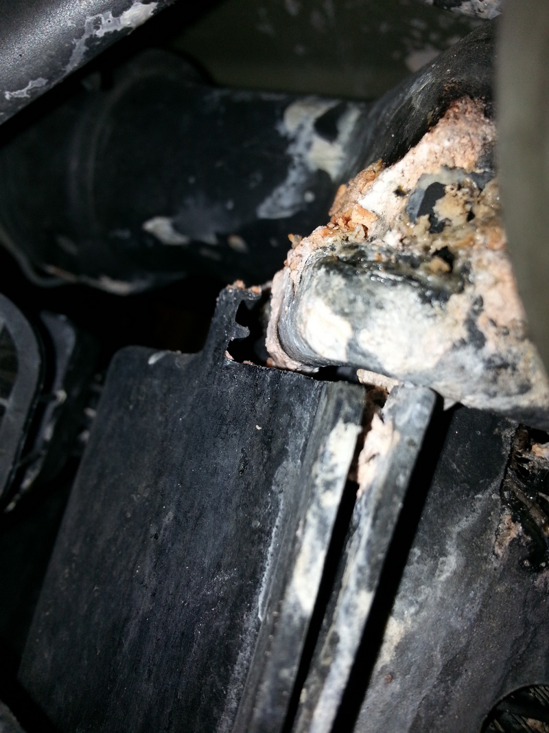

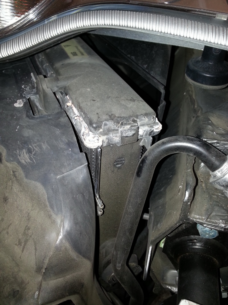

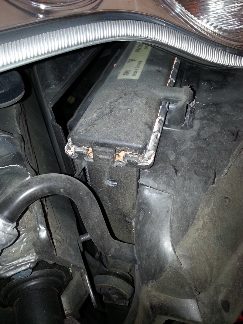

Hi All,
The group buy from GMG for the CSF radiators is great timing for me. I want to post a few photos of what I found last weekend when I removed the front bumper to replace a horn. The left radiator isn't that bad with a little bit of crusting at the top, but dry for the most part. The right was a bit worse with active wetness. I didn't see any leakage around the center radiator, but I am wondering if you think I should replace all three. The local dealership said not to replace it if it isn't leaking. I want to get in on the group buy but I have to make a decision on spending the extra $500 for the center.
Let me know what you think. My car is an '04 X50 Cab that we just bought a couple months ago. The radiators were missed on the PPI along with a wonky throttle body. More on that later...
Thanks,
Franny

at this point, I'd say replace all 3 with the CSF rads and never look back.

I would replace all three and consider it done.

I would replace all three. I'm doing all of mine since they are 11 years old.
