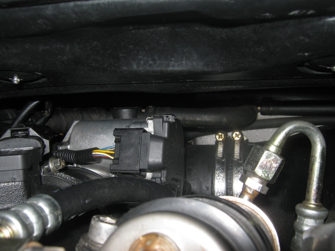

Isn't that the break-boost line? If so, I disconnected it at the end (4) and sealed it off (first photo). No change
The other end of it goes right back to the intake plenum...
I would love to get in and crimp tube 18 and eliminate that whole mess.
Hey, how about that bit that goes off to the right (2nd photo). Looks like it goes to the oil tank? I can't seem to get a diagram for that run. Oil gets hot... Is there any check valves there that could fail?
I'm making the wild assumption that since I can hold pressure that it must be a check or solenoid valve. Does that sound reasonable?
These things could be a little easier to get to... Maybe I'll get some vice-grips from HF and grind the teeth smooth so it won't harm the tubes and crimp a few sections off.

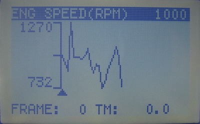

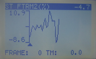

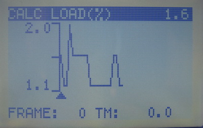

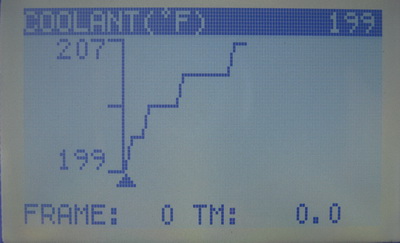

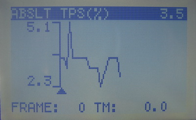

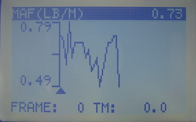

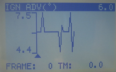

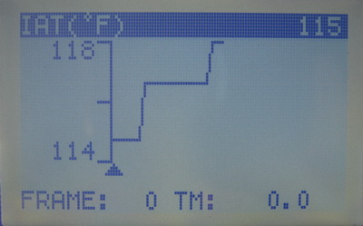

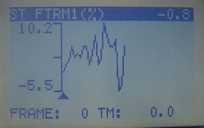

Some fun photos...
I set the scanner to record and graph over about a minute or so (78sec). The little blip up to 1270rpm was me to get it to do its little trick before the fans turned back on
Graphs are:
MAF (lb/M)
Calculated Load (%)
RPM
Absolute Throttle Position (TPS%)
Coolant Temp (F)
Air Intake Temp (F)
Ignition Advance (deg)
Short Term Fuel Trim Bank1 (ST FTRM1%)
Short Term Fuel Trim Bank2 (ST FTRM2%)
Let me know your thoughts... It seemed to oscillate in a minute or so cycle. Pretty consistent. When the cooling fans turn on, it settles down to 760 or so and stays there. These graphs were taken with all accessories off (no AC) and the cooling fans off.
I'll post the next graphs in the next post...
Thanks!
Franny
Graphs are:
MAF (lb/M)
Calculated Load (%)
RPM
Coolant Temp (F)
Air Intake Temp (F)
Thanks!
Franny
So, here's a question... What is the correct throttle position percentage for a normal idle with the car well warmed up? Maybe the computer is driving the TB below that to try and get the idle down and then eases up, but the idle then creeps up?
Am I still chasing a leak or am I looking at a bad component (sensor, or MAF or TB)?

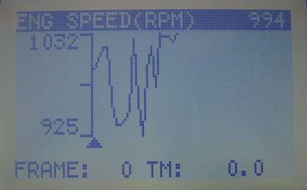

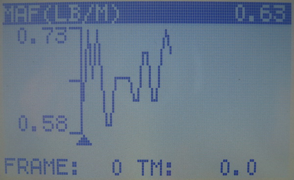

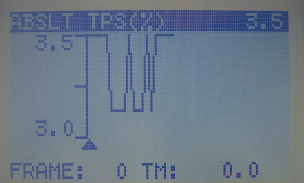

I ran another data log... This one is over about 70 seconds... It was after the ride home so good and hot. I didn't touch the throttle at all, the clutch was in, temp was at 198deg, no AC or fans on.
The idle never settled down to 780, but the TB never went below 3.2% either. when it is idling at 780, the TB is at 2.4%... I just don't understand why it won't close the TB to 2.4%. It does when it is cooler. It seems to idle high because the TB is being commanded to be open. Is 2.4% correct for idle or is that too low?
Arrrg This is so frustrating...

I do have a graph of that too; same run...
You think the MAF would cause the computer to command the throttle open a bit? The car did throw another P0507 last night
...or if the computer is commanding a lower throttle and the TB just isn't responding, and the %throttle is just being read off the potentiometer in the TB... That would kind of make sense... Because a P0507 says that the computer is past its ability to lower the idle. Weird if it reads so high... It would seem like it has plenty of room to lower it at 3.4%.
