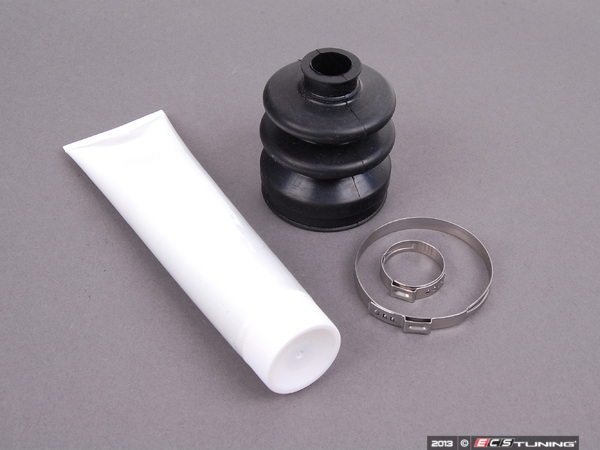

Originally Posted by ECS Tuning - Porsche
We offer have a kit for either the inner or the outer boots. For more information Click Here. Let me know if you have any questions.
i have a question. are both inner as well as outer boot kits needed as replacement(s) for a torn boot? i will do both sides in front.
TIA
Usually, the outer boot goes (on the front) because it has to swivel a lot with all the turning. The inner boot just goes around and there are few forces at play that cause it to rip. I would only replace the boot that is torn. A boot that is not torn is packed and full of grease and does not need to be messed with.
