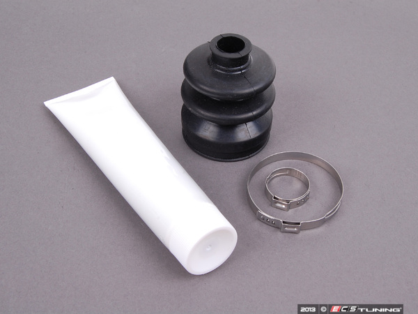

Old May 6, 2014 | 11:17 AM
ECS Tuning - Porsche's Avatar
Joined: Mar 2012
Posts: 9,607
From: Wadsworth, OH
We offer have a kit for either the inner or the outer boots. For more information Click Here. Let me know if you have any questions.
