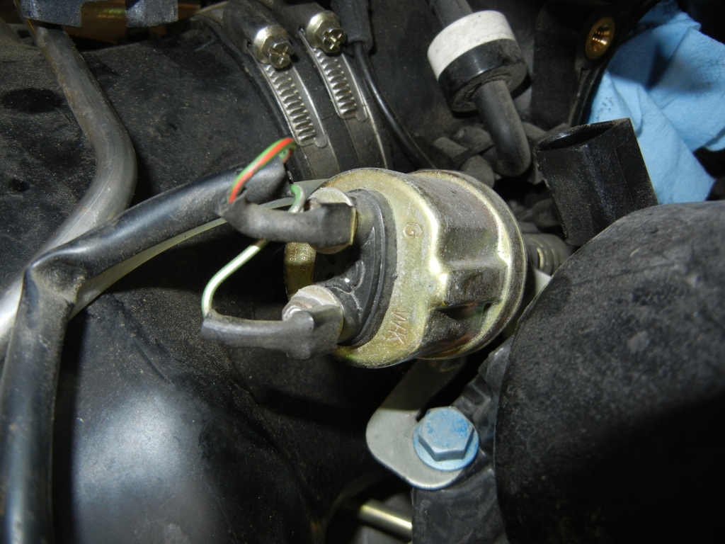

+1 on checking/moving connections on the oil pressure sender, located right behind the oil filter housing
