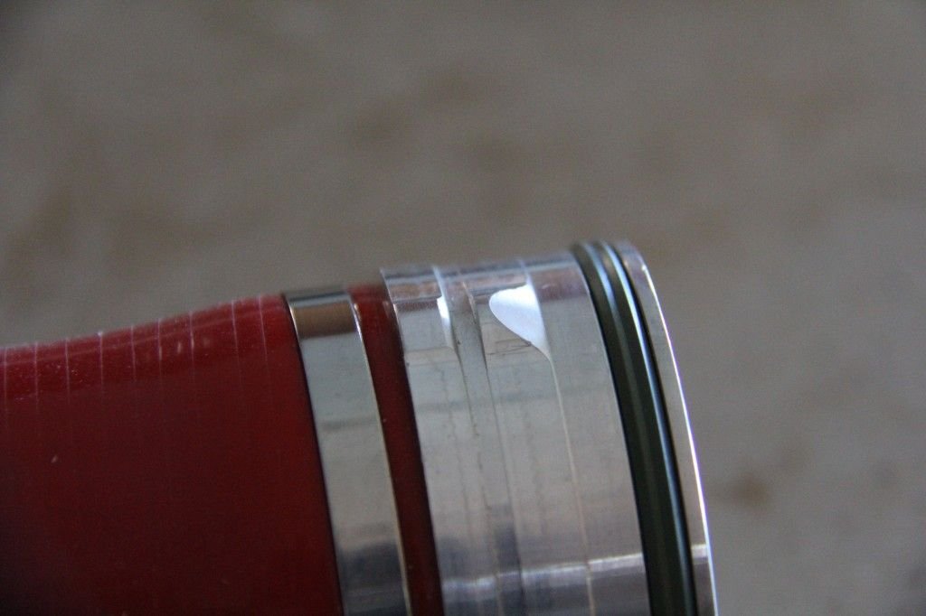

I just installed some nice MaxSpeed boost hoses. I think this should illustrate nicely the problem with OEM hoses. The red ones are the new ones. Note the machined tab, then look at the OEM. The tabs get bent, you bend them back and they eventually just break off.

Do the maxspeed hoses seem like good quality? I've been considering an upgrade, but the newer oem hoses seem to be built better and can be had for about $70/ea.

Well, you can see from the close-up - I haven't seen anything better. The hoses are actually a little bigger around than OEM also. I just tested mine to .9 bar with no issues...
I'm happy with them.

Absolutely - if you never touch the hoses, they will never fail. What screws up the tabs is removal and re-installation. If you spin the hose while fiddling for fit or to get it loose, it will put pressure on the tabs and reduce the height they extend which then makes it necessary to pry them back out. It's a nasty cycle that leads to eventual failure. But... if you never touch them - no problem. The new hoses seem a little bigger, but unless you have bigger turbos or other increases in capacity, they won't make a difference in performance.
