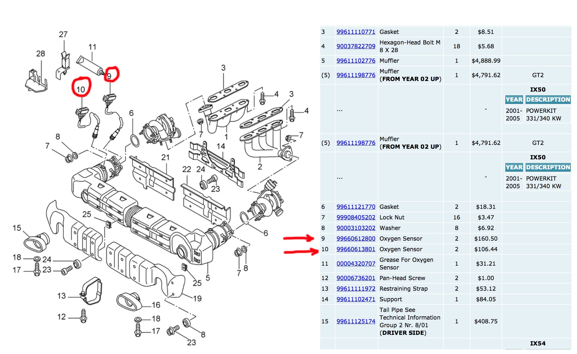

Before cat: 99660612800
After cat: 99660613801
If you look an Ebay you can pay between $22.00 up to $154.00 for the after cat ??? And for the ones before $95.00 to $315 !!!! Oem from Sonnen after $229 and before $206…. Imho Denso or Bosch should be good and there are some very good price on Ebay….
