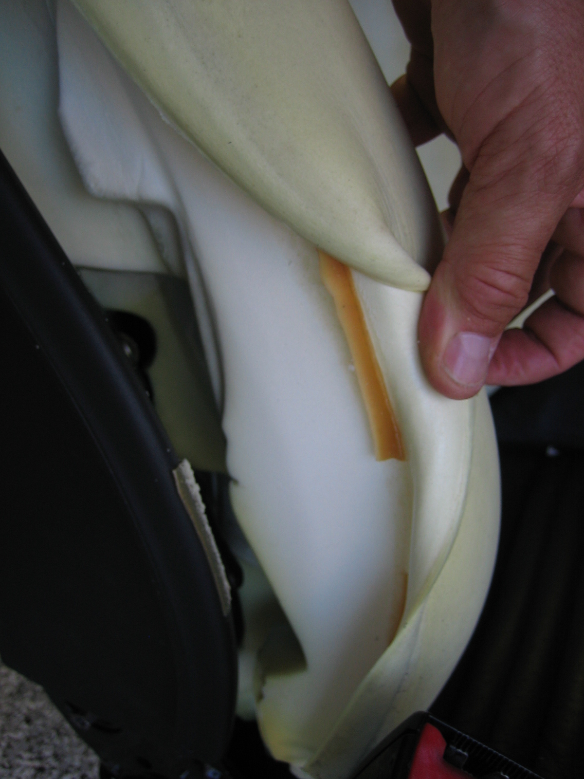

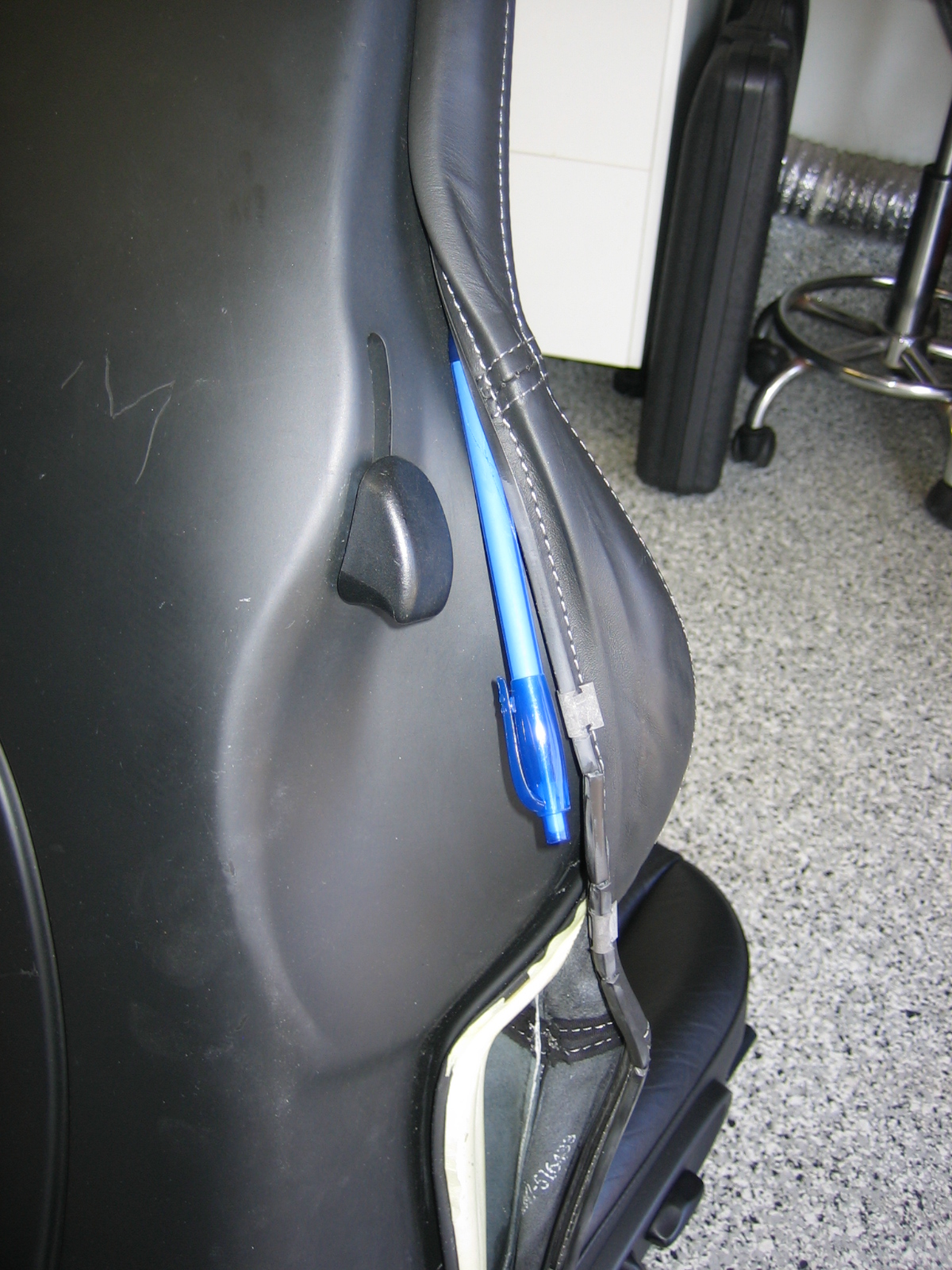

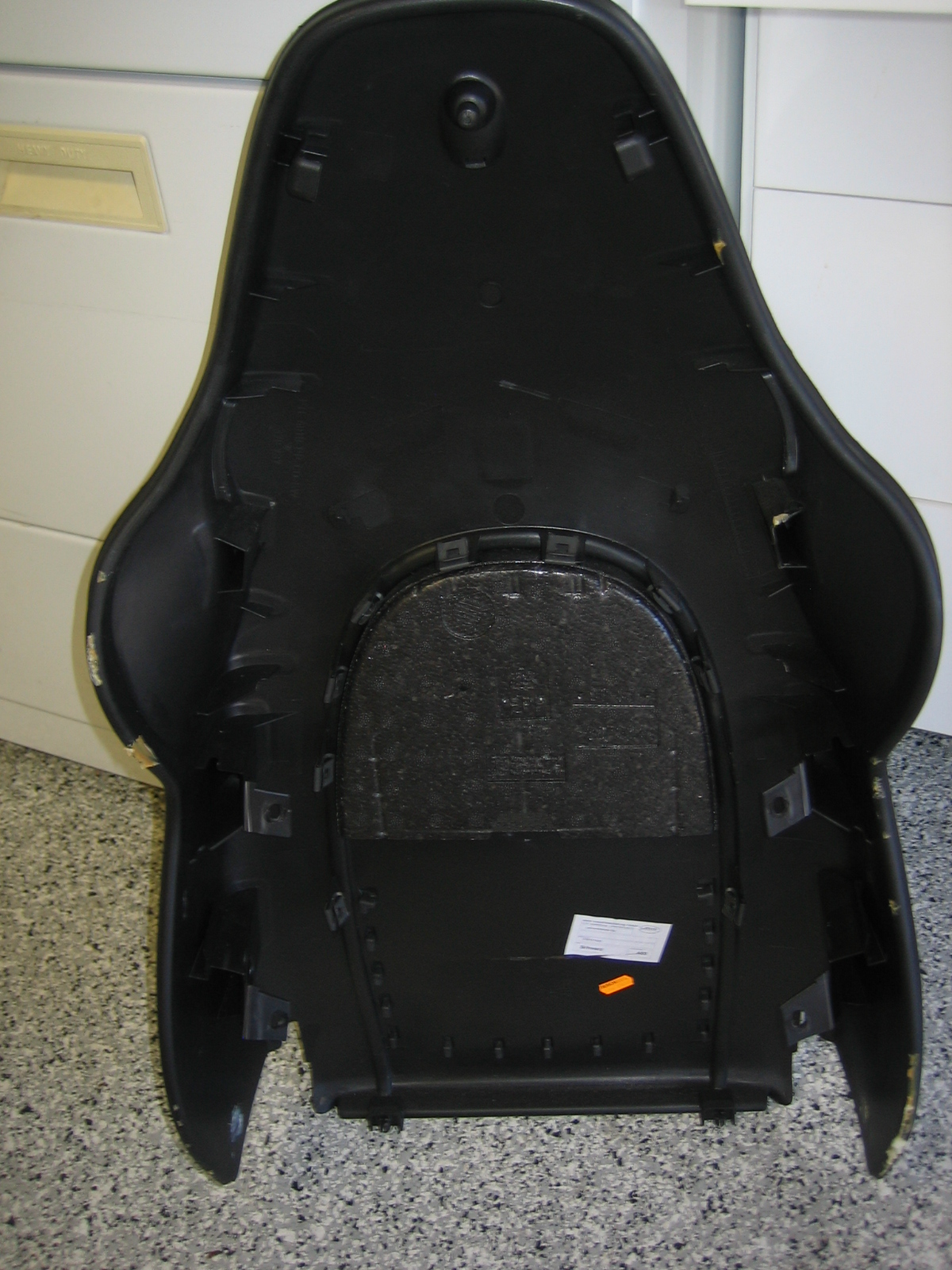

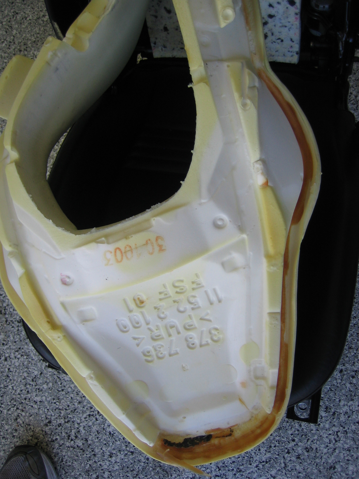

So I started the project of having my seatbacks painted today, with the removal phase!
I know there have been posts on this before so I won’t go into all the details. However, in the posts I found, there was no mention of the seat cushions being glued around the edges, presumably to keep them in place while stretching the leather. I was able to remove most of the residual, but do I need to re-glue the cushion when reinstalling? What adhesive do I use? Any recommendation is appreciated.
Also, I learned a few things along the way: I used a plastic ballpoint pen as leverage when removing the leather. I slid it carefully along the seam and it helped tremendously with the removal process. I also took some pictures of how the electrical plug disconnects.

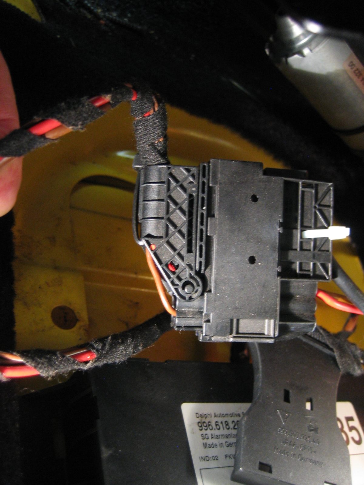

Electrical Plug

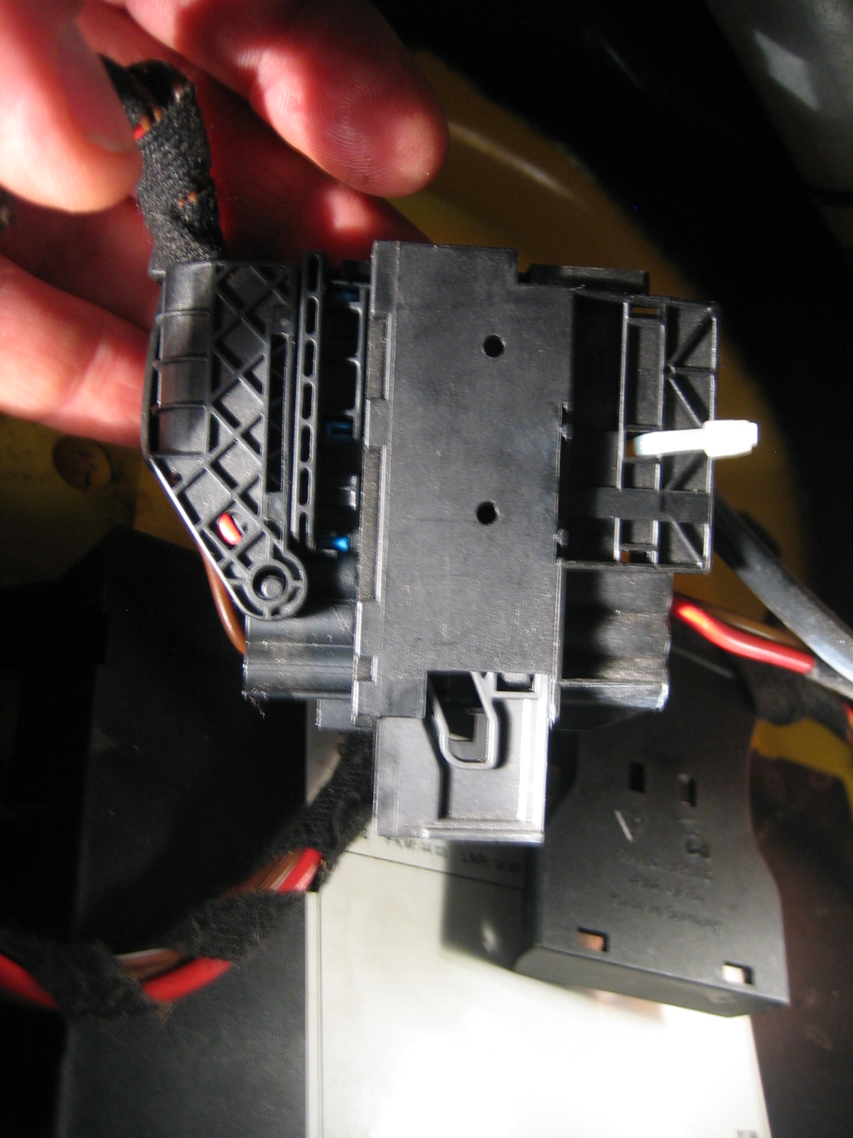

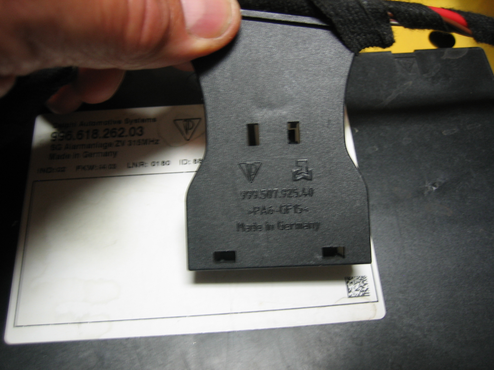

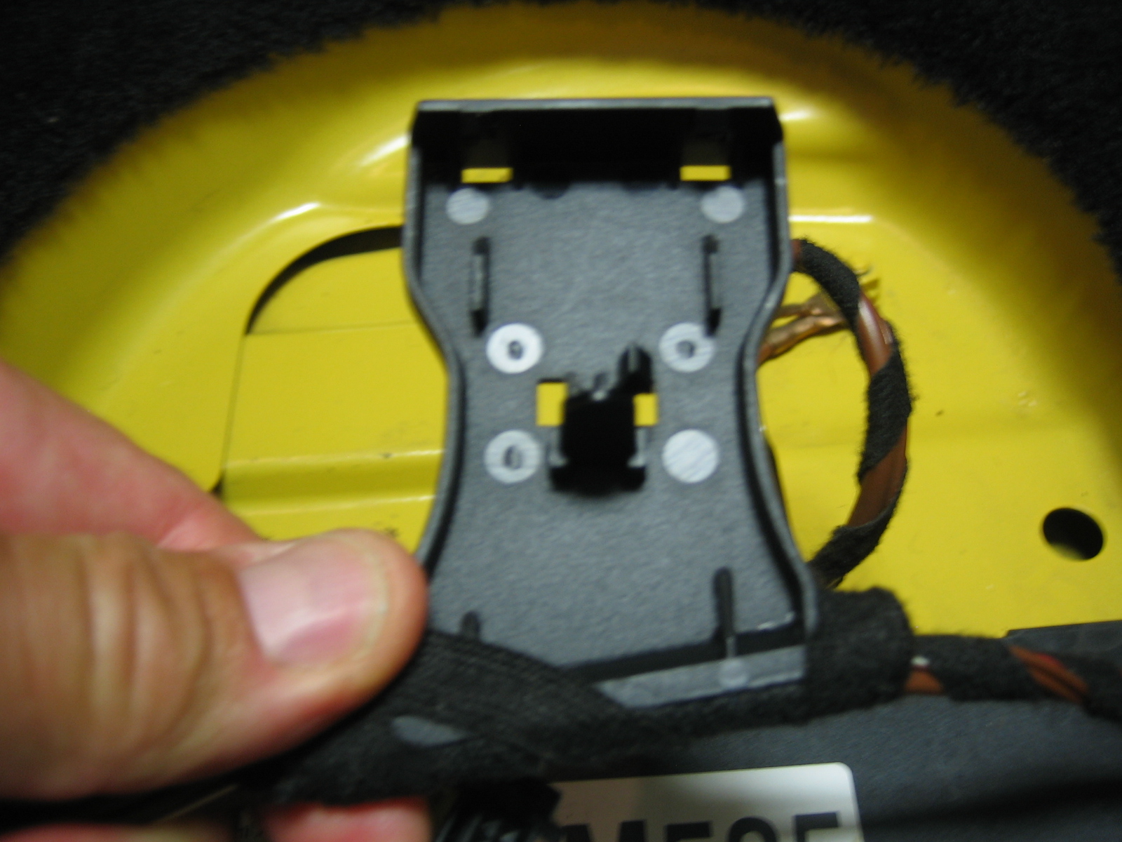

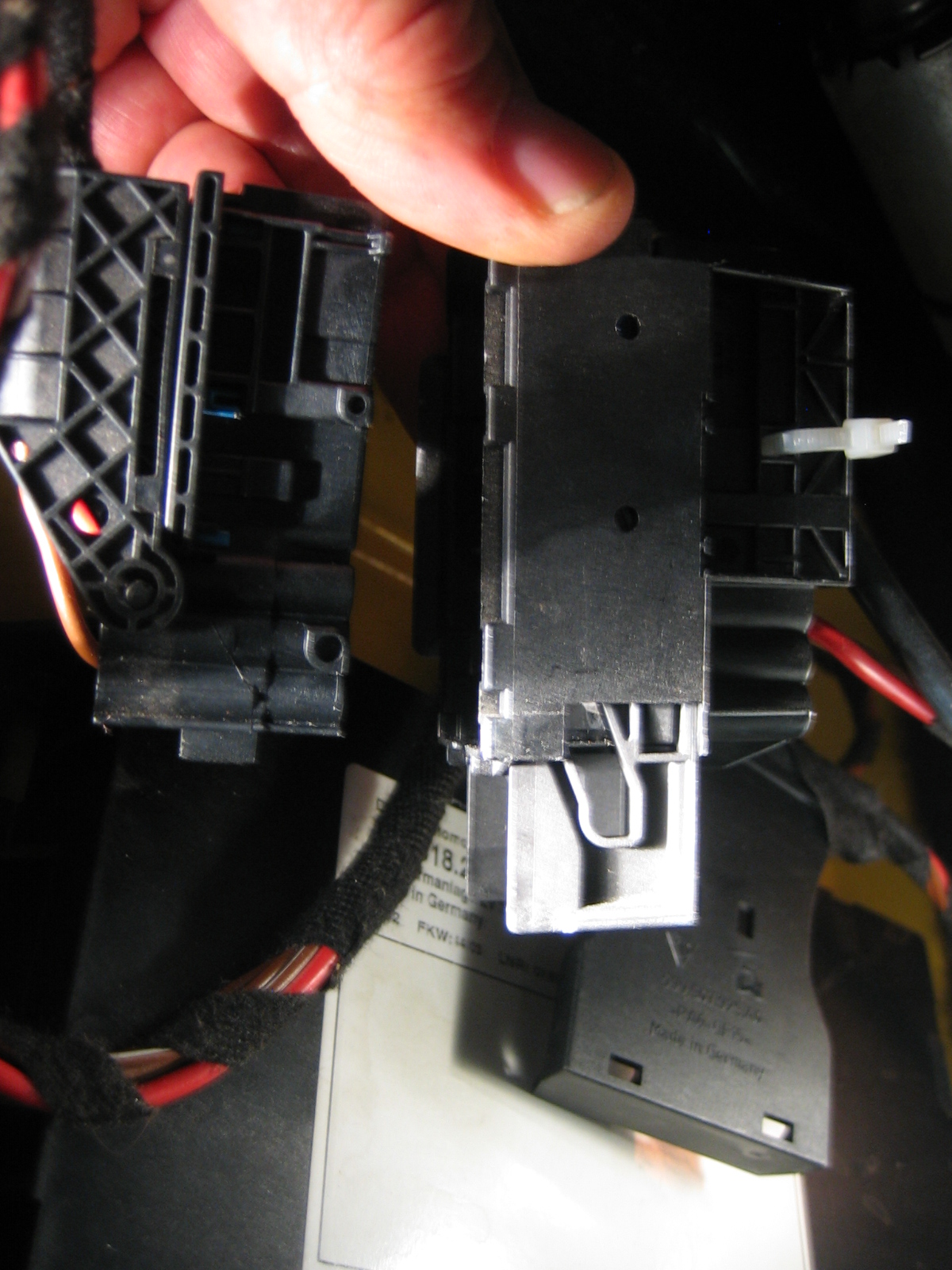

Fixing clip for wiring harness
Under the driver's seat I found this piece, "Fixing clip for wiring harness" per the part number, attached to the wiring harness. I can't figure out where it is supposed to be attached. Mine apparently became dislodged because the "push clip" is broken off the back. Any ideas?

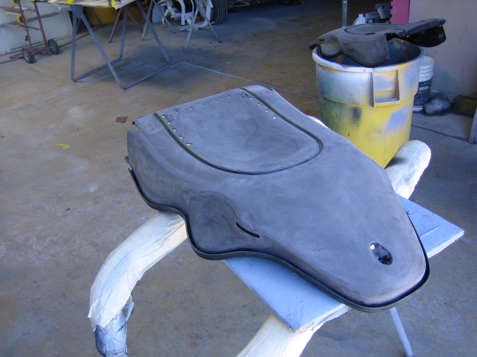

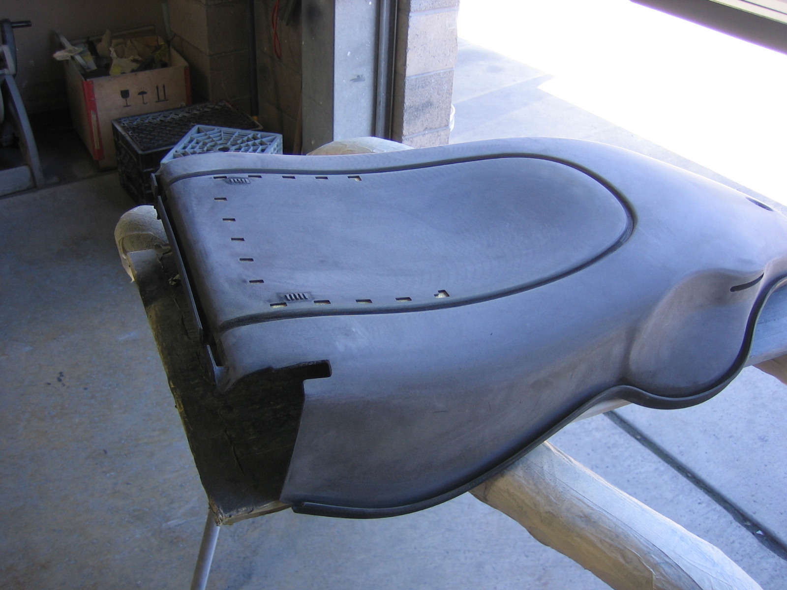

Really? Everyone stumped by the previous question?

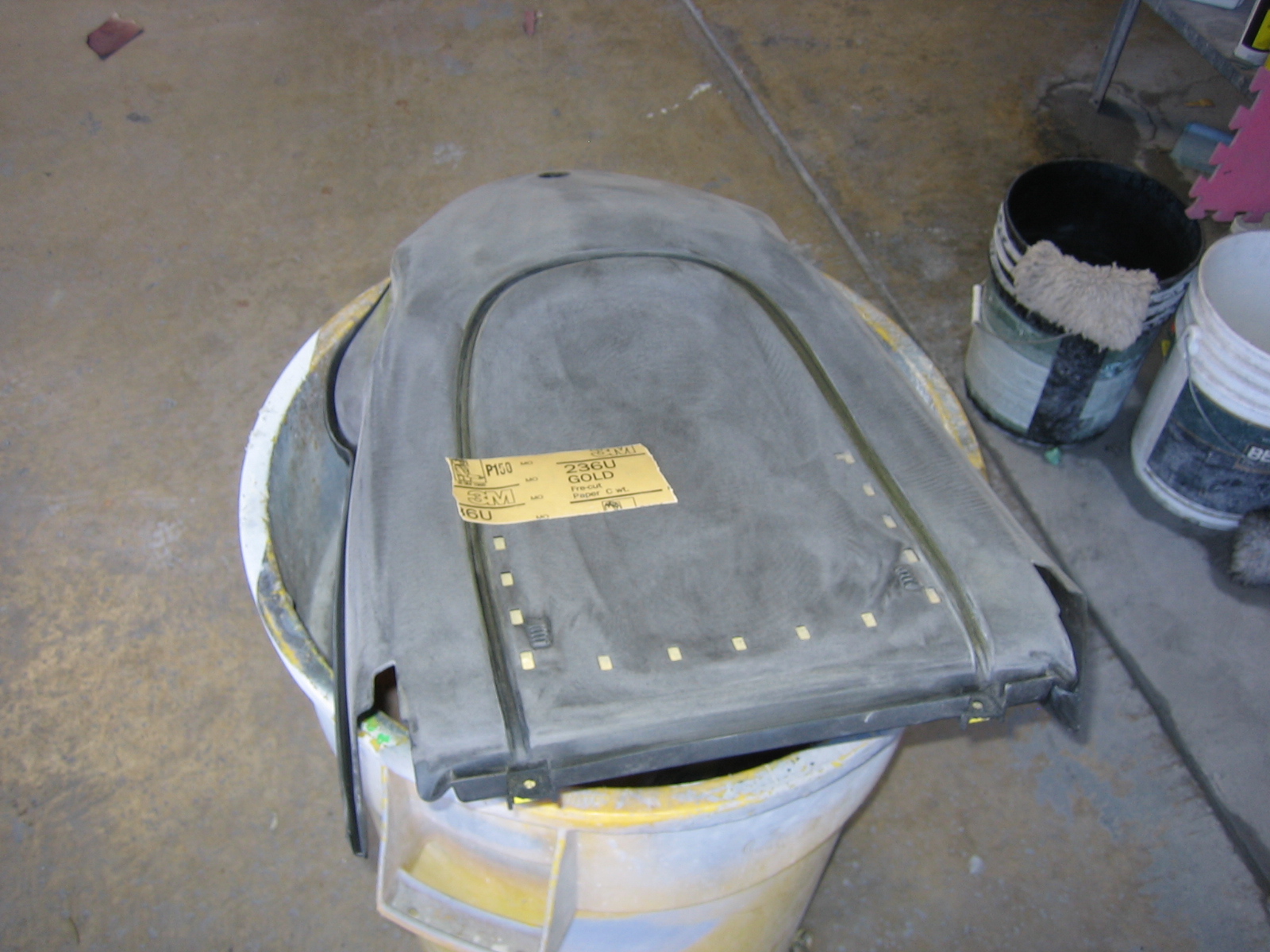

Seatbacks being prepped at the paint shop!

Does the passenger seat not have the same clip?
Can't wait to see how this works out for you.
No such clip on the pass side.

No luck in my search for your the clip under the seat. I had all four bolts removed that hold the seat and was able to move it backward and take a good look under but nothing similar It was a good time to do a clean-up and lubricate all the gears at the same time.
Thanks a bunch for checking JP!
I wouldn't sweat it, bud. That clip just does what it says, keeps the harness plug in place. Nothing a little creative zip-tying can't accomplish, and do so far better.
While you're in there, I'd recommend grabbing up the SmartTop and RemoteTop upgrades if your interests and budget dictate. I'm very happy with mine.
Good luck!
-V
Yeah, I know! It's the OCD in me !

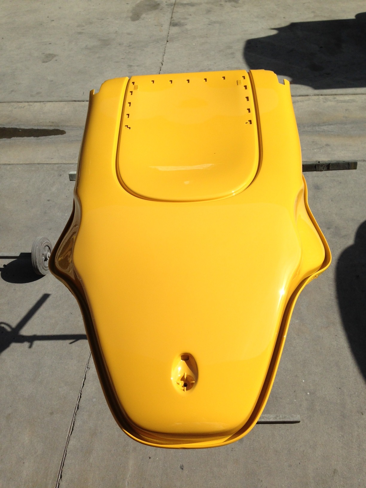

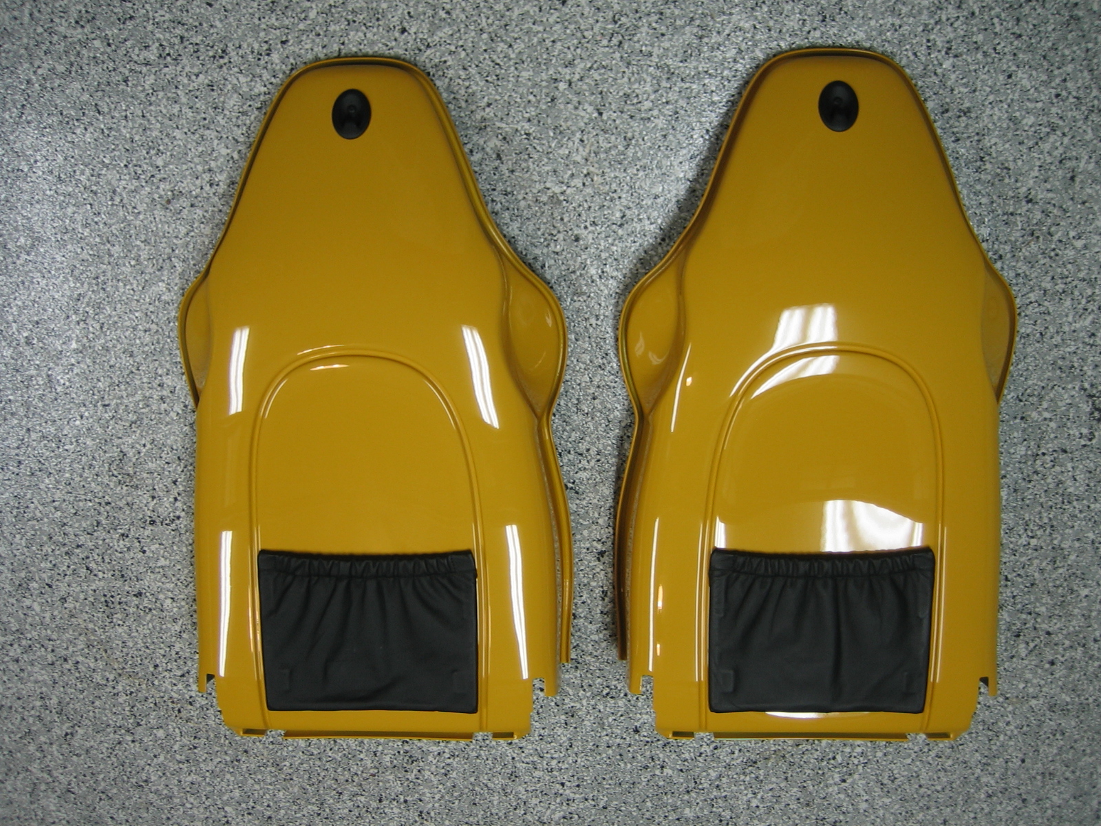

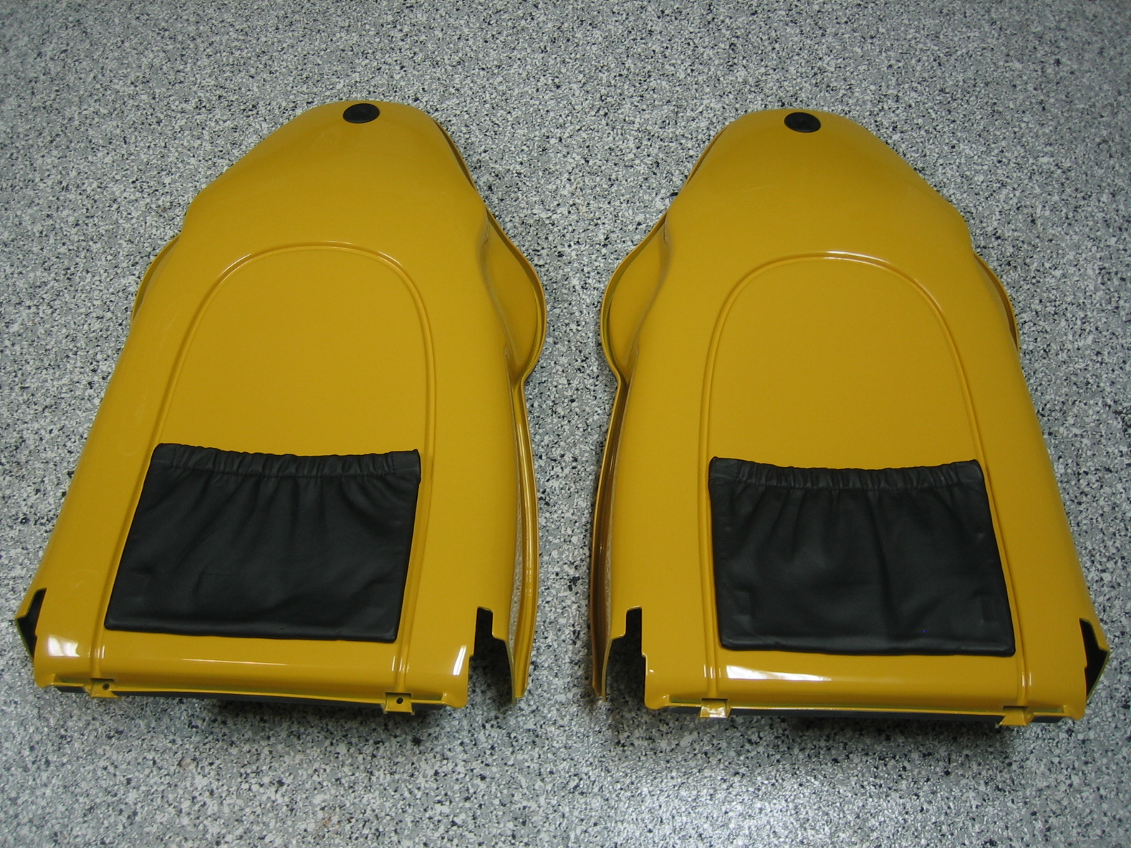

Painted and Baked!!!

Ready for install! I hope to get to it this week sometime.
