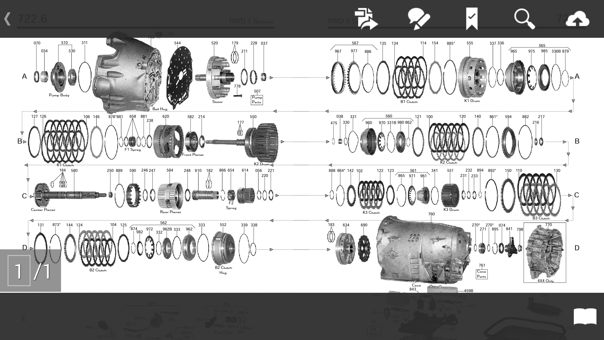

Ramman5600. I found the details that will be done to the units I have going out.
Nice, What's the cost for this? Looks like they are doing it right!
How close is the nag 1 to the turbo tiptronic? I know I've seen others get stuck trying to find some special gaskets and such. Looks like a thorough job.

pat has a reputation beyond reputepat has a reputation beyond reputepat has a reputation beyond reputepat has a reputation beyond reputepat has a reputation beyond reputepat has a reputation beyond reputepat has a reputation beyond reputepat has a reputation beyond reputepat has a reputation beyond reputepat has a reputation beyond reputepat has a reputation beyond repute
It's the same inside. The only difference is the gear ratios.

Originally Posted by pat
https://www.6speedonline.com/forums/...1-pd-code.html
I too have been on this for a while. The place I listed above says they can handle 1000 hp after there upgrade. I do not know what torque That is at. The 722.6 nag1 is in many chrisler cars and they ruteenly upgrade for drag and hotrods. They only do upgrades and then run on a dino. The price is reasonable. I have my 2 spairs going to them . And should be back on line in the spring.
