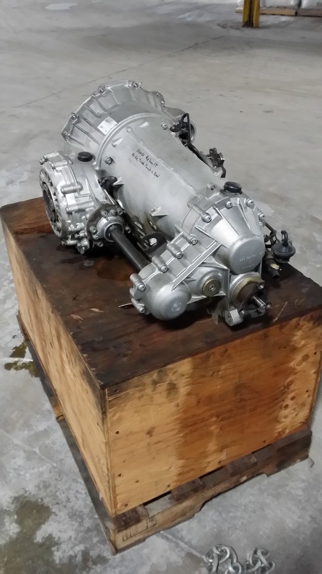

I would be nice to have the tip controlled more quickly from input. I have my two extras going out for upgrades. The gears get nitrogen diped. Mod to the k3 basket. Blue top pressure . New all other stuff gaskets pump vines and plates. It gets run on a dino then ships back. And an upgrade ed torque converter.
