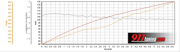

injectors, tune, intercoolers, and k16 billets... done deal..
here is my client running a record 60 to 130 on this set up....
best
markski
2001 996TT 3.6L and stock ECU
9.66
seconds @ 147.76 mph 1/4 mile
click to view
