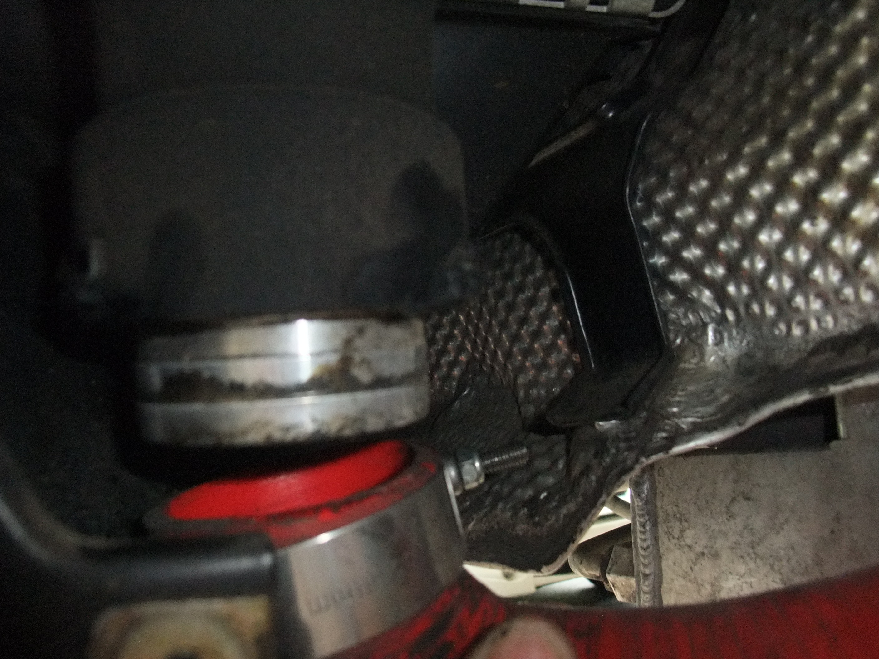

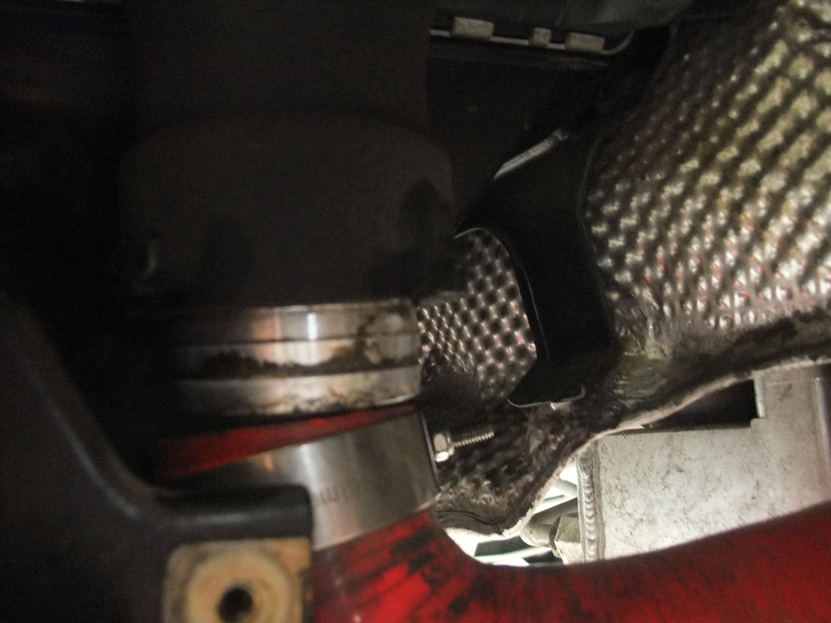

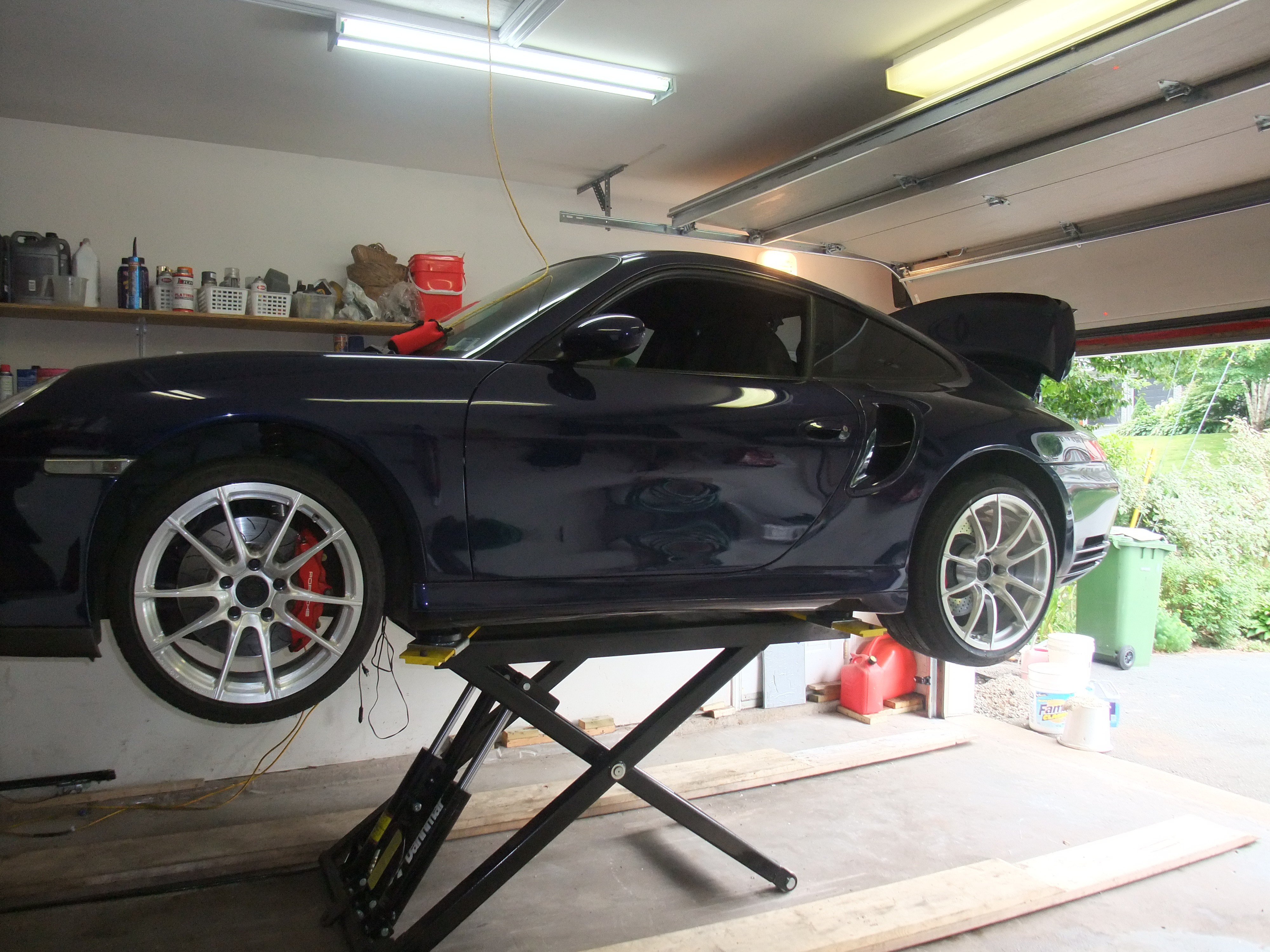

Went back at car today and started over- removed wheels and fender liners to get better look at turbo hoses . Found right boost hose off the intercoler--success!! removed the hose cleaned the inside and the nipple on the intercoler with brake clean . Re-installed it and tightened all clamps
Road tested and all is good .
Proves that sometimes I have to stand back and think longer !! Can't rush repairs.
Attached are photos of boost hose off; completed repair and after road test .
Thanks for the input from all of you .
Have a great day
Wayne
