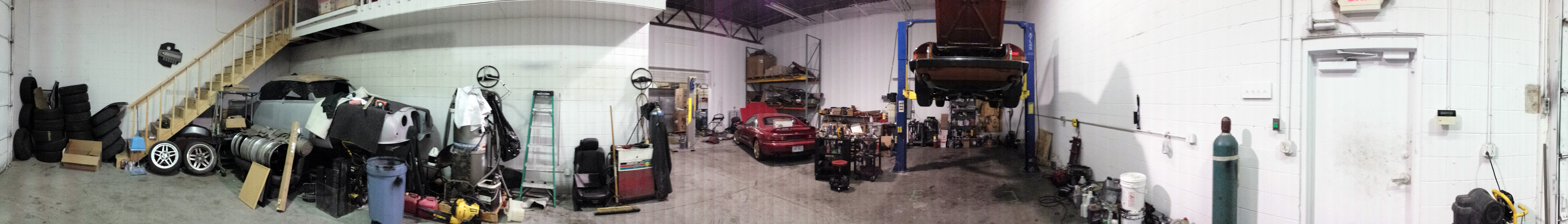

I got OEM Sachs kit, it is all German and runs $705 delivered. Since I am somewhat around stock performance, I see no need in fancy clutch upgrades.
I also got new front strut plates and bearings (unrelated).
$1500 perhaps too brave of an estimate, but $2K should work, with all the little things to address.
