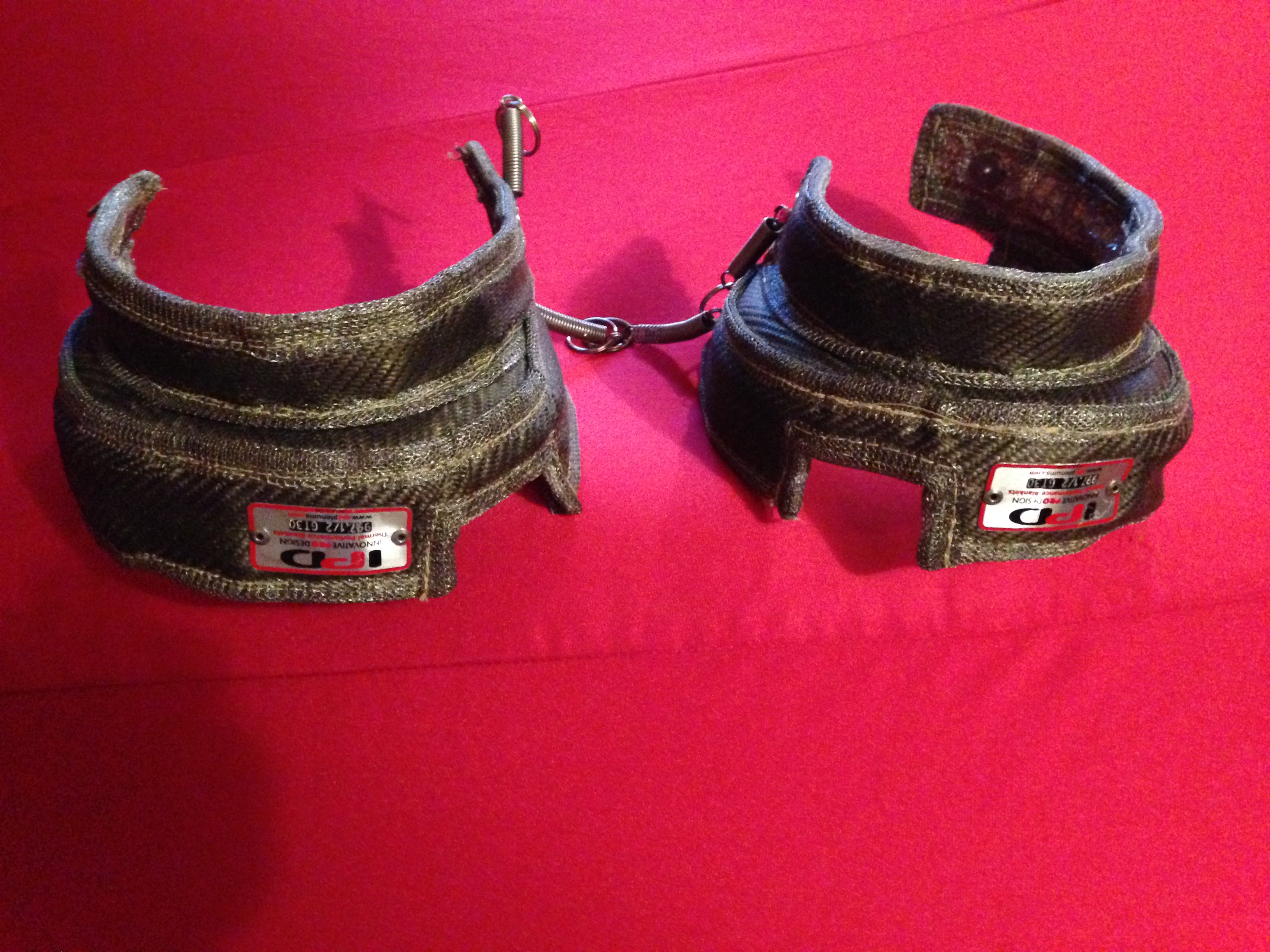

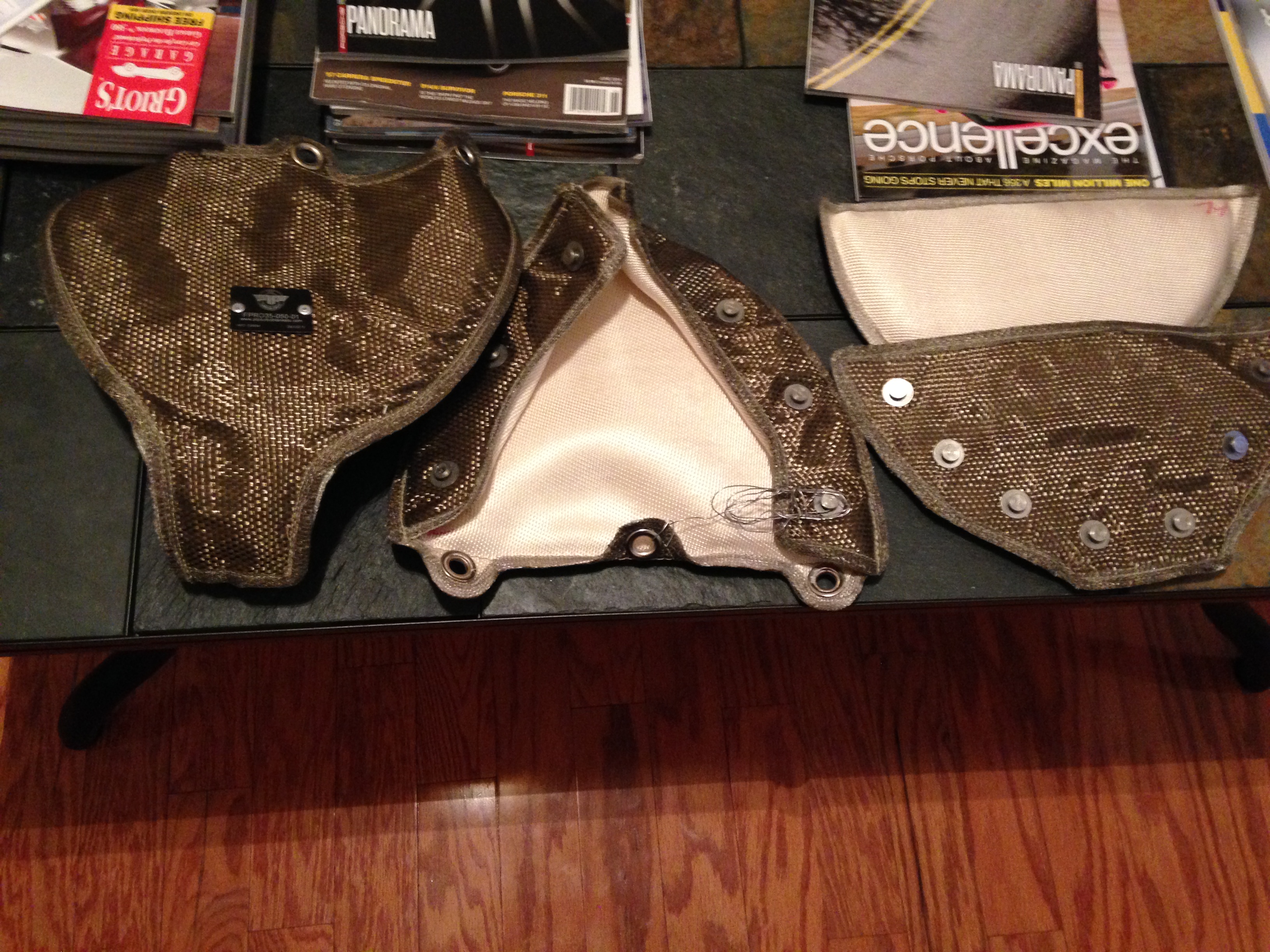

i actually have a set of header blankets for the turbo. made by PTP and i was going to use them on my set but since i went with external waste gates I'm not sure they will fit. i have them for sale but if they aren't sold by the time i pull the motor for internals I'm going to try to install them and see how they would fit with my w/g
some ipd turbo blankets as well for my 3071 turbos
