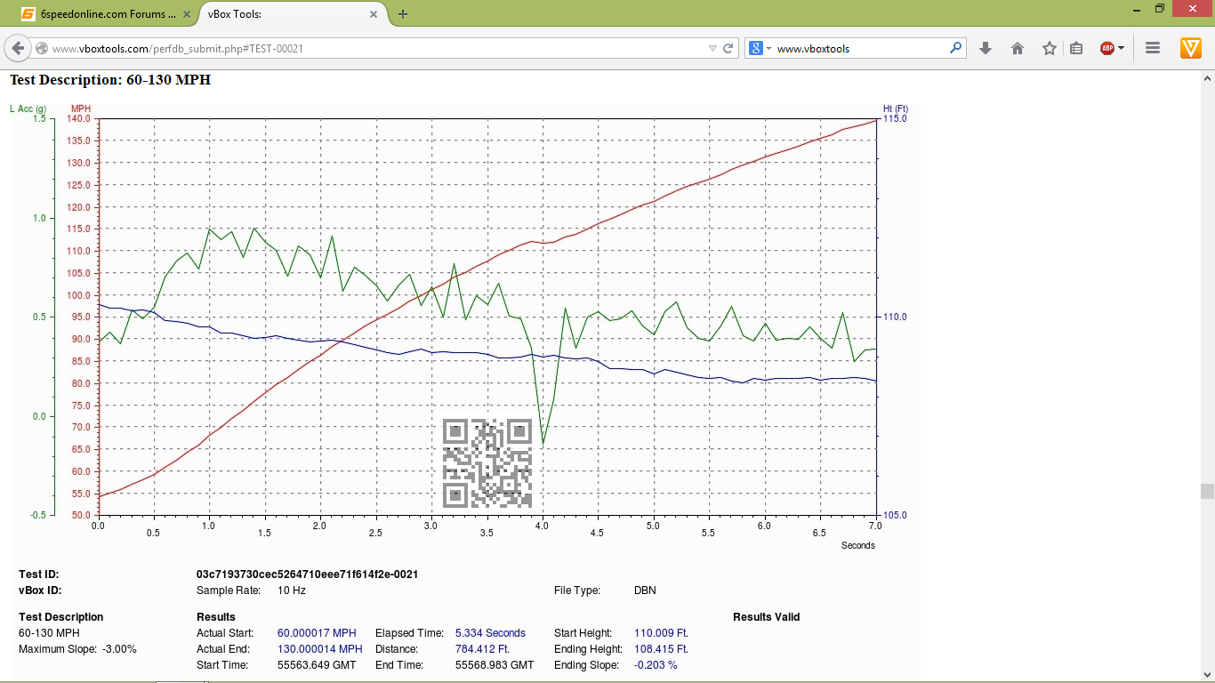

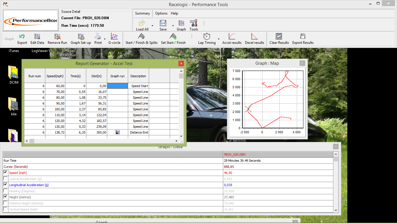

Update new 60-130
yesterday adjusting my plug to 0.23 before 0.25 so no more missfire, then fixed a huge leak in driver IC's unclipped (these freakin thing always unclipping so i jbwelded)
Now this morning outside temp was low 60 deg perfect to perform new test and i was shock to my vbox result!
60-100 in 2.37sec
60-130 in 5.33sec

Mike that is just awesome.... 2.37 secs 60-100 in 3rd is really scooting along,
so off the Vbox acceleration in long g and speed at 104 mph it is about 800 crank hp or so, does that sound correct ?

thx man! never dynoed my car but you got a quite good idea of it!
this week i will go for secondary meth injector to richen up my a/f and bring down my iat a bit!i bet i can bring that set up 5sec flat very soon with some huge IC's

You do NOT need a dyno to get crank hp numbers... if you have a VBOX
Do your normal WOT 3rd-4th gear runs like on a 60-130 mph dig.
Save the VBOX file and run thru' vbox verify like you did
Then look at the peaks of longitudinal acceleration at a specific speed.. say at around the peak between 90-105 mph in 3rd gear or the the 4th gear peak near 130 mph or so. Using your 4th gear g peak at about 129 mph
on your run above we get
Vbox 845 brake hp
0.58 Longitudinal g
129 mph
3700 weight (My guess for your loaded weight lbs)
0.003054 mulitplier
awhp = 676 [bhp * 80%]
I find with my car, this method gives presciently accurate reads

So the formula BHP = Long G's * weight of car * Speed (mph at Long G) * 0.003054

You did those times on the flat
Also, shift 3rd to 4th a bit earlier at peak (g) which seems to be about 102-105 mph and get a 3% downslope and you will be very near 5.0 secs
