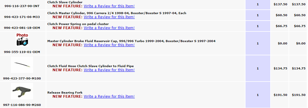

This is what I bought from Pelican parts and everything dropped into place...
Item Part Number Qty Description
1 996-116-237-90-INT 1 Clutch Slave Cylinder
2 996-355-119-01-OEM 1 Master Cylinder Brake Fluid Reservoir Cap, 996/996 Turbo 1999-2004, Boxster/Boxster S 1997-2004
3 996-423-081-18-OEM 1 Clutch Power Spring on pedal cluster
4 996-423-171-06-M33 1 Clutch Master Cylinder, 996 Carrera 2/4 1998-04, Boxster/Boxster S 1997-04, Each
5 996-423-377-90-M100 1 Clutch Fluid Hose Clutch Slave Cylinder to Fluid Pipe
6 997-116-086-90-M260 1 Release Bearing Fork

It was $600 exactly for what I listed above. There will be some fluids to replace in there as well. For labour - that totally depends on who does it. I would expect 6 hours from someone who knows what they are doing. (Longer or shorter if they don't)

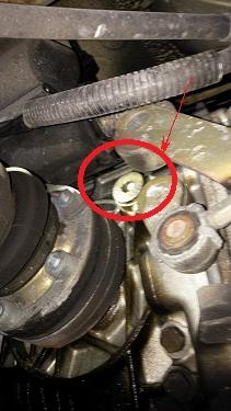

Also now I remember when I posted something on here about the leak--- I still have picture: Name:  MLI8Pyp.jpg
Size:  17.6 KB I thought it was leaking from that bolt, or axle/seal but i think it was from slave. It stopped. It got dry, i never bothered, after changing the clutch to aftermarket one, it started to **** me off with the take-offs- where clutch is soft when car warms up and grabs up top, I drove many cars and owned cars with aftermarket clutch. everything else seems fine and i dont see any leaks from reservoir or level changing...
