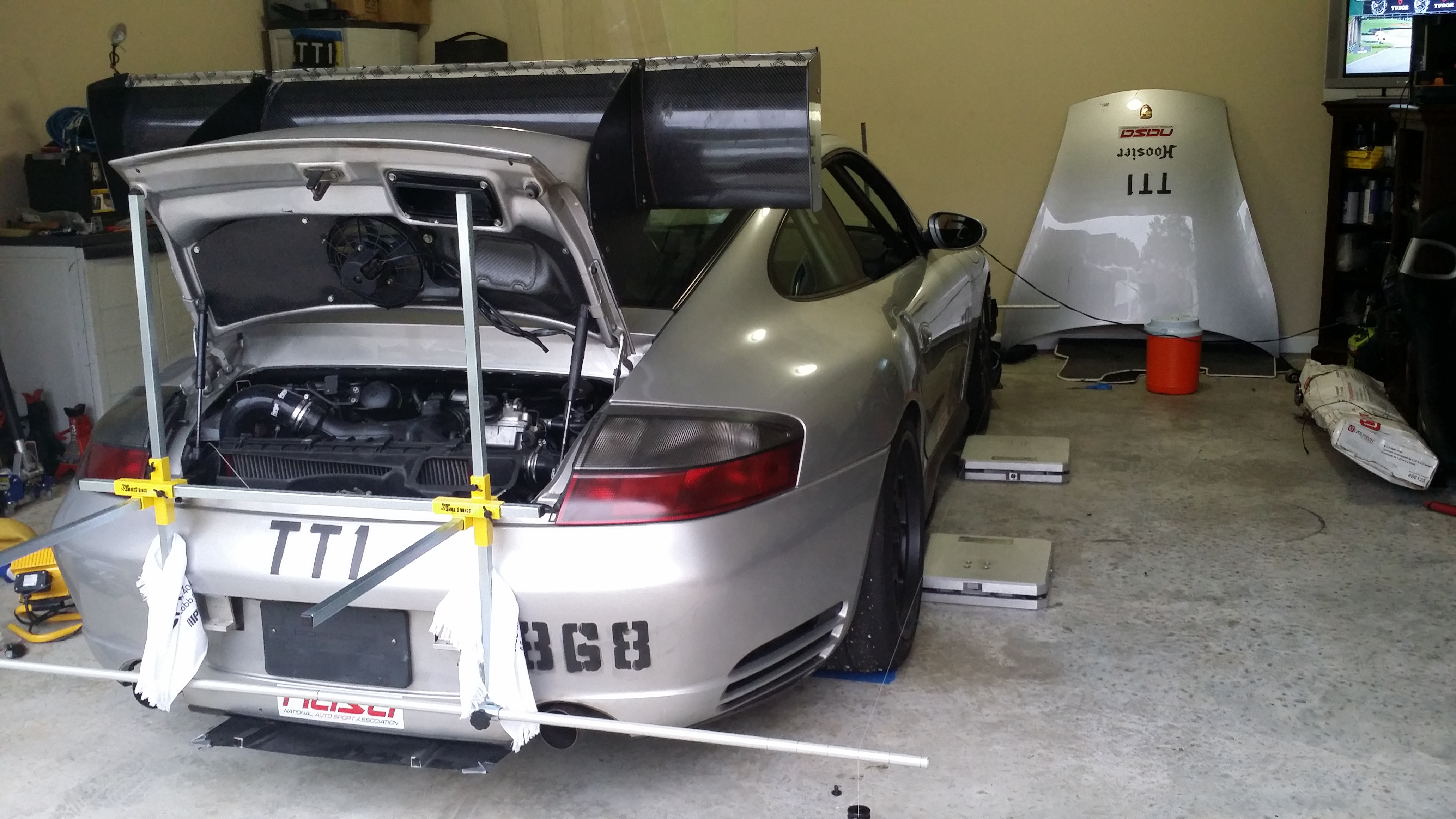

This is the best one I have on my phone. You can see that the current tire tread is actually a bit smaller than the wheel. I have an inch to the outside. So assuming 1/2 inch out and 1/2 inch in I should be good. Only problem could be the lower inside end by boost hoses. I'll try and get a pic of that later.

I'll only add the spacer if needed. I'm think if the boost hoses are an issue to use the spacer to push tire out and shim to add negative camber and gain space back up top. It's doable. Just have to find the right combo. Going to buy a cheap used tire to try fitment.
