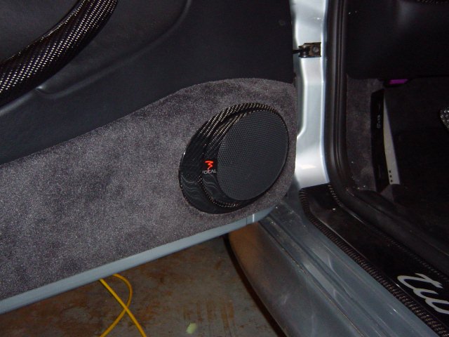

Go for the Focal Utopia's!

MUST GET THOSE SPEAKER GRILLS!!
Spill it!!! Where did you get um?? or were they custom??
Evan
Evan
They put Focal's stickers on the grills
but this box is customs

Do you have to upgrade the electronics or can the existing unit drive the speakers decently? My quick lookwas that the speakers were the weak link. The CF speaker mounts look niiiize! Is that a stock part?

Im changing the whole thing, nothing stock's on the audio sytem... but the CF parts are all stock in these pics
Im putting the new Pioneer 7500 (touch screen) with NAVi head-unit
Wait so the CF on the grills is a sticker?? Looks damn good!!
Evan
I think EM is saying that the Focal logo is the sticker. Porsche does make the grills in CF.
