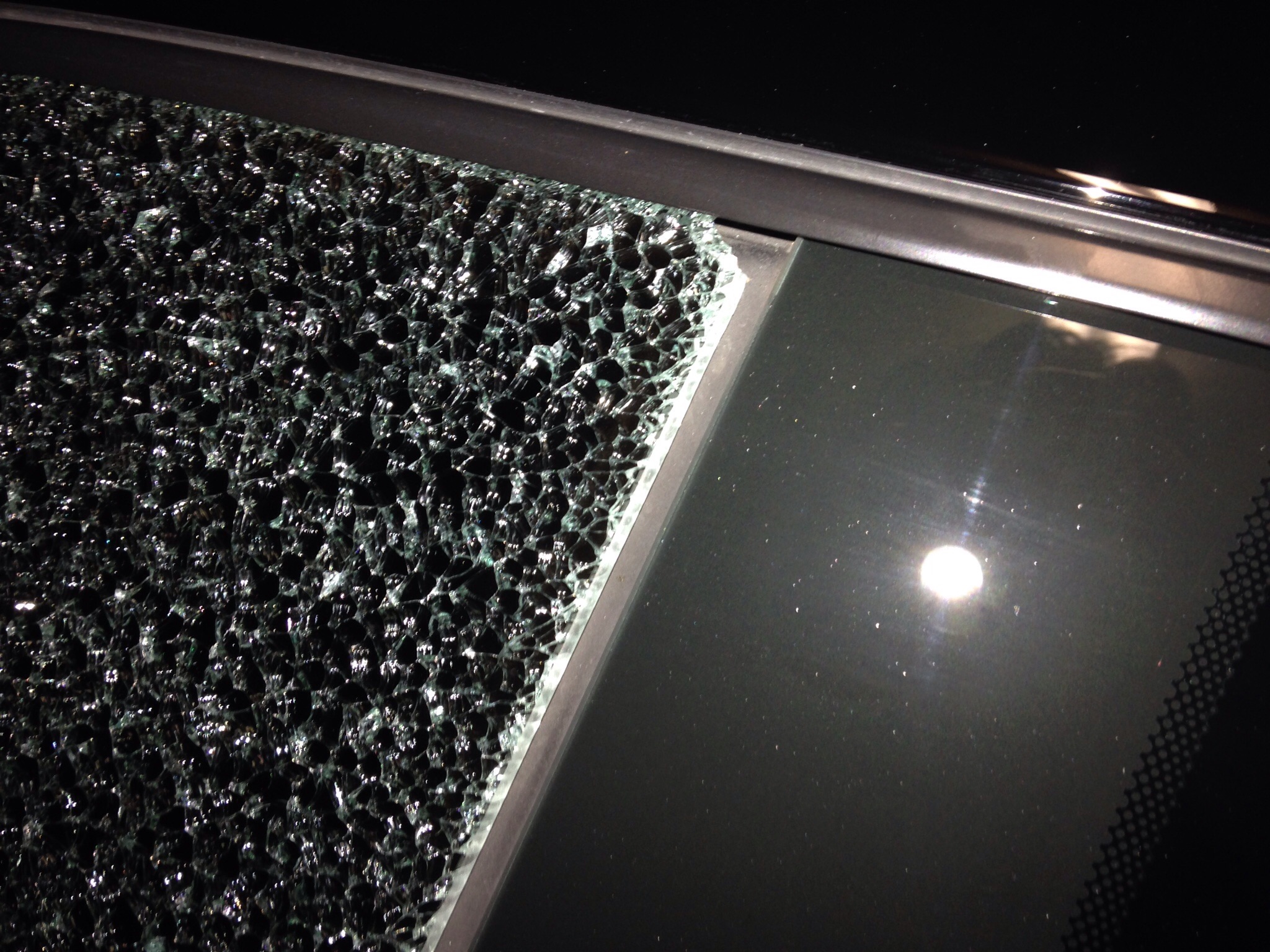

Regarding broken tempered glass, this usually happens at a pre existing defect along the polished edge. Usually takes some type of stress to cause breakage. Uneven heat on glass is one example, excess tension at the defect location is another. A trained eye can sift through the broken pieces, find the origin of the break, determine the cause. The sunroof example may be due to nickel inclusion in the glass, which expands far more than glass when heated up, causing the tensile break, or spontaneous breakage.

Stress may have started at the top right/back of window.

Urso, I work for a top 3 global glass company, at the tech center. I'll ask an expert to look at the picture.

I really appreciate that. Let me know if you need more pictures.
