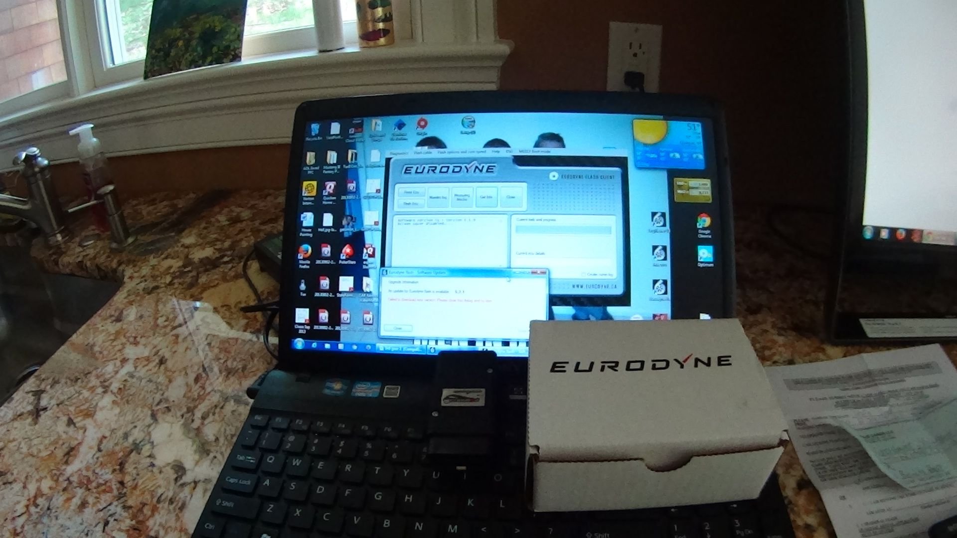

Stage 1 - I bought Eurodyne software ($1500 from Chris Tapp in Canada, but Tim941NYC is a USA dealer, great product, really great) and logged the existing tune which was a very old GIAC tune, car was very quick but needed more fuel and a new clutch. Using Eurodyne we flashed it back to stock.
2 gallons E85, 14 gallons 93 octane used on all runs here unless otherwise stated
60 to 130 mph (stock with AWE Exhaust) = 9.2 seconds (4th gear only, no slope, 65F)
60 to 130 mph (GIAC tune with AWE Exhaust) = 8.8 seconds (4th gear only, no slope, 75F)
Then I added the new Eurodyne tune and took the car to a local dyno where we managed to snap the front axles and break the front diff. When the car broke it showed 430 awhp, blessing in disguise
Eurodyne tune over the GIAC tune in AWD mode with AWE exhaust = 8.4 seconds, 85F

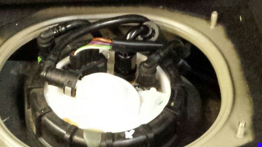

Next came the best mod IMHO, fueling, more fuel, MOAR POWER = giggity.
Tim installed a wallbro intank E85, 400 series FP, Injector Dynamics ID1000s, 6 fuel line, filter and fittings, 6 check valves etc and some new 997 Turbo coils and F5DPOR spark plugs
So with the new set up we did some 60-130 mph runs and got some nice times. This was using 3rd-4th gear rather than just 4th gear but overall my times with either are within 0.1s usually. So this is a good representation of the 1st run with the new tune and RWD with extra fueling. 7.8 seconds or adjusting for slope just under 8.0s, but this day temps were 95F on my test track.

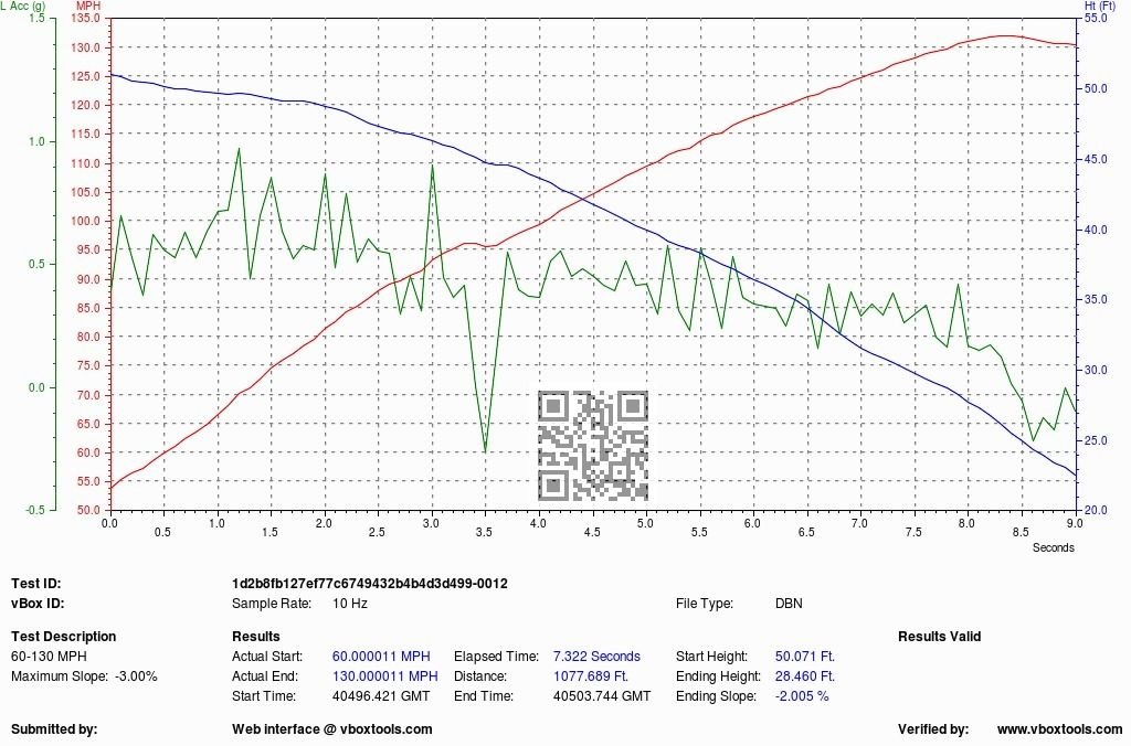

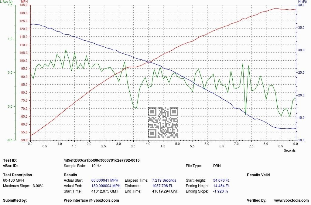

My 4th gear pulls were all now consistently 7.3 seconds to 7.8 seconds depending on slope and weather so about 0.2s slower at these power levels than the 3rd-4th with power shift.
I then cracked off some low 7.25s and 7.219 secs best official in 85F-92F temps on the -2% slope and the car consistently sat at those times all being equal.
I did find a larger slope and got a 6.989 second 60-130 mph but the vbox said unofficial because the slope was -3.19% but temps were 92F that day.
