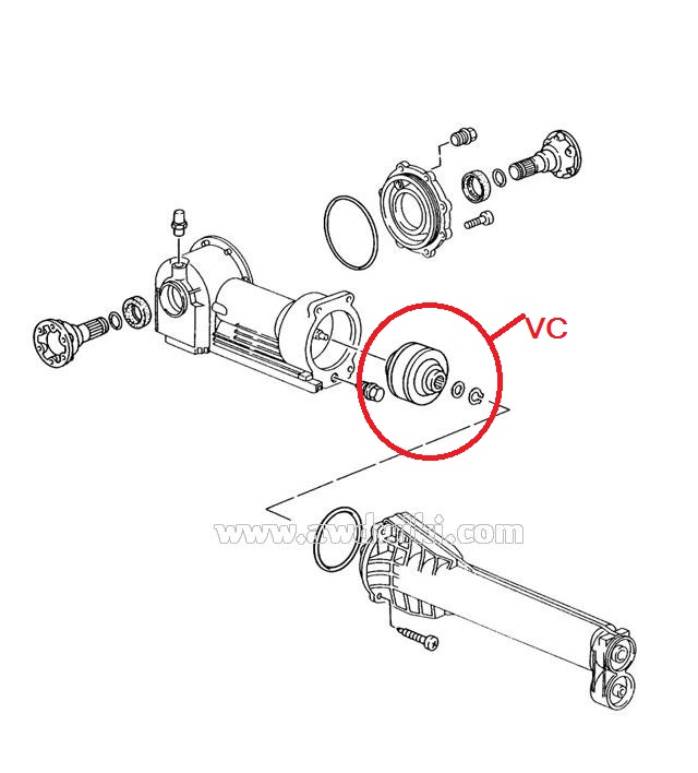

the VC/Viscous-Coupler utilises a separate-special fluid(which controls awd lock-up) held within its case, it is sealed and 'lifetime' (although the fluid fails over time/abuse)
The front differential, which houses the VC has regular gear oil in it that SHOULD be changed regularly.
