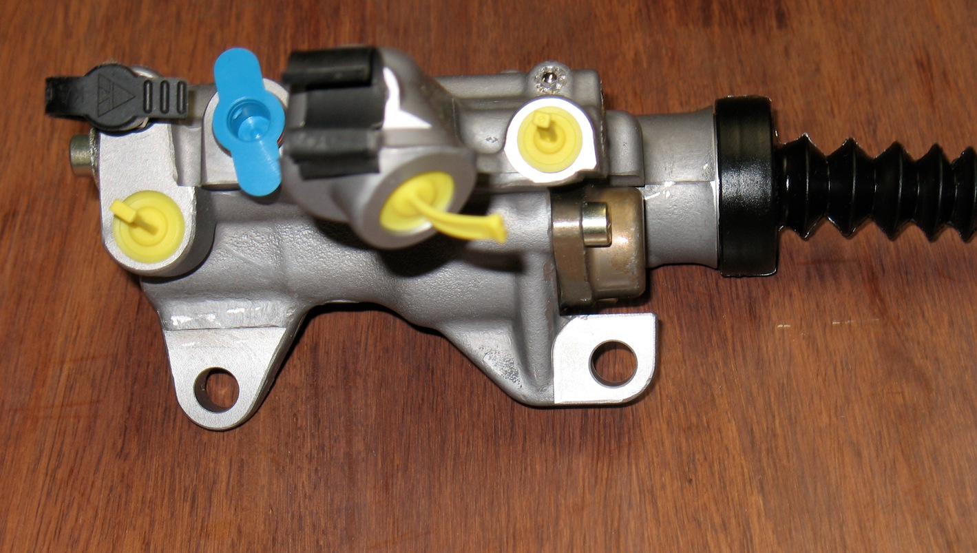

Agree with 02996ttx50. The slave should not be moving. It is held with two bolts M10 x 35. If it is moving may be the plunger (called a pushrod in the repair manual) at the end of the piston came of the fork. You better get a proper look at the slave attachment to see if one of the bolts is missing or may be one of the lugs on the slave is broken. The slave can be replaced without removing the transmission. It is about a three hours job. I did a DIY on Renntech. You can view it if you are a contributor here: http://www.renntech.org/forums/tutor...r-replacement/
Note: removal installation of the slave at page 671 of the repair manual found here: https://www.6speedonline.com/forums/...p-manuals.html
Name:	Screen Shot 2014-11-16 at 09.03.50.jpeg
