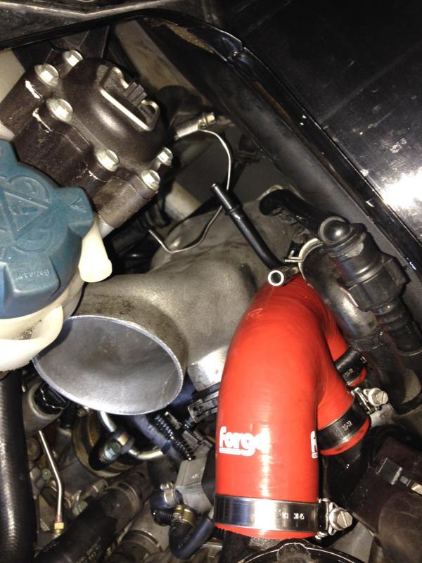

Update : Received new 72lb injector from EPL and swapped it into cylinder one. I wouldn't call it the most fun i've had on a weekend but it was close...
The stuttering is completely gone and the car is back to running CEL free and smooth. While I was in there, i replaced the fuel filter so there is a possibility it was that as well, though the one that was removed didn't look awful.
The install wasn't GODAWFUL, but it wasn't fun either. There isn't that much to remove, it's just a PITA to remove each piece.
I am only hitting 1 bar (tune should show 1.4) so I believe I still have a boost leak, hopefully from the intercooler hoses from when I swapped all the coil packs around, but luckily I have new forged boost hoses to install this weekend so hopefully that should do it and I can move on with my life.
I"ll keep everyone posted once I get the new hoses on, hopefully that's it and not the gasket behind the plenum. Thanks to everyone who chimed in on this project and helped me out.

I will say that the 1" or so vacuum line is connected to the plenum (coming out the right side of it) was a bear to get back on the plenum 100%. it's maybe on there 50% but not going anywhere and the clamp is on tight.

Glad you have it figured out! Modern injector issues are pretty damn rare, any diagnosis of why injector isn't good? Foreign matter, burnt solenoid, etc?
