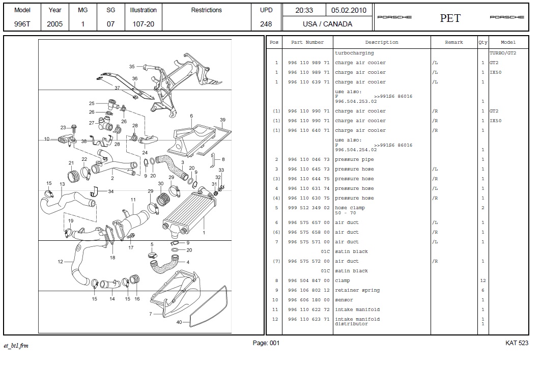

The 12 inch rear matters on ride height and tire size. If you are on stock suspension and stock recommended tire size then there shouldn't be any issues.
With the gt2 the intercooler bracket is different then a 996tt, which means there is more room behind the fender to modify.
I am on JRZ coilovers and a fatter tire in the rear on 19x12 inch rears, I had to modify wheel fender liner, I melted it and molded it back also punched holes in it and pulled it back with zip ties. Overall it changes from case to case.
are you seeing different part #? I only see a single part # for the bracjket no specification as to gt2 or turbo
I forget which part exactly, but pretty sure the metal bars behind. Might be rs.

I just remember looking into buying the brackets for when we were running into fitment issues. At that point I jjst raised rear ride hide and modified the liner and didn't need it.

brackets...see #36 for GT2 vs TT

The bracket is #36 in my pics above, replaces the TT bracket and pulls the inner fender liner closer in.

So I assume an S or X50 car have the GT2 intercoolers bracket.

No. That is a false assumption. Only GT2 has the shorter bracket. The reason that the shorter bracket creates slightly more room is that is attaches the liner on the side instead of down by the IC hose. Here is a picture of the GT2 brackets on my car. The TT and GT2 fender liners are the same except there is a hole drilled in the side of the TT liner to accommodate the GT2 bracket. The part #36 that Rob mentions above is correct. It is a direct bolt on to the TT. If I recall, the brackets are about $70 each.
As far as rubbing, I run large rear tires (305/30/19 and 315/35/18) both of which are 26.3 and 26.4" tall, which is almost 1" taller than GT2 sizes. I run 19x12 and 18x12 wheel of ET40 offset. Fenders came rolled from RUF. Camber is -2.4. I have no rubbing whatsoever and I am running at a ride height of 96/120 (about 1/2" lower than GT2 height) on JRZ Pro shocks with fairly stiff springs. I can get away with this since motorsport shocks have a much shorter stroke than a street shock. I doubt this set up would work with street springs and shocks as you would probably be rubbing at the top of the fender liner under heavy compression due to the larger diameter tire. My tires tuck under the fenders slightly at static ride height.
