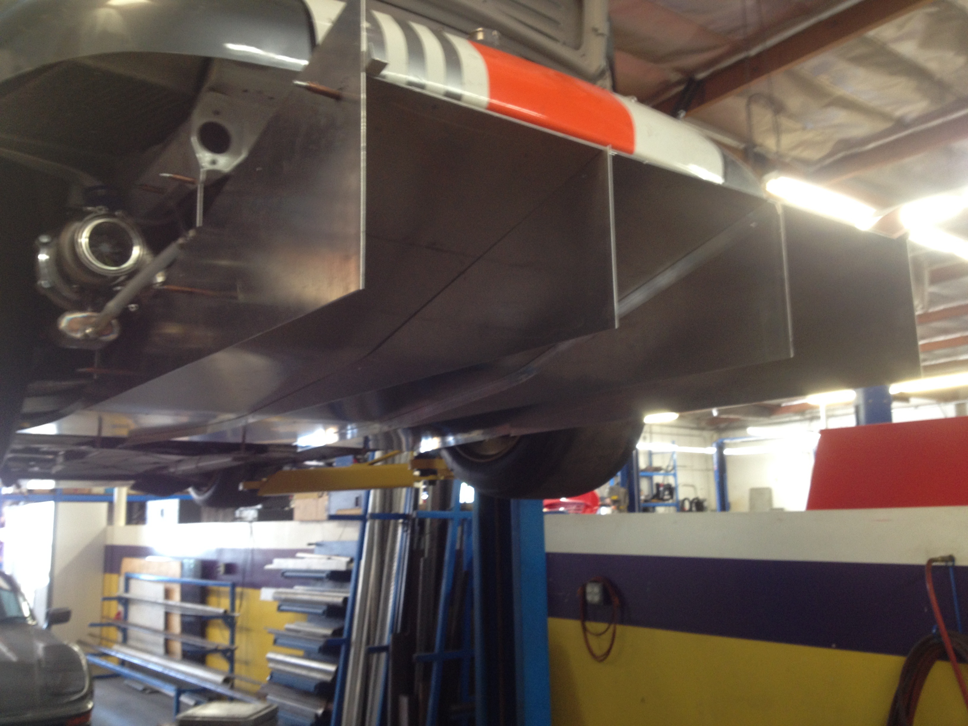

do you find it difficult to design a "massive rear diffuser" with the 911's characteristic rear engine? I always thought that was the reason for the disproportionately huge rear wing elements on these cars when you compare it to say, a 458 challenge car, with only a small gurney flap on the rear deck and all the aero beneath the car. guess I need to google up some pictures of the bottom of an RSR!
Old Dec 23, 2014 | 11:01 AM
Zuluracerx's Avatar
Joined: Jan 2006
Posts: 588
From: Newport Beach, CA
Rep Power: 61
Zuluracerx has a brilliant futureZuluracerx has a brilliant futureZuluracerx has a brilliant futureZuluracerx has a brilliant futureZuluracerx has a brilliant futureZuluracerx has a brilliant futureZuluracerx has a brilliant futureZuluracerx has a brilliant futureZuluracerx has a brilliant futureZuluracerx has a brilliant futureZuluracerx has a brilliant future
Of course it's difficult - and expensive! We have no rules to follow in GT1 (no aero restrictions, pesky hp to weight rules, etc.) As such our goal is to build a dominating car with lots of df. It will be closer to a DTM car than your normal 911. See pics below of diffuser mock up (rough and oversized in aluminum) and the the resulting mold ready to create the actual carbon center piece. There are also individual side sections that form a floor under the turbos. That's all I want to say at this point, as we are building this thing to win after all and I don't want to reveal ALL the secrets lol

thanks for the pictures! your secret is safe with me.
with the turbos to consider during placement, that thing looks like it sits LOW. A consumable item in the long run? ;-)
Old Dec 23, 2014 | 11:51 AM
Zuluracerx's Avatar
Joined: Jan 2006
Posts: 588
Rep Power: 61
Consumable in the short run hence the mold process

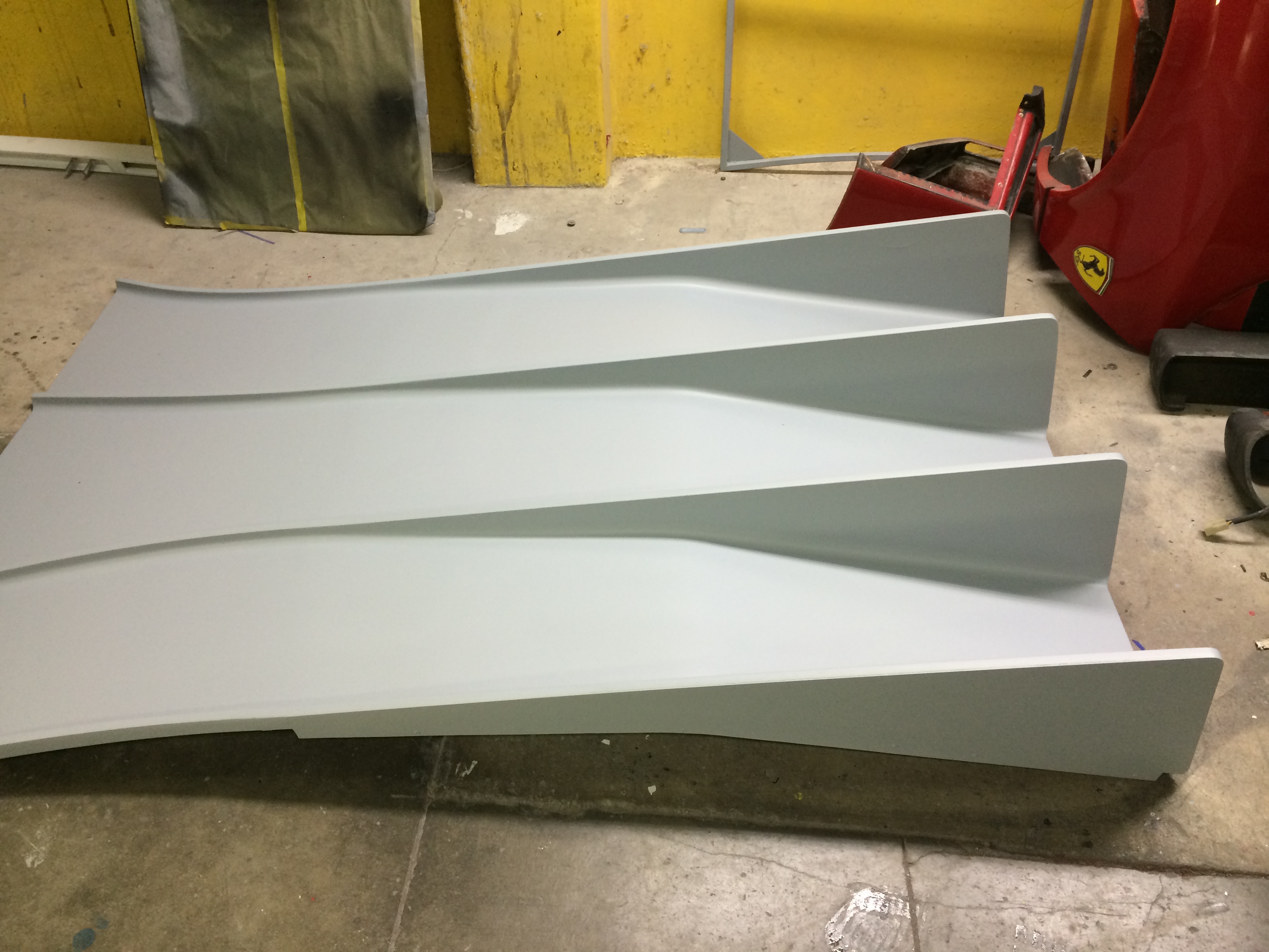

New (slightly larger) wing for the racer project. Bottom pic shows it relative to a stock GT3 RS wing.
Nice. Looks like a Getty wing with a 63" blade.

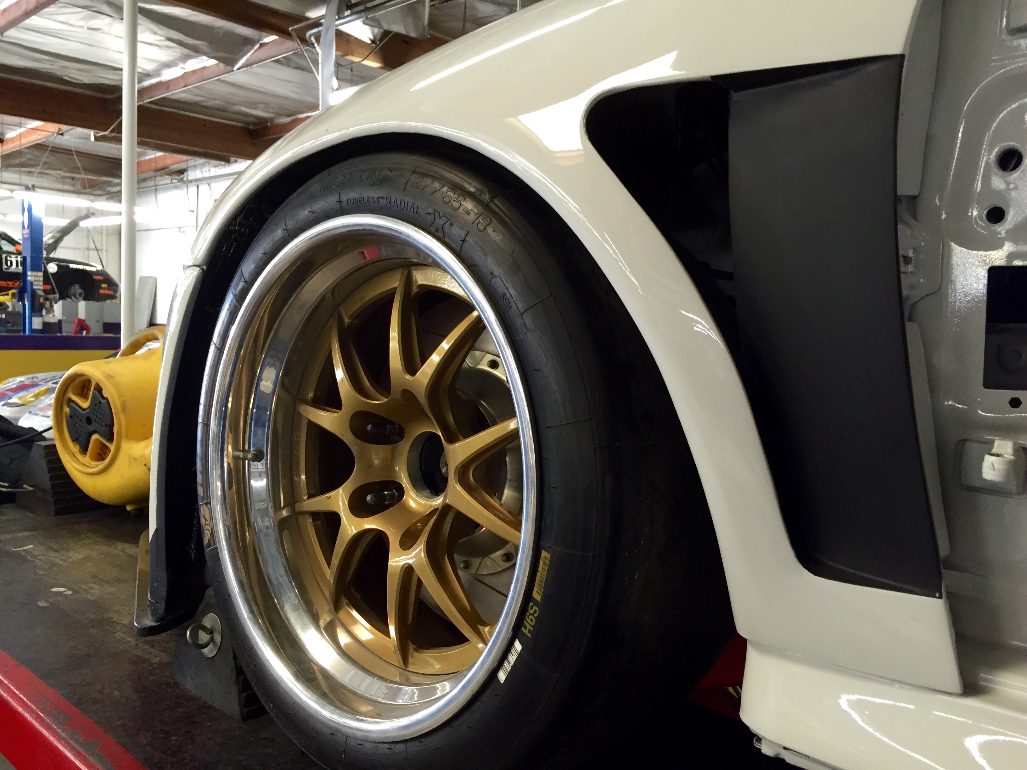

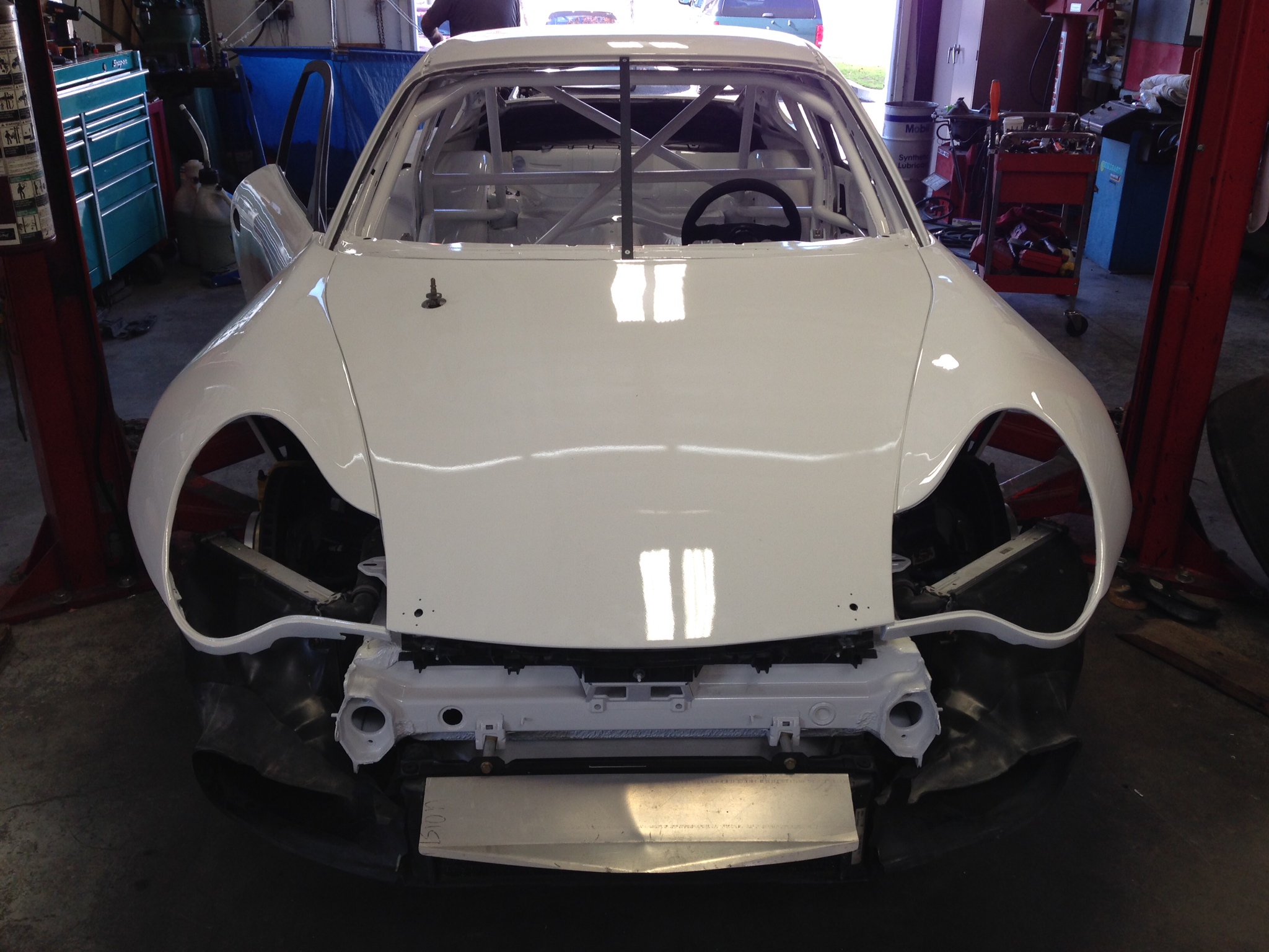

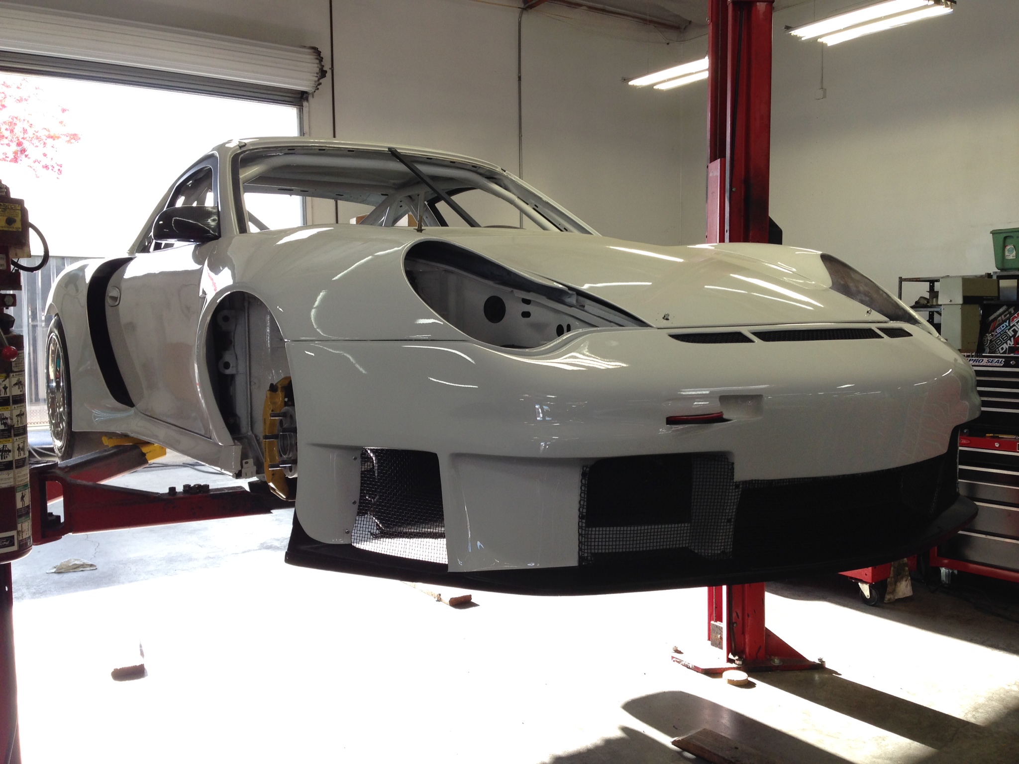

The shop sent me the pic of the wing, i have not measured it or know the width. It was made to the width of the rear fenders to allow us to tie the end plates into the diffuser (you thought I was joking about the DTM reference lol). I'm guessing it's more like 73-76". I'm traveling now but will find out when I stop by the shop when I get home. The car is up to 584 wheel at 1.2 and we they ran out of injector again (we are trying to preserve low and midrange hence the small injectors and gradual increase until we find the sweet spot). New injectors and more boost to finish the mapping.
The front wings are considerably wider than stock to run 11" fronts. We have tons of DF going on at the rear and must compensate up front with more grip to balance this thing out. Here are some pics of the front wings but not sure what the final width will be. I know there will be some big dive planes to make them even wider. We will pull molds off the wings to make sure we can replace as necessary. Probably would require a ton of modification to adapt to a street car.
