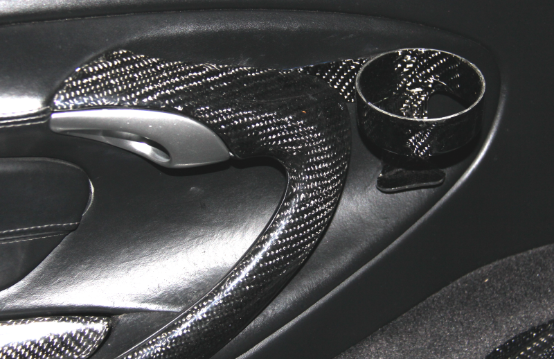

My car didn't come with cup holders - I had to make my own. It turned out nicely and placement is good...
now thats thinking outside the box!

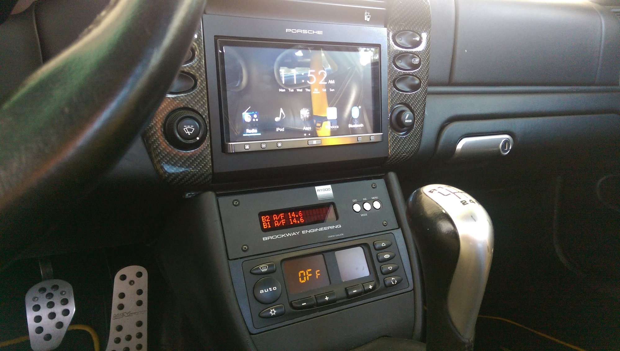

I recently updated my radio for a double din Pioneer AppRadio 3, pretty straight forward job!!
Pioneer AppRadio 3 on my GT2
