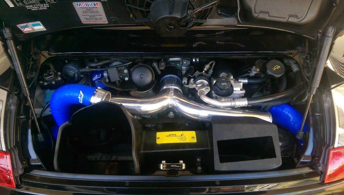

The first version of a custom Y-pipe I did was actually one with blow-through MAF, but the straight joined section before the sensor wasn't long enough for smooth flow and I had CELs repeatedly.
Second one is the the one in the pic below. ID is the same than in IPD's but it was done for aftermarket air cleaners in the engine bay. After testing and logging I decided to go for OEM 997 airbox and Y-pipe. I just couldn't seal air cleaners well enough from engine compartment's heat but now air entering the turbos is within 2C of ambient air's temperature.
I will get some logged data about (most likely) improved flow (with IPD's Y-pipe) when the season starts in April. Anyway even now the engine seems to breath easier compared to previous versions of aircleaners and turbo inlet piping. With that custom Y-pipe I had rather restrictive inlet piping. DIY Y-pipe I still have (for sale too) would be just fine if using air cleaners somewhere near turbos and running MAFless tune or standalone ECU. Neither of them are to be found from my car in near future...

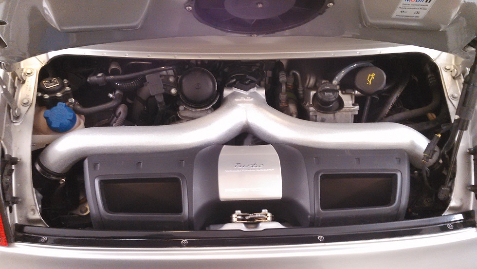

No. I still have a MAF. Only on the other pipe, it's signal is the doubled with tune. And it works... ID (difference) is best described in this picture:
http://www.ipdplenums.com/products/p...os/9971-turbo#

I really cant't say, depends on what parts you're going to use, how much you can DIY etc. I have three different Y-pipes, one OEM and several aftermarket airecleaners (housings), two sets of aircleaner-to-turbo pipes and so on....constant development and lots of extra parts. I think I now have reached the combination I was looking for at the first place. OEM 997 turbo looks with better flowing, but not excessive sized piping.
I must add here that AFAIK my car's the only 996 turbo engined car with with electronic controlled VTG-turbos (from 997 turbo) in the world. DIY.
