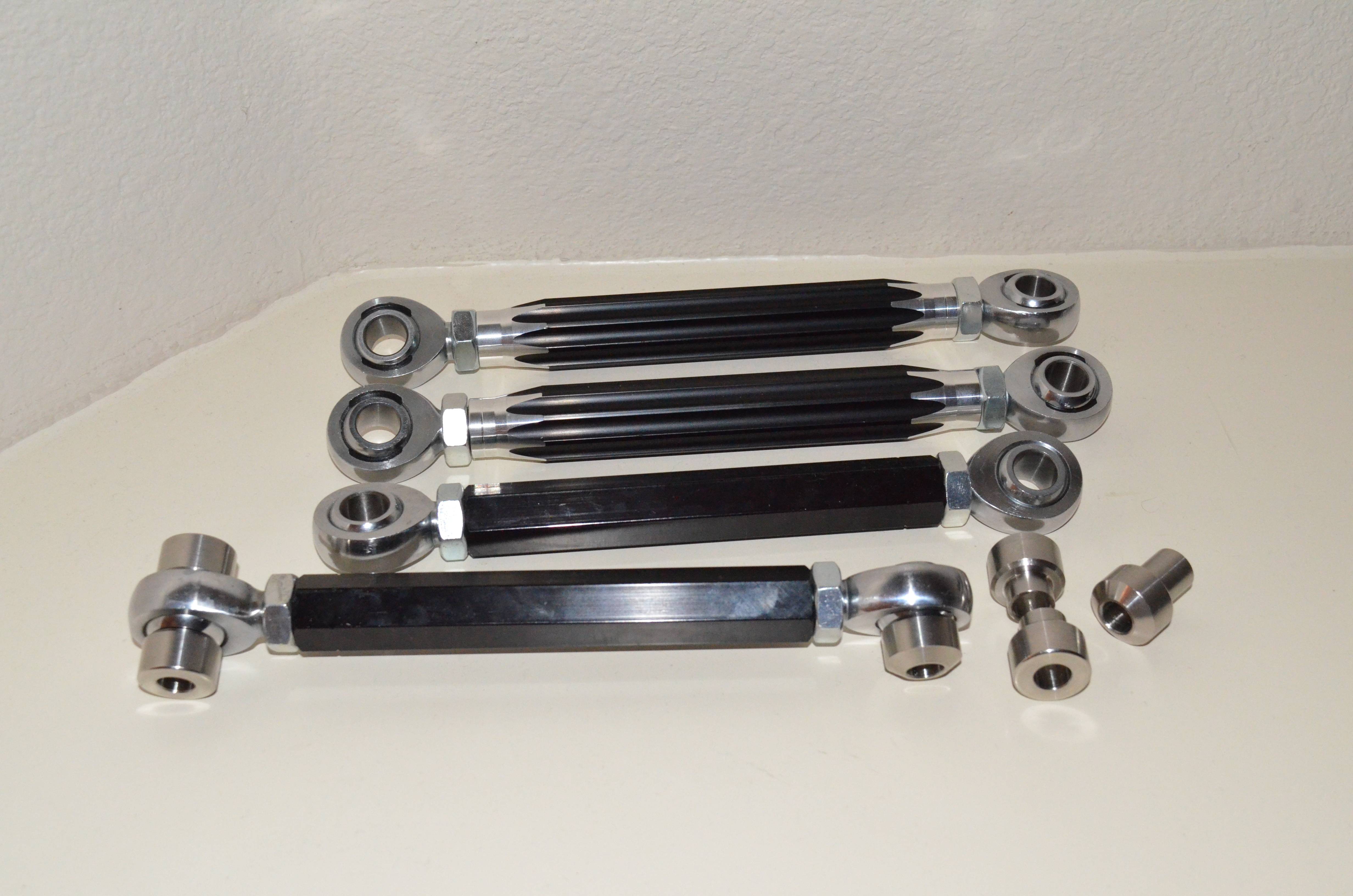

I recently made some for my wifes 135i. Sometime between ordering the last of the parts and receiving them she decided she wants to get back in an M3 so they may find their way on my 335i.
I had originally bought a popular set from a vendor but really didn't like them. They really used the wrong sized tubes. I had a machinist make me up some sleeve/spacers in stainless (better than the plain steel the vendor used) and got some proper length tubes that would allow for sufficient thread engagement on the rod ends.

Can someone post up and measurements for the correct length of the aluminium tube and the measurements of the rod ends ie thread size and bolt hole diameter and if poss a drawing showing the shape and measurements of the spacers.
The scalloped dogbones are definitely the better looking ones but my question is how will you hold onto the tube part to adjust the settings further down the line when the rod ends get tighter in them? Surely the better option is one with a hex for a spanner!

Check this thread.. i put most of the information there. Total lenght of the rods i made was 6.75" https://www.6speedonline.com/forums/...es-budget.html

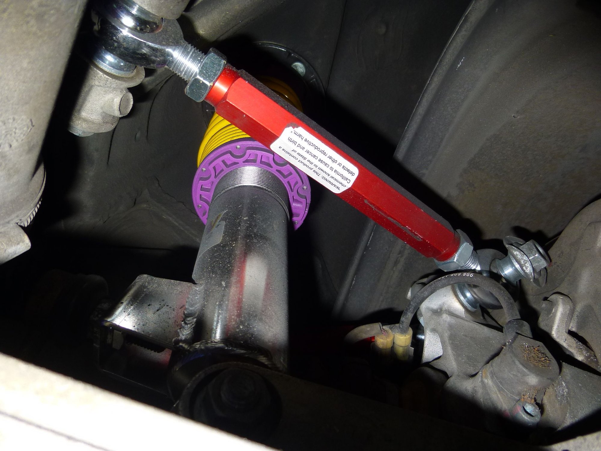

Dog Bones!!
Originally Posted by OS Inspector
Wheres all the mounted up pics? everyone leave them on the table to look at?
Here is a picture of them installed!!

Installed
Coilovers set to lower 2", KW V1
