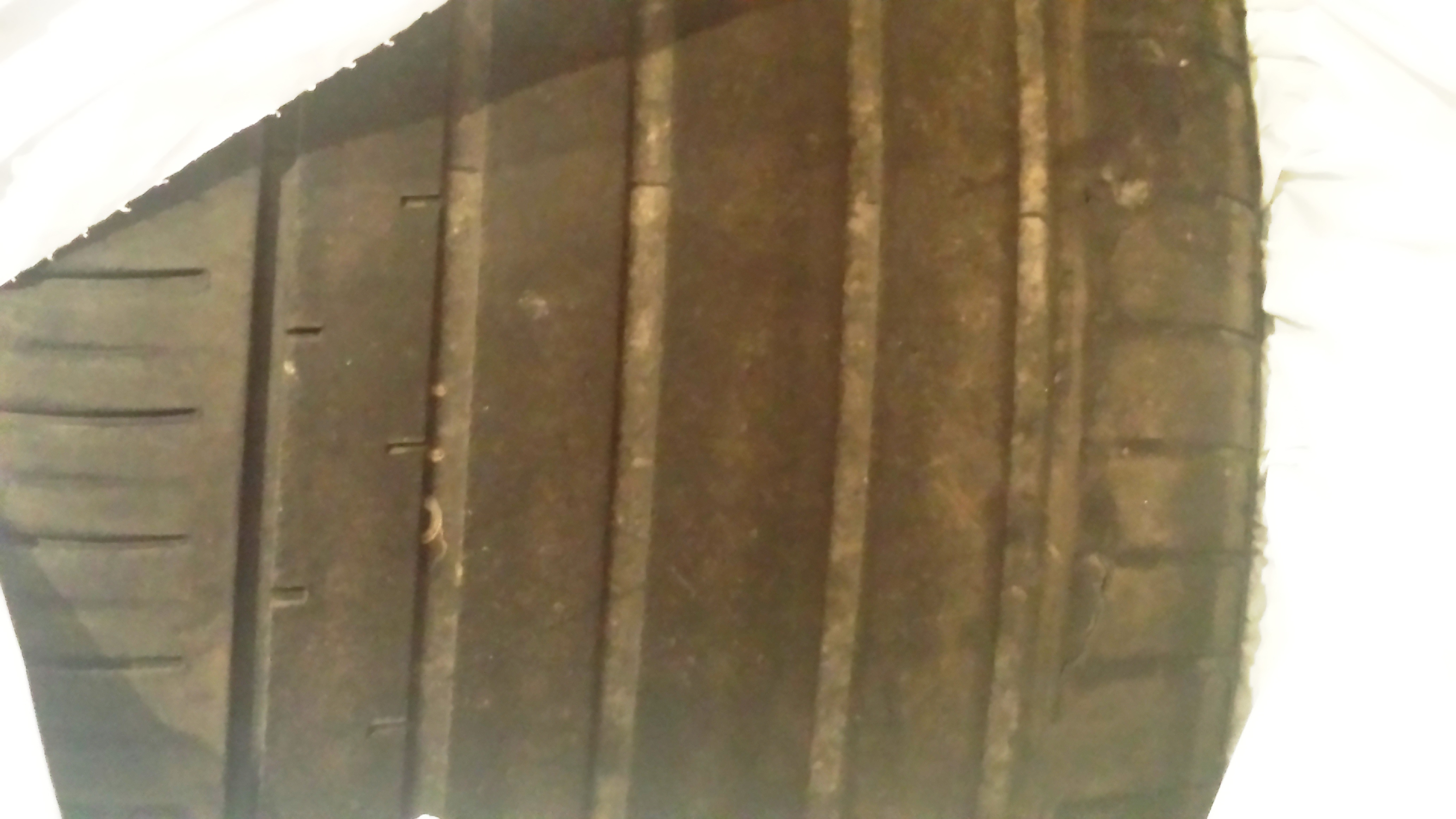

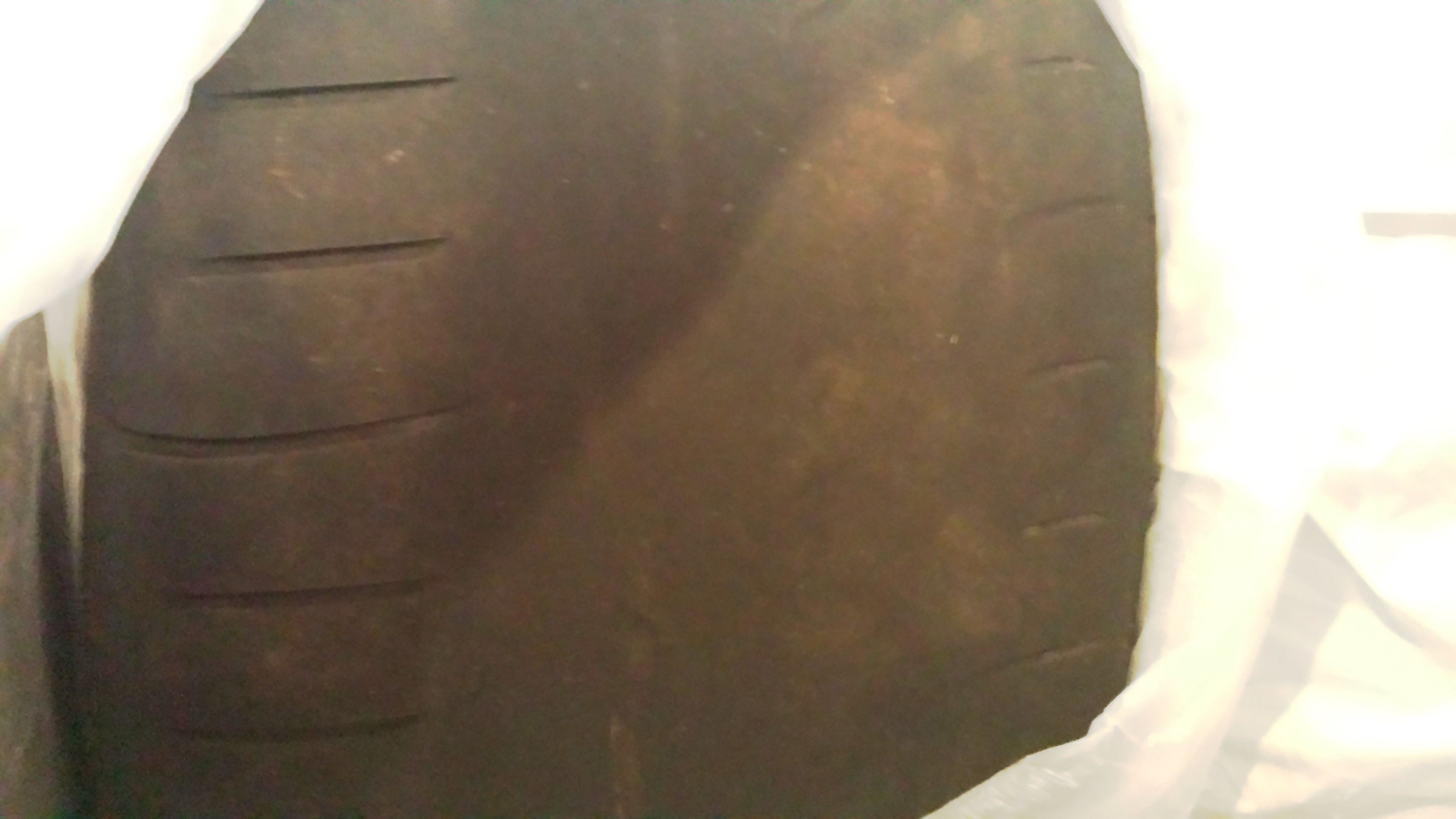

My car was aligned a bit over 2K miles ago with rear camber sat at -1.20 degrees and rear toe at 0.27 degrees total.
My car is lowered about 1.75" with KW V1 coilovers with less than 2500 miles on them and has upper adjustable dog bones, also an Eibach adjustable rear sway bar.
Here is how my tires are wearing

Camber will wear the tire gradually inner to outer across the tread. Toe will wear the inner 1-2" or so. Toe is your issue. Your static rear toe setting is correct but it's likely all over the place under load. The rubber bushing in your rear LCAs are likely breaking down and allowing toe to change under load moving fore and aft during braking and acceleration. It's a very common problem on these cars. Install solid TA bushings and inner monoballs and your issues will be all but eliminated. Added NVH is negligible.

Thanks for your comments guys. As noted in my post #15, the squat under hard acceleration is wearing the tires like this. I agree it's the toe that changes that is causing the wear.
What I don't know, but assume, is that toe in increases during suspension squat as a built in safety device to keep the car pointed in a safe direction. If it was opposite and it towed out or was totally neutral, the car would be difficult to handle.
So, how much of the increase in toe is due to suspension compression and how much is due to rubber bushing deflection in the toe links? In a track car, or one set up for ultimate handling on relatively smooth pavement, high spring rates can be used. This alone will minimize squat, therefore excessive toe in under hard acceleration.
On my car, the KW V1 coilovers are fairly softly sprung and compliant. I'd assume my car with less than 30K original miles has the rubber bushes in the rear toe links still in fairly good shape. I don't track my car and never intend to, so a solution to the rear tire wear issue should be one that will not compromise the road noise or the ride.
I'm thinking of 2 things. First may be a progressive rear shock spring of a higher rate to decrease the sag upon accel a bit and second, to manufacture polyurethane bushes with a steel sleeve to take the place of rubber in the OE links.
I don't need to spend hundreds of dollars for something I can easily make myself. I don't need the adjustable length feature either, or the tapered pin that could be bushed to decrease or eliminate bump steer as that's not an issue.
I'd appreciate any info on how much of the toe change during accelerating squat is due to link OE bushing deflection and how much to rear spring compression. I have a feeling just doing the bushings alone won't make a huge difference.

too much toe in IS the issue. everyone that has ever gotten one of these and gone thru a cpl/few sets of rears on a lowered car deals with it. the excessive inner wear.
you simply need adjustable to links whether tarett/torque solutions, whatever. adjustable, to dial out less toe IN, and compensate for had acceleration squat which also places excess demand on the inner tread section.
all too common. adjustable toe links is the cure to uneven wear, coupled with a properly aligned and inflated set of rears. have just and only one facet of this equation out of synch? buy new tires. ( again )
