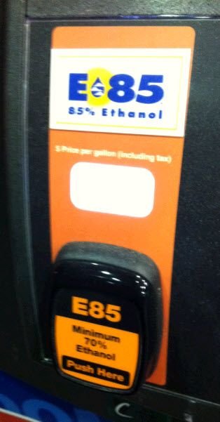

99% of the cars on here are street cars -- This makes a standalone EMS ideal, where it can automatically compensate for the ethanol content, regardless what you pump/pour into the tank. If people flash tune, they REALLY should buy vendor E85 (VP Fuel/Rockett Brand/etc.), and either 1) test the fuel's ethanol content, and/or 2) tune conservatively.
Legally, E85 from a pump should not fall below 70%, according to the Govt required legal disclaimer
And others have said this, no one should "trust" a gas station to have quality E85.

in my town i have seen e85 at the pump thats e50. i have purchased c85 race fuel directly from vp racing 3 times and haven't gotten above e77 yet. flex fuel analyzer is the only way i would run ethanol
