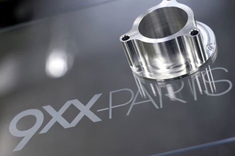

Originally Posted by VAGscum
These differences in shock length is because of differences between the cup rear spindles and rear subframe and that on the street cars.
Plus 640 mm diam front and 680 mm rear tires, while the rake is still about the same 20mm than in street cars. Ie rear wheels are really deep inside wheel wells. If you're not going to run similar set of tires, you need to use 40-50 mm spacer. Again, don't ask how I know...
Here's a pic of my "new" ones, they will be anodized black next week. "New" because they were just round ones before some weight reduction. Lost 60% of their weight. 50mm thick.

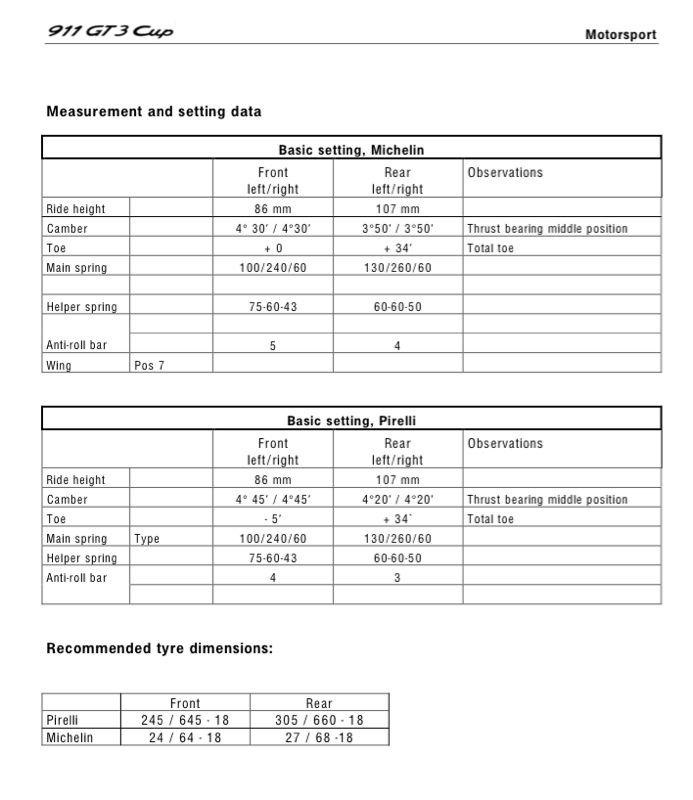

Originally Posted by pwdrhound
Factory Cups do NOT run 305/35/18s. Factory 996Cups run OEM N1 spec Michelin slicks size 24/64 18 and 27/68 18 on 18x9x11 wheels. Fronts tires are 25.2" and rear tires are 26.7" in diameter (there is also OEM approved Pirelli slick with the same diameter dimensions). Midway through the production run, the rear tub was modified on the Cups to give the tires more clearance. Regarding 996 Cup ride height variance you may have seen, per the Porsche Cup maintenance manual, there is none. Ride height is clearly spelled out as 86mm front and 107mm rear. Fine tuning is allowed to bring corner weights within specifications. Other than that, Porsche does not give you leeway. This is clearly done to make sure the shocks are operating within their design specification. For example, if you raise the ride height up, you will severely limit the already minute amount of droop built into the shocks. The popular 996TT/GT2 rear tire diameter is 25.5" which is 1.2" (31mm) shorter than the Cup tire. This translates to 15mm shorter radius. If you were to bolt a 996TT sized rear tire on the Cup car, you would get a rear ride height of 92mm (107-15). Taking into account the TT rubber subframe bushings thickness difference (7mm) compared to the solid GT3 cup bushing, you end up with a rear ride height of 85mm when translated to 996TT numbers. Compare this 85mm ride height number to the factory ride height of 163mm for a stock 996TT or 135mm for a GT2 and you begin to see the light. Even when comparing the Cup with the GT2 (both solid subframe bushings), you are looking at a difference of 50mm in ride hight. As a result, if you are shooting for GT2 ride height on your car, you will need a 50mm spacer on the rear Cup shock. So I wanna use a 0.9" taller 305/35/18 (26.4" NT01) tire you say? Well, to preserve GT2 ride height of 135mm you will need to lower rear spring perches 11mm down to 124mm at the rear measuring point of the subframe. If you do this, then you will need a 40mm spacer on the shocks. This is about as low as you will be able to go with the relatively soft 1000# springs you are wanting to run as the larger tire diameter will rub the fender liner under hard compression. Remember, a 3500# TT will have a lot more compression of the shock with 1000# springs than a 2600# Cup car will with 1484# springs. As far as minimum safe ride height on the street? Depends on your comfort level and type of streets. I am at 98/124 with 25.7" and 26.4" tires in 1400/1500# springs. I do not rub anywhere but my suspension is very stiff and I have GT2 fender liners along with all Cup/RSR fully adjustable suspension components to maximize clearance and minimize movement. This is a picture of the ride height to give you an idea. I would not call it street friendly... Hope this helps...
I was off in tire sizing. According to this they call for 304/660-18 which should be 25.93. What am I missing?
Old Mar 10, 2015 | 02:32 AM
  #28
pwdrhound's Avatar
Joined: Jul 2010
Posts: 4,848
Rep Power: 457
Attachment 415927
Nobody runs that size. PCA mandated rear tire size is a 680. The Michelin N1 Cup rear measures 26.7" and the Pirelli 305/680 Cup measures 26.9".
