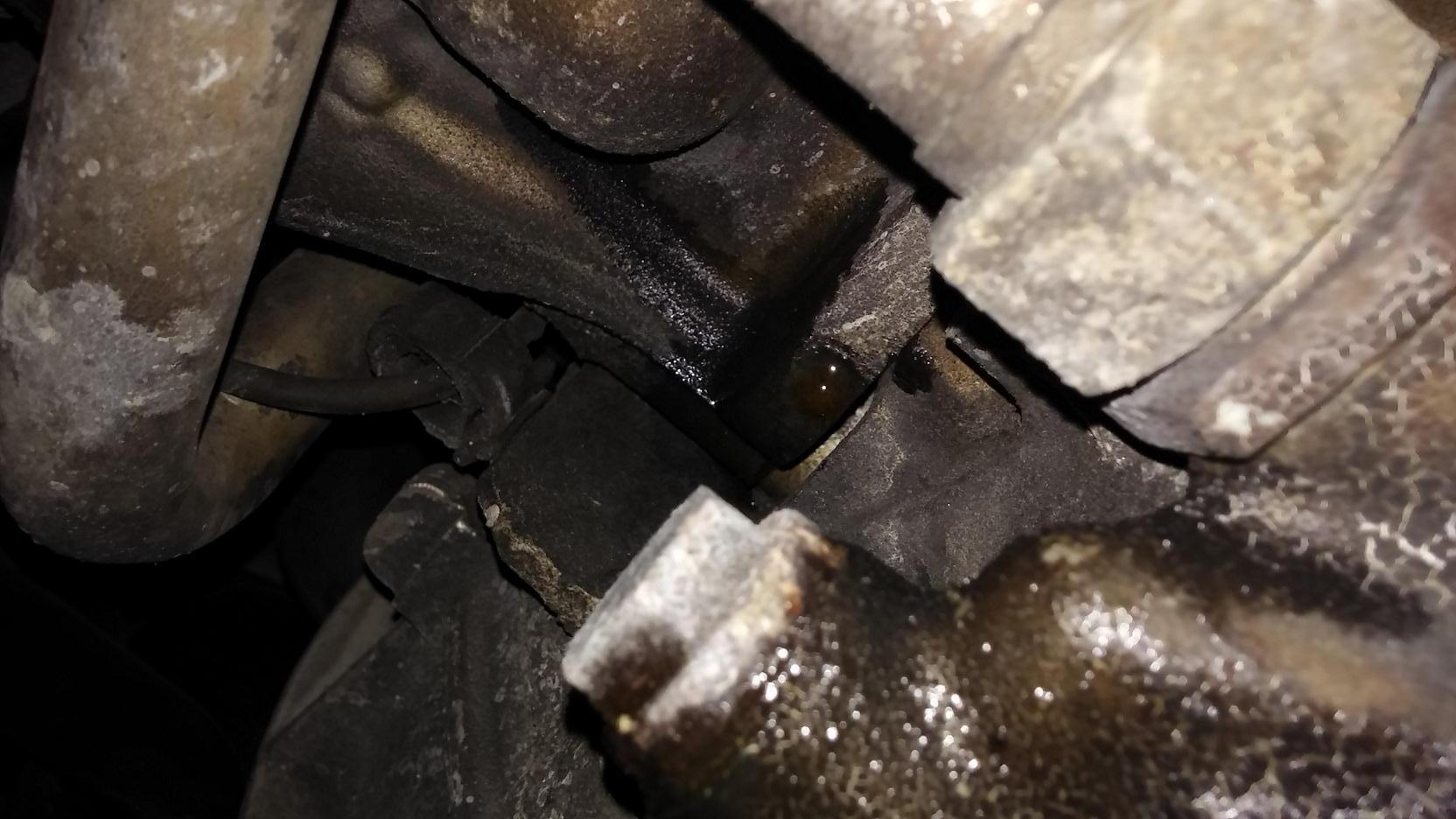

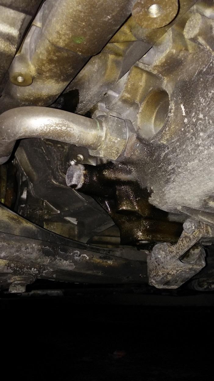

Hard to tell by trying to see it from garage floor at night... I'm pretty sure that's coolant, now it explains few things: Wondering if anyone ever had a leak from that place, and whats above maybe someone can post a picture of the engine....whats above that area....any coolant pipes?
story: Had to add coolant few weeks ago to top it off, because it was below _low_ line, (have the car for 8 months now so i was thinking maybe it was when they changed the clutch ), since i drive the car only on weekend.
Was checking for leak last weekend, car runs, drives, no overheat, no warning lights etc,...i pull out of the garage, no leak when its fully warmed up, after 50 miles of driving it, no leak. (BUT IF car is left over night, it shows wet spot on the floor) thinking when coolant cools down it leaks----also it looks like someone used wrong coolant as well, or its just old, looks orange/yelow'ish, smells like coolant car has 47k miles, probably never changed.
Wondering if the engine needs to be dropped to fix that leak.
I took few pictures, that's rear drivers side.

I can't tell from the picture, but there is a very small hole on the water pump. It is there to tell you when the inside of the pump is toast. The "warning Light" for this failure is a small puddle on the floor. It is very possible - that is your problem. If it is the pump, it's not a big deal. Easy DIY. (See my thread)

in that location i would check the oil cooler/manifold or the small coolant hose coming to of oil cooler first then also the heater core lines above the head right next to the injectors.Take a long mirror and flash light and snoop around above where trans meets engine

^ +1 and also clean it from the top down and see what happens. Could even be from a sloppy oil service (I hope so)

^ yeah I can't tell until I slap the car on the lift (too tired after getting home) I'm going to inspect it this SAT to see where its leaking from and also replace clutch slave cylinder - since its just sitting in my garage and that needs attention as well. lol. I just hope i dont have to drop the damn engine!
look closely and try to find where it is coming from cause if it is the small coolant hose coming out of the back of the oil cooler it can be replaced by dropping trans only and since you are doing the slave anyway you would be almost there. just a thought

update: of course, i left the car overnight, put the car on the lift. i see no leak but i see some residue- its Sunday, who cares - only day i can have quality time with my car. but I prefer to drink few beers and watch sports channel - LOL I need to purchase adapter to pressurise the system. keep you guys updated

oil spill when changing oil filter and it works its way down.. or rear main seal

nah mark, I do oil changes my self and I'm super carefull about any spill anywhere my car is just a ghost.
