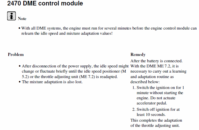

Immages are on loan from delamarearnaud thread, used for reference:

I've never done it on this car, but throttle position sensor re-calibration comes to mind as well. It is really easy on most cars - you may need Durametric for the 996TT. Perhaps someone can chime in who has done it...

i dont know why you'd be surprised? if you have bad check valves which are plastic and get brittle and crack, they create leaks that affect boost. just hope its that simple! was for me, once found! lol
hey, dont forget to re-calibrate the TB after disconnecting the MAF. people often do. turn on the key to "on" for 30/45 seconds until you hear the tb reset itself.
then tun off key, and restart normally.

I'm still thinking throttle calibration would fix this. It Doesn't look too complicated...
EDIT: I would disconnect the battery first to make sure you are starting from scratch.

Adaption routine didn't do anything.
