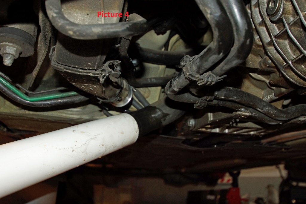

2] Now make your way underneath the car (mine was on jacks) and remove the under body protective panel the most toward the rear (basically just in front of the transmission). On the driver side, just before the tranny, you want to look for the location where the rubber coolant return hose is connected to a solid metal pipe by way of a clamp (see picture 3).
3] Put a bucket underneath the connection point, release the clamp (I used one of my MV Agusta specialty pliers for that – this is where hobbies meet J) and undo the hose. You will collect about half a gallon of coolant.
4] Now comes the interesting part. You will use that same drainage point to collect nearly all the coolant that’s left in the car (radiators, etc…) by applying air pressure from a compressor. Since I was all by myself doing this procedure and wanted to see what was going on at different locations, I pushed the rubber hose into a 2 inch diameter pipe which was a left over from a pool project and ran that pipe into a large volume container (see pictures 4 and 5).
