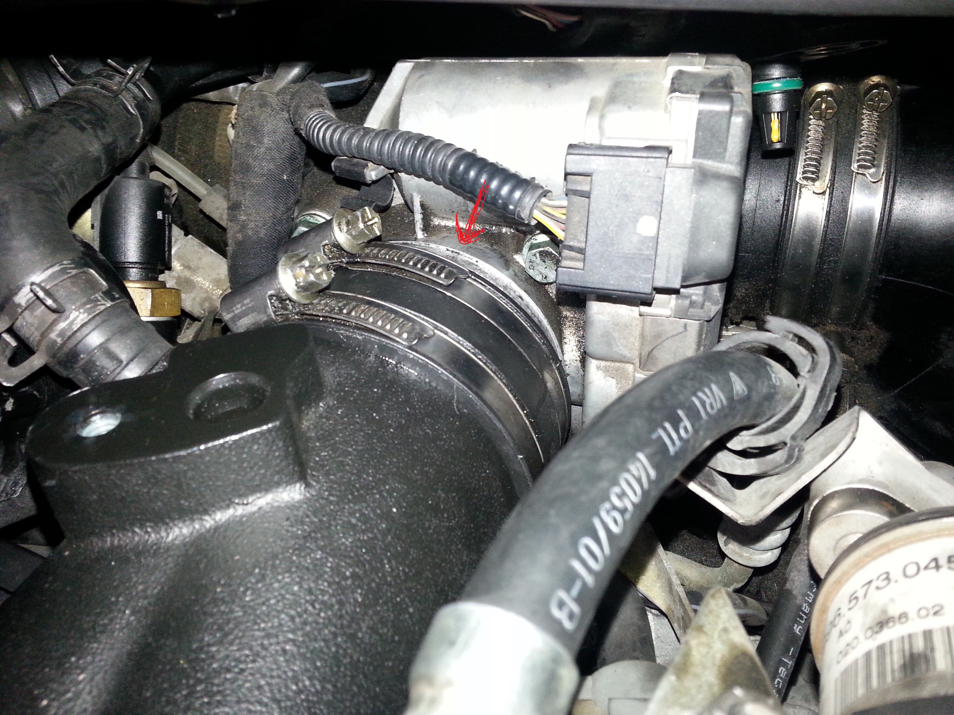

I could neither get the Y pipe fully disconnected thanks to the N75 hose, and now after the alternator is replaced, I cannot get the Y pipe back in place.
Specifically where the Y pipe meets the throttle body.
Red arrow points to the gap showing the coupler not going onto the TB far enough.
What's the deal with this?
Anyone who has reinstalled the Y pipe, did you start with the coupler attached to the TB and then push the Y pipe into it or start with it on the Y pipe and shove it onto the TB?

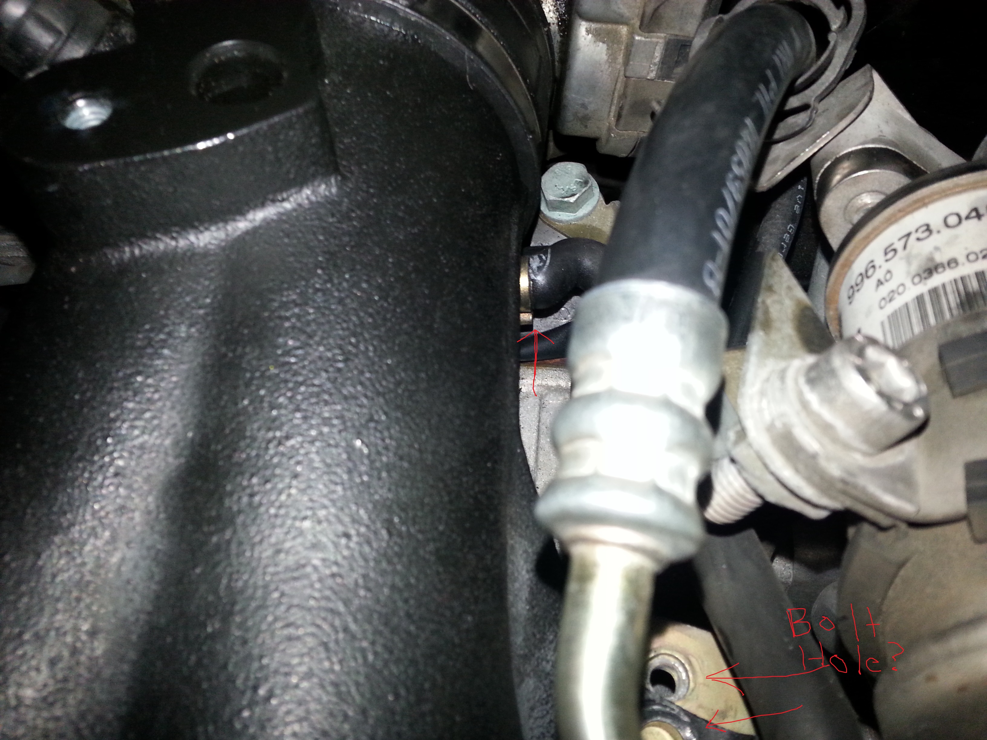

Secondly, the N75 hose looks like it might cause some problems.
Where I have the red arrow pointing to here, does this look like the hose is torn? (which will be a boost leak)
You can zoom in on the picture for a more granular look at the hose area.
Also in this picture, is a good indicator of how far off the Y pipe is as you can see the bolt holes are pretty far apart from where they need to be to secure the pipe.
I spent a solid 2 hours on this by itself, trying to get the Y pipe back on with no luck.

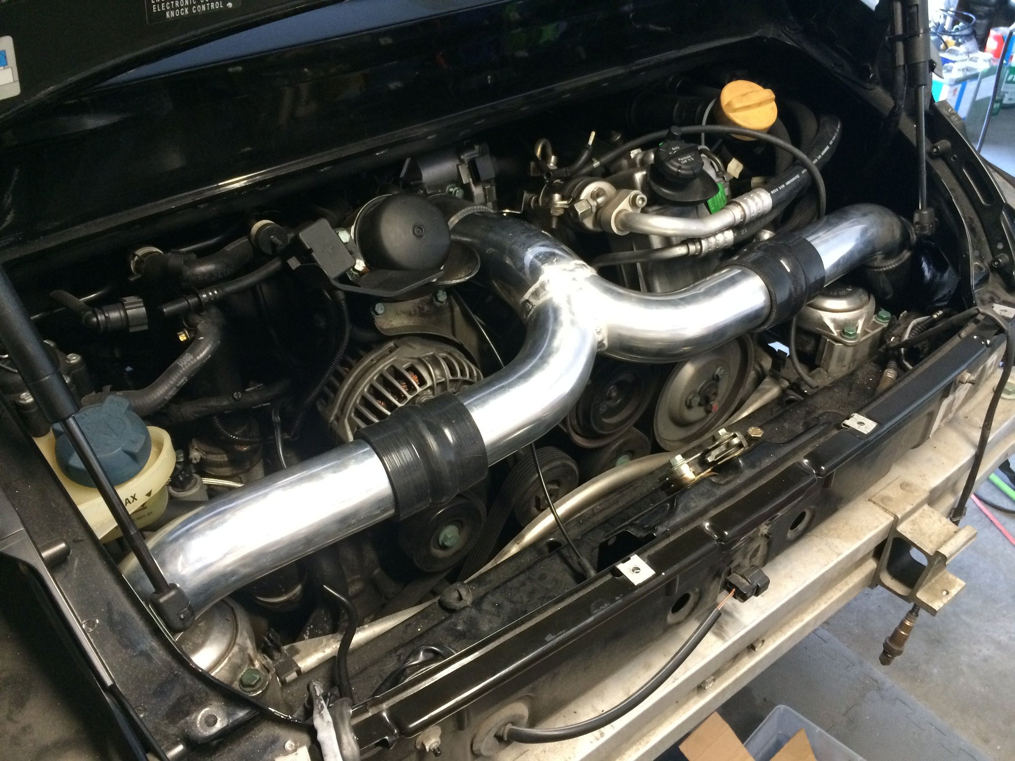

That rubber hose is notched for the TB so once it's on..it should stay and the bolt will hold the y-pipe in place. So really the 996TT y-pipe should not be blowing off under boost...as it's designed to be pretty well connected. Here's my new y-pipe MUCH better than factory IMO. I say DO IT!

i would lower your engine
untighten your t plenum a little and turn it down
from what i see at your picures the t plenum is not perfect in line with the y pipe...

That had crossed my mind too because that's the only physical explanation that makes sense, but didn't know the plenum moving was a "thing".

Make sure you have the worm clamp really, really open so it doesn't catch on the lip. If that doesn't work, try putting the TB side on first and then the Y pipe side.

Yeah I loosened them up a lot originally and moved the screws to the top of the coupler so they didn't fall to the bottom as you can see in the picture.
Anyway, yeah going to go out to the garage here in a minute and try it with the coupler on the TB first.
Old Apr 13, 2015 | 08:27 PM
Top's Avatar
Top
Joined: Feb 2013
Posts: 14
Top is infamous around these parts
and I'm back.
Managed to get the upper left boost hose off with a panel popper.
After that I had much more maneuverability.
So coupler onto TB first. Tighten it down.
Shove Y pipe in snugly.
Rest was a breeze.
