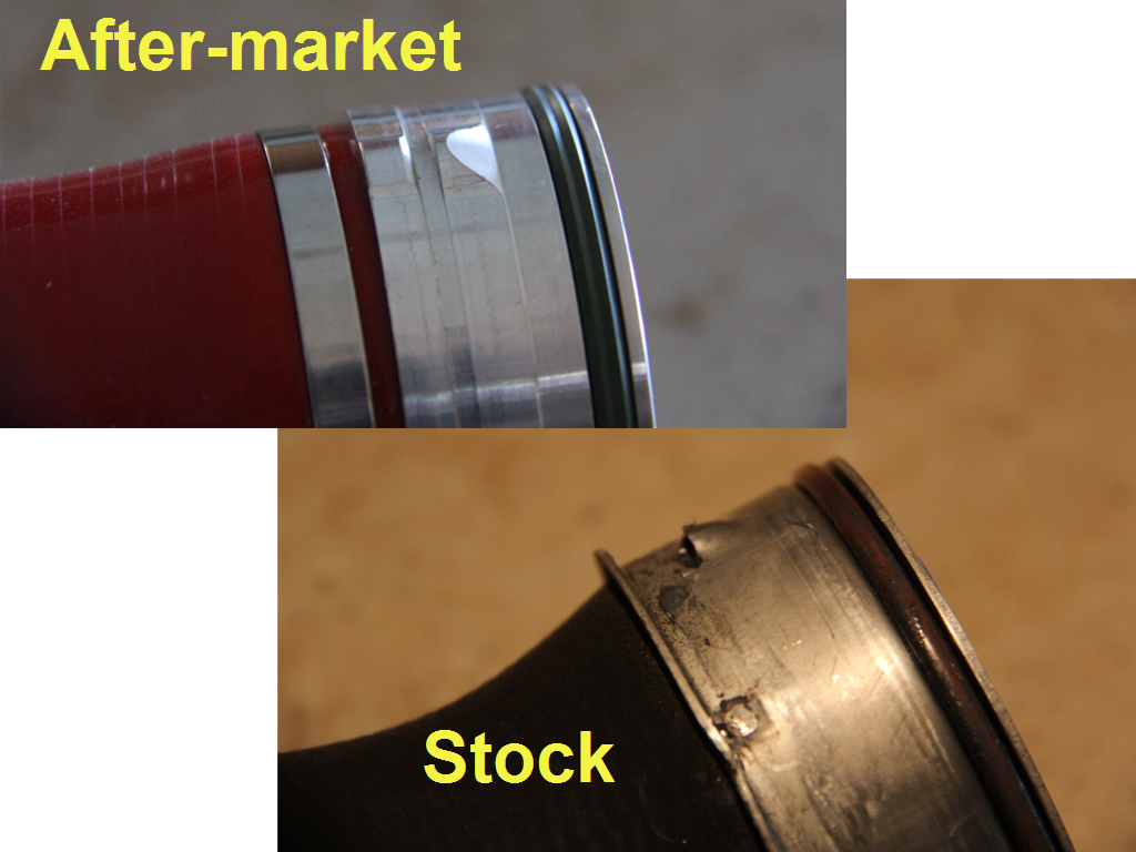

This is why the hose came off - OEM hoses are not very good!
