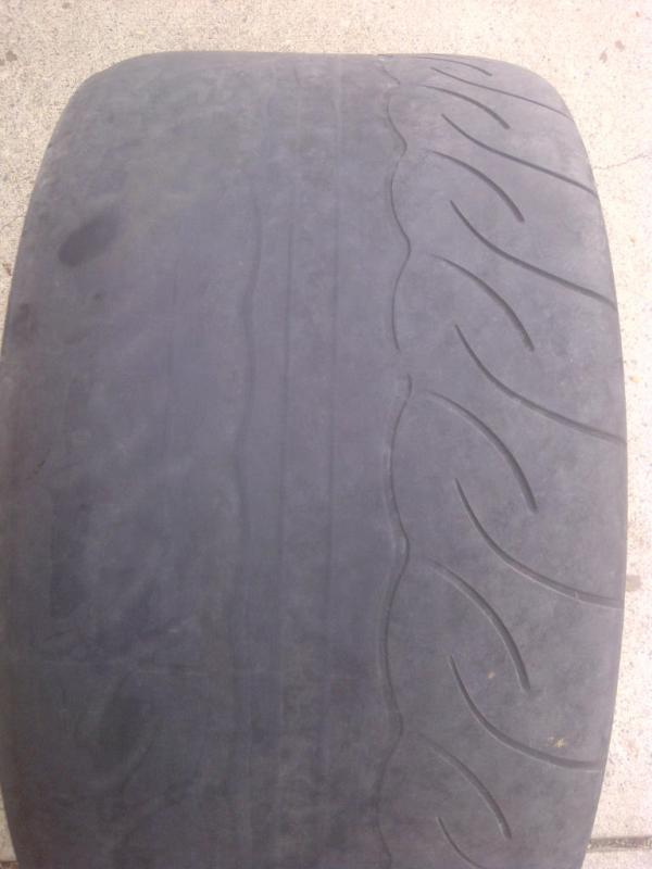

What do you call straighter toe? You have to know how the suspension geometry of these cars works and pick numbers accordingly. To little toe and these cars get unstable. I run a fairly high amount of toe on many of the cars I set up and get very little scrub wear.
Here is a tire that came off a car I set up and was run it's whole life with 2 degree's of Camber and 1.85mm per side of toe in. You cannot get much better / even wear than this! The way you set up you car would kill nimble / stable handling.

I do my own alignments: 0mm front toe, 1mm total rear toe. Will see how my car responds to the heimjoint toe-links and adjust as necessary, think setting is almost perfect beside WOT toe-flex on rubber bushings...mostly neutral but a bit hairy when near/WOT
high-speed running you do want a bit more toe-in....

You are likely not getting toe flex, When these cars squat the caster changes and the straighten out to improve turnability, hence the instability you feel. Lay the car into a corner and the suspension loads and the loaded wheel straightens out, if you have to little toe in the wheel toes out and the car gets way more unstable and prone to swapping ends. It is my opinion your set up does not save you much if anything in terms of tire wear but it hurts your handling.

I took the car out today and flicked it side to side. It is very mushy. It's like the ads end will wiggle while the car keeps going straight.

Understand the geometry change under squat(has anyone done a posted analysis of geometry vs. height?), will dial in the same toe with the Champion links and see if the toe-out change is flex or geometry based.
String alignment
What are you using to do your own alignments are you string & boxing it or do you have access to a machine?
