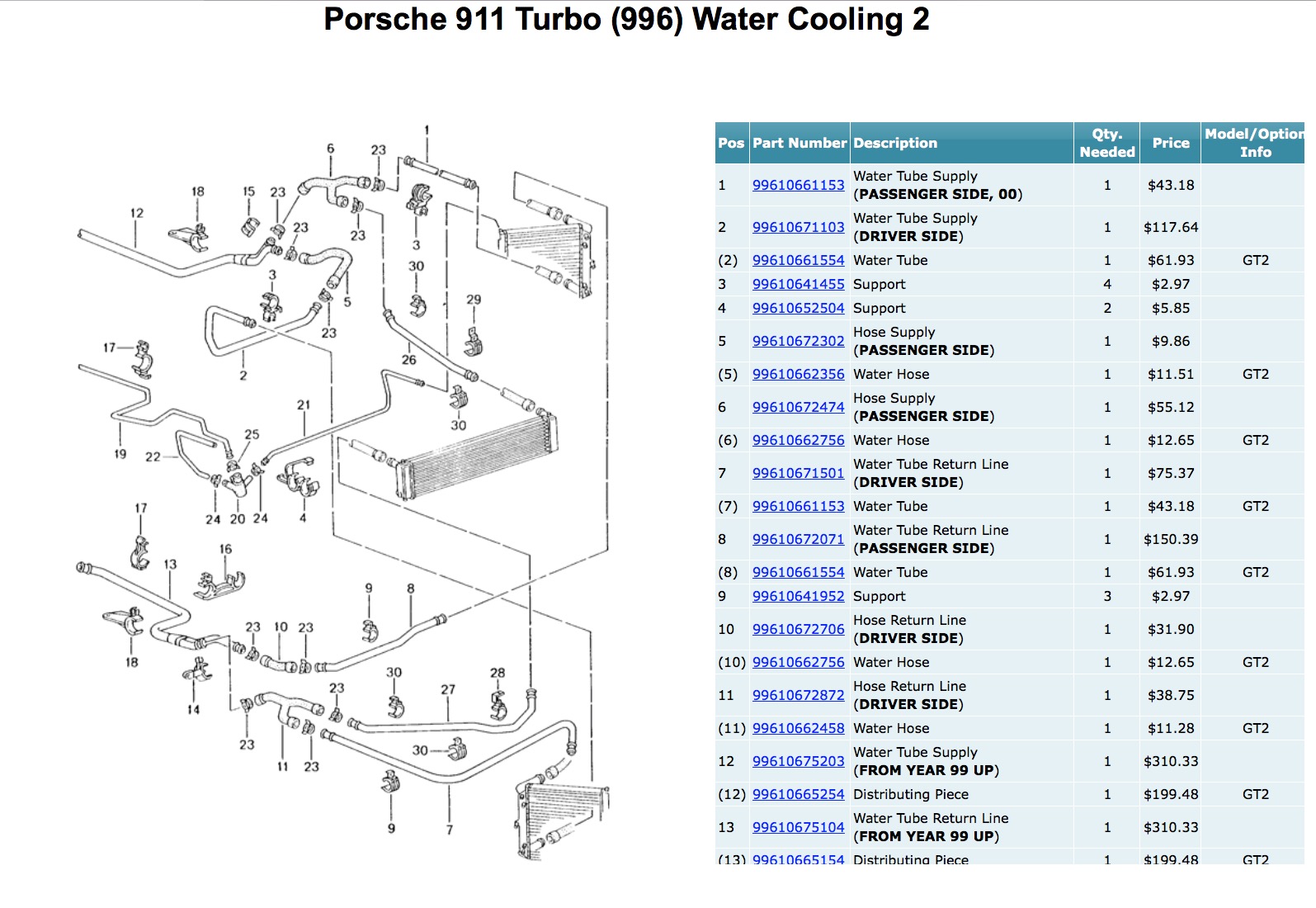

going to take of the front bumper and inspect next weekend, what happened i started the car pulled out of the garage and shut the car down, few min later it started to drip, front center - > do you guys have any diagram how the coolant pipes run up front ?
Old Jun 19, 2015 | 07:41 PM
jpflip's Avatar
Joined: Mar 2008
Posts: 2,807
From: Montreal Canada
Rep Power: 268
jpflip Is a GOD !jpflip Is a GOD !jpflip Is a GOD !jpflip Is a GOD !jpflip Is a GOD !jpflip Is a GOD !jpflip Is a GOD !jpflip Is a GOD !jpflip Is a GOD !jpflip Is a GOD !jpflip Is a GOD !
Is it what you are looking for?

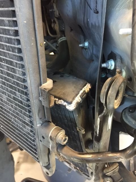

I hope you don't run into this problem, I just purchased my TT and had taken it in for an oil pressure sender. The guys at Autoscope looked my car over and BAM. They found this lovely surprise. Between the oil sending unit, oil service, spark plugs and both side radiators my new to me TT she is becoming an expensive date really fast. LOL
Good luck on your coolant leak search sir.

^^^ now THAT is the reason i screened in my front bumpers slats! yikes
Old Jun 20, 2015 | 07:48 AM
rmc1148's Avatar
Joined: Jul 2012
Posts: 2,382
From: kirkwood pa
Rep Power: 434
^Its a shame previous owner didn't keep up with the cleaning.
