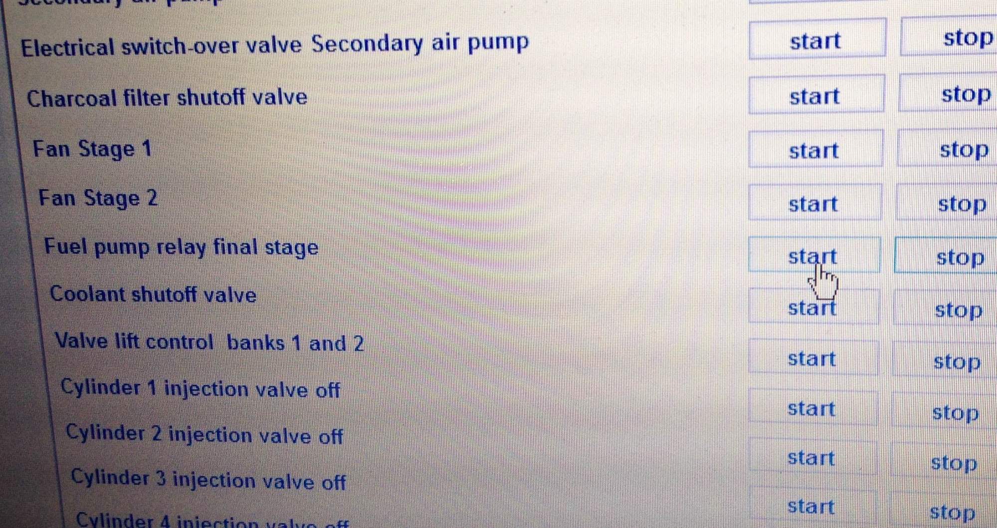

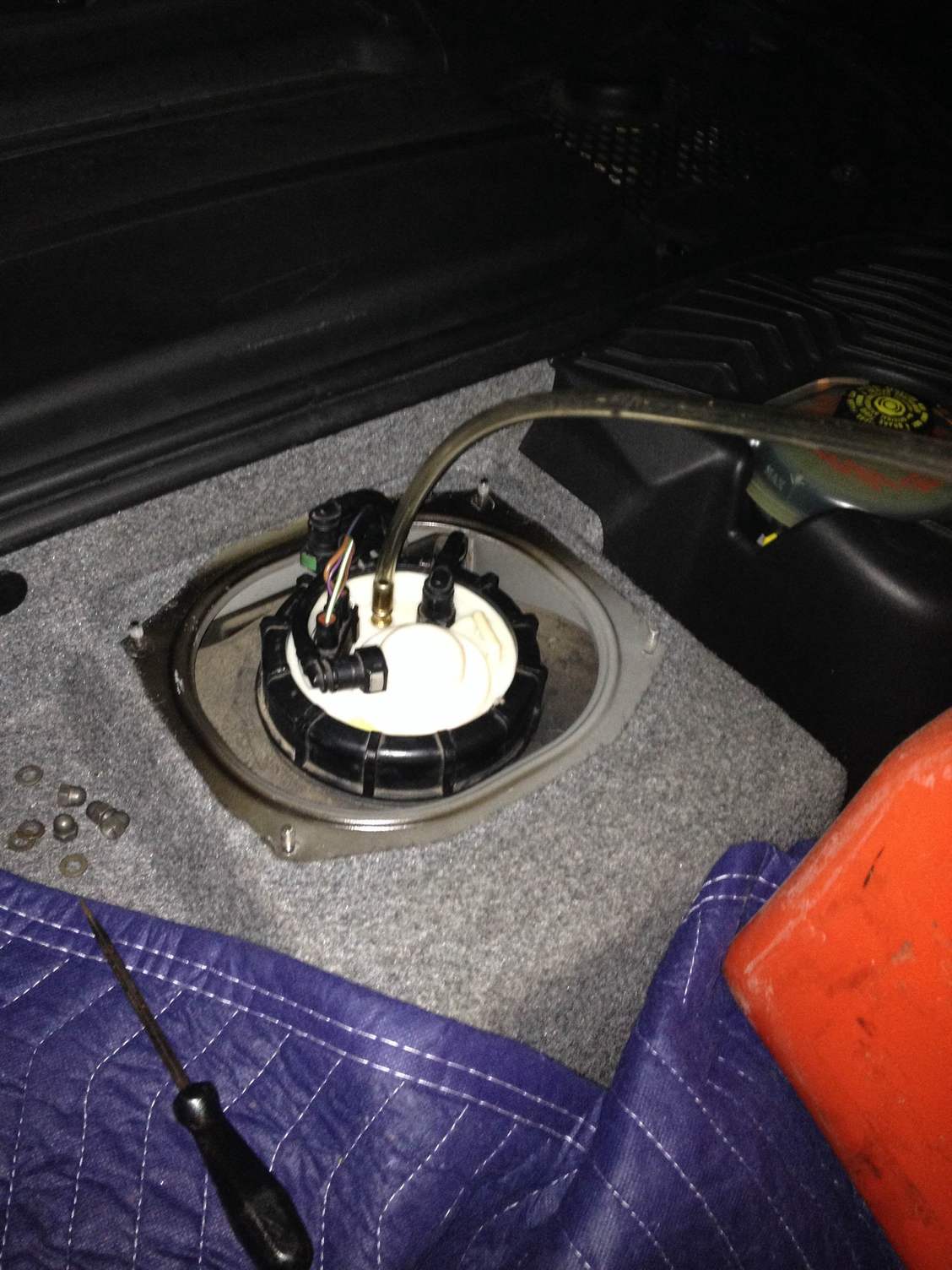

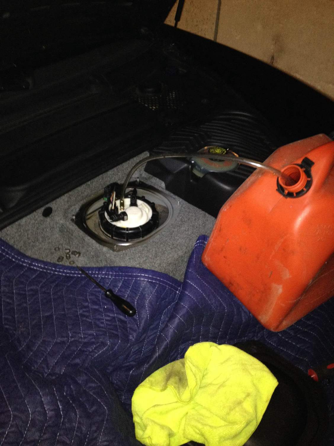

Ok in the quest to find out if my pump is actually putting out fuel I did these quick tests.
1st test
Turn key to on position, then off position. My understanding is that this primes the pump and should pressurize the feed line, feed line should stay pressurized or at least have fuel in it. I then continued to disconnect the feed line. No fuel whatsoever, everything bone dry.
2nd Test
Disconnected the feed line, connected clear hose to feed line connection port on the tank top hat and terminated end of line into empty Gerry can. Connected up my Durametric cable, opened up "activations" under the engine menu, located "fuel pump relay final stage" I commanded this to run, I heard the pump running some sloshing of fuel in the tank but no fuel was being sent to the feed line out into the Gerry can.
3rd Test
Disconnected the Durametric cable, kept the same setup with the clear hose attached to the feed line port, again terminating into Gerry can, inserted key into ignition turned key to on position but not starting the car expecting fuel to prime feed line. Observed no fuel being sent through feed line.
4th Test
Again kept the same setup with the clear hose attached to the feed line port, again terminating into Gerry can, inserted key into ignition turned key to on position expecting fuel to prime feed line then continued to start the car. Observed no fuel being sent through feed line.
So can anyone confirm that I've done pretty much what I can do to find out if the pump is feeding fuel to the feed line. I would assume that at least I would see the pump prime itself on ignition position "ON" or "starting the car"
Would the fuel pump relay be my next step to check? I assume that if I used the durametric cable to command "fuel pump relay final stage" to activate and I heard the pump running I would assume the relay is working correctly?
Now my only other last test that I would like to preform is, from my research some times the venturi feed tubes do not suck fuel in if the tank is at half for below. Currently my tank is at a bit below half. So I will add some fuel to the tank and retest all the above to ensure its not a problem scavenging fuel from the tank. Also I will remove the fuel pump system and inspect all hoses as a last resort.
VIDEO OF ACTIVATING FUEL PUMP VIA DURAMETRIC - Click link below or attachment
File Type: mov
Old Jun 15, 2015 | 11:23 PM
BLKMGK's Avatar
Posts: 2,949
From: Virginia
Rep Power: 575
BLKMGK Is a GOD !BLKMGK Is a GOD !BLKMGK Is a GOD !BLKMGK Is a GOD !BLKMGK Is a GOD !BLKMGK Is a GOD !BLKMGK Is a GOD !BLKMGK Is a GOD !BLKMGK Is a GOD !BLKMGK Is a GOD !BLKMGK Is a GOD !
My money is on a hose in the tank!
Old Jun 15, 2015 | 11:30 PM
rmc1148's Avatar
Joined: Jul 2012
Posts: 2,382
From: kirkwood pa
Rep Power: 434
Sure looks like it.
Old Jun 16, 2015 | 03:16 AM
'02996ttx50's Avatar
Joined: May 2009
Posts: 7,984
From: la
Rep Power: 608
^^ those are what commonly "split" anyway.. so it probably is the hose.
