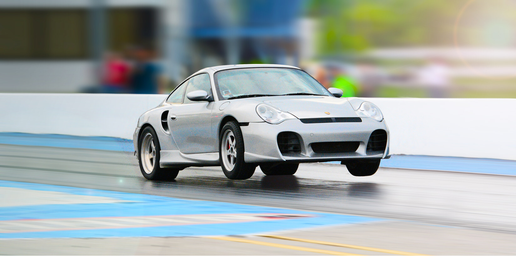

Drag strip tips
1/4 mile on the 996 is very hard and don't worry as only 3 996tts of which one was a gt2 ever ran 9s ( assuming we have everyone listed). I've spent years developing the know how , and most of it isn't really the bells and whistle but rather small details. 17" rims, a few set of tires, endless race gas fuel testing, and Constant plug changes. And yes, parts break and they break a lot. My diff went and 3rd got hurt with the best parts on the market.
So good job
Markski
