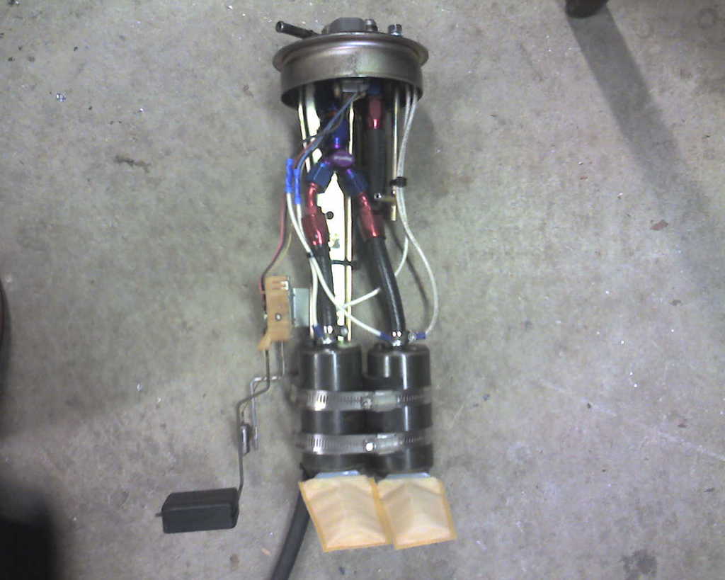

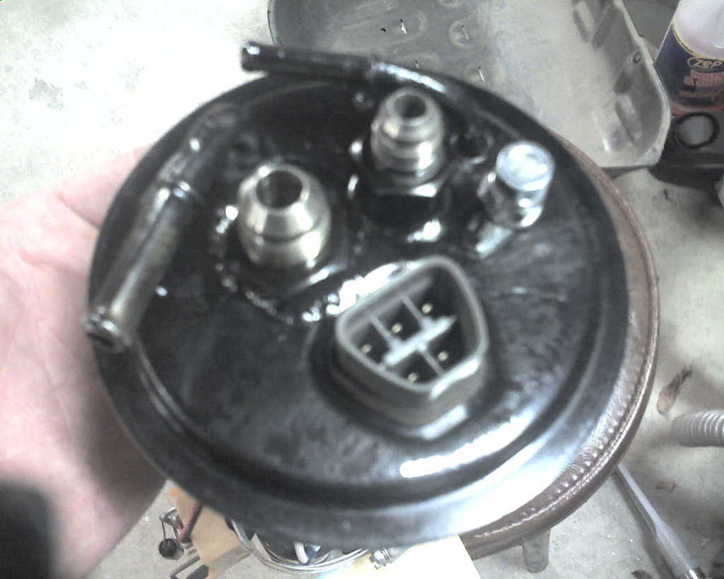

When I built my MKIV Supra...I used 2 brand new in-tank Supra pumps. They pump as much or more than any aftermarket fuel pump, and draw less power. (Poor pictures, but they were taken with the first flip phone with a camera)
