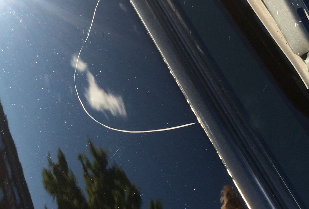

What have you guys done to prevent this?
This just happened to me, and if you're not aware of this problem read on.
The problem is, when e.g. washing your car you pull the rear viper arm of the windows.
If blow the steamer on the viper arm it can collapse back into the window.
Because of the force of the spring loaded arm the viper blade goes out of posititon and the metal parts hits the c-pillar before it slides back into place.
Leaving a U-mark.
Question is, has anyone any nice tricks to solve this?

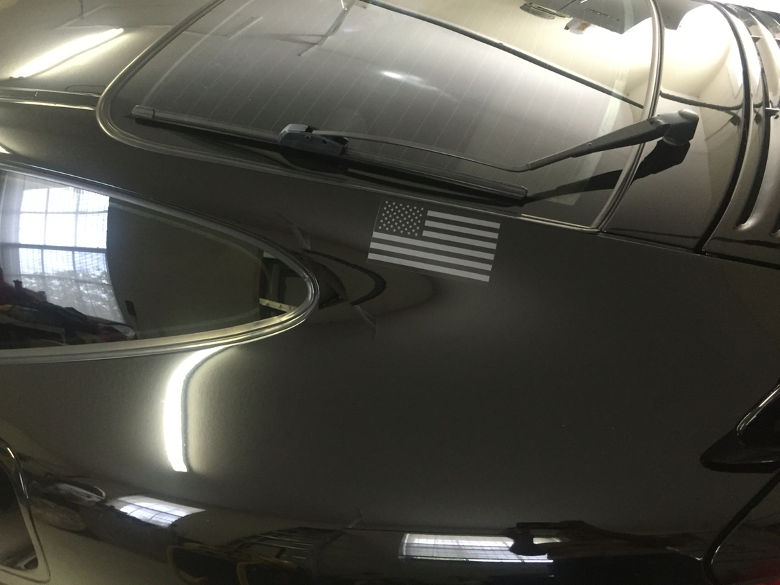

Well now I don't feel so bad knowing I'm not the only one this has happened to! I went to AUTOZONE and purchased a replacement wiper with no metal in it. Then, I had a vinyl shop make me two "ghost black" American flags. I covered the scratch with one and had the other made reversed and put it on the opposite side same location. I know it's "hokey" but I will be replacing the front and rear bumpers soon (very soon) and I will strip car to metal and respray using Standox base/clear.

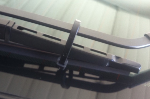

Small black wire tie through wiper blade and around lower part of arm. Problem solved. Barely noticeable. You only really notice it when washing the arm. If you flip the crimping mechanism to the other side of the wiper, the rest of the tie is even less noticeable.

Oh... now I see what's happened :-O Wiper dropped down vertical and the arm came down - OUCH! The wire tie idea is a good one I may have to do just in case, much appreciate that tip!

Nice work Buzz - Excellent solution - simple & effective.
