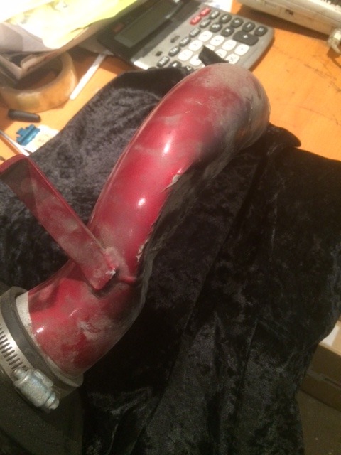

I was hoping to avoid a fenderwell intake at least until we put the forged motor in. I can make my own kit as all the fenderwell kits ive seen end up being beat to pieces to clear the inner tyre wall, my friends acr had some from an american tuner and when we made 3" pipework unhammered the mapper had to 20% more fuel in !!!

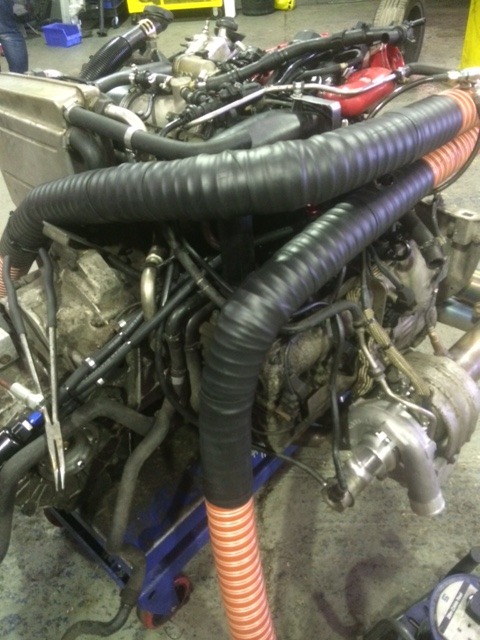

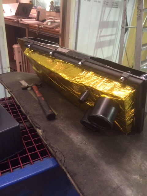

This is what I have, supported up to approx 720 so not bad for stock based.

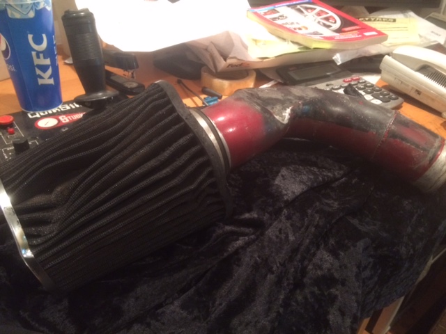

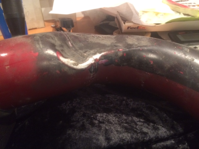

These are the intakes from my friends car

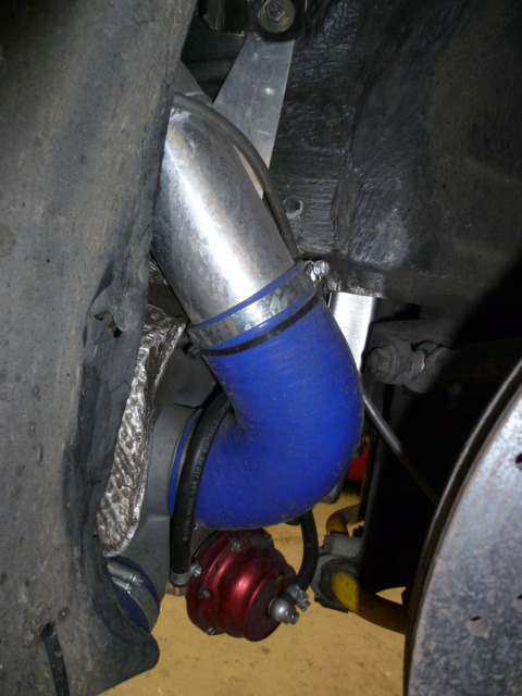

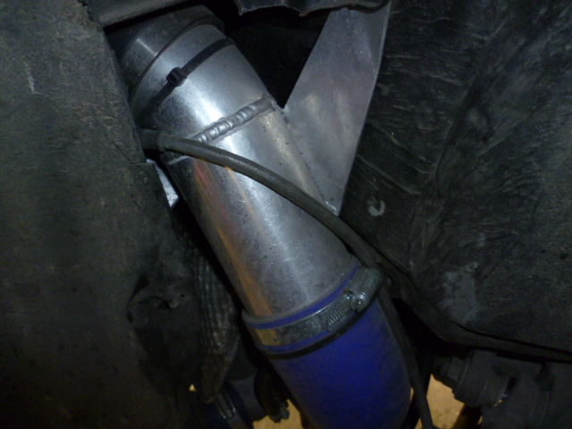

We made these to replace them

those turbos need 3" from the top of the ICs... I have mine this way on 3582s since 2004 with various upgrades and options tried... forget that box... that simple... car made 980 whp at 1.7 bar on stock ecu...

Right. But do 3" you will be fine and make sure it clears the tires especially when it squats. Some put filters on the compressor but that's dangerous in my opinion. We tried these tricks back in 2004 - painful experience loosing a turbo.

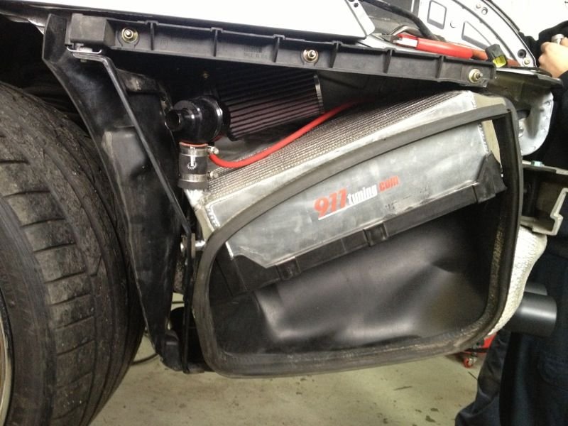

Ur restrictions start with Intercoolers and more so the end tank connections on both top and bottom. Them the Yvpipe. You want to open it all up with 2.5" piping including the y pipe. In pics that's 2.5" intake but is good for 30rs.
U start with Ics and open it all up.

Correct. It's just tight Don't be like the Middle East guys running with only filters on turbos. Lol. U will loose a turbo and possibly more.

Trust me Mark with the weather in the UK filters on the turbos is a no go from the start BUT whats the problem in a dry state/country, Ive always run filters direct on turbos in Mk4 supras no problem.
