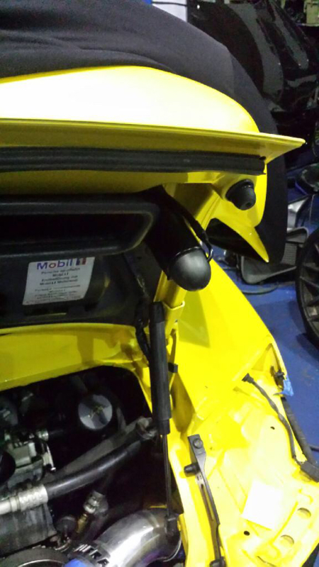

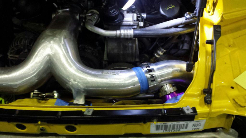

My fabricator is instilling my BBI y-pipe and it's looking good . But we have a problem ... The hydraulic pumps for the wing are hitting the y-pipe.. I really like the ways it looks ... And want to keep it the ways it is..
Now ive disabled my wing pumps, so my wing never moves and it stays in one position... But the god dam hydraulics are huge ... Is there a company that make smaller pump , or is there a solution to remove the oem pump and leave the wing bolted into place ?? And suggestions would be great . Name:  image-3745481483.jpg

I removed all that stuff, replaced it against EB-Werks Fixed Wing Solution and saved another 3,9 lbs. Like the look, your y-pipe looks really good! The mounts are also fully adjustable

I think there is a fundamental problem of the wing-stalk depth, in the down position, the stalks need somewhere to go. BTW, I happen to be a big fan of Dave's kit, but I don't think it will solve your quest to eliminate the stalks intruding into the engine bay-- KH

Dose the hydraulic completely get eliminated so I can have clearance?

Yes, everything can be fully disassembled. Hyd. Spoilers, actuator, lines and some small amount of pentosin. It depends on which Level you will set the wing, I placed it to OEM height and when I remember right it will give you a minimum of 2" more gap to your y-pipe

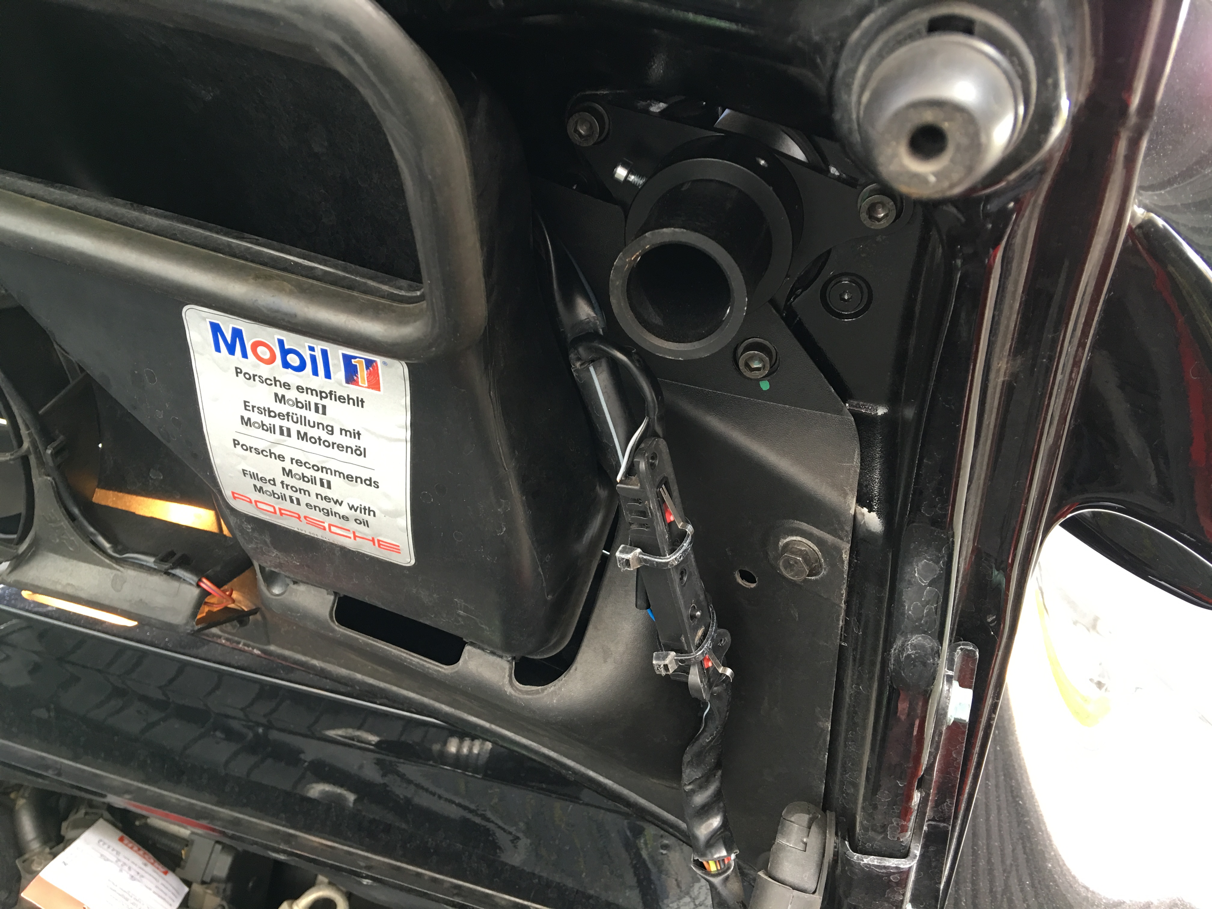

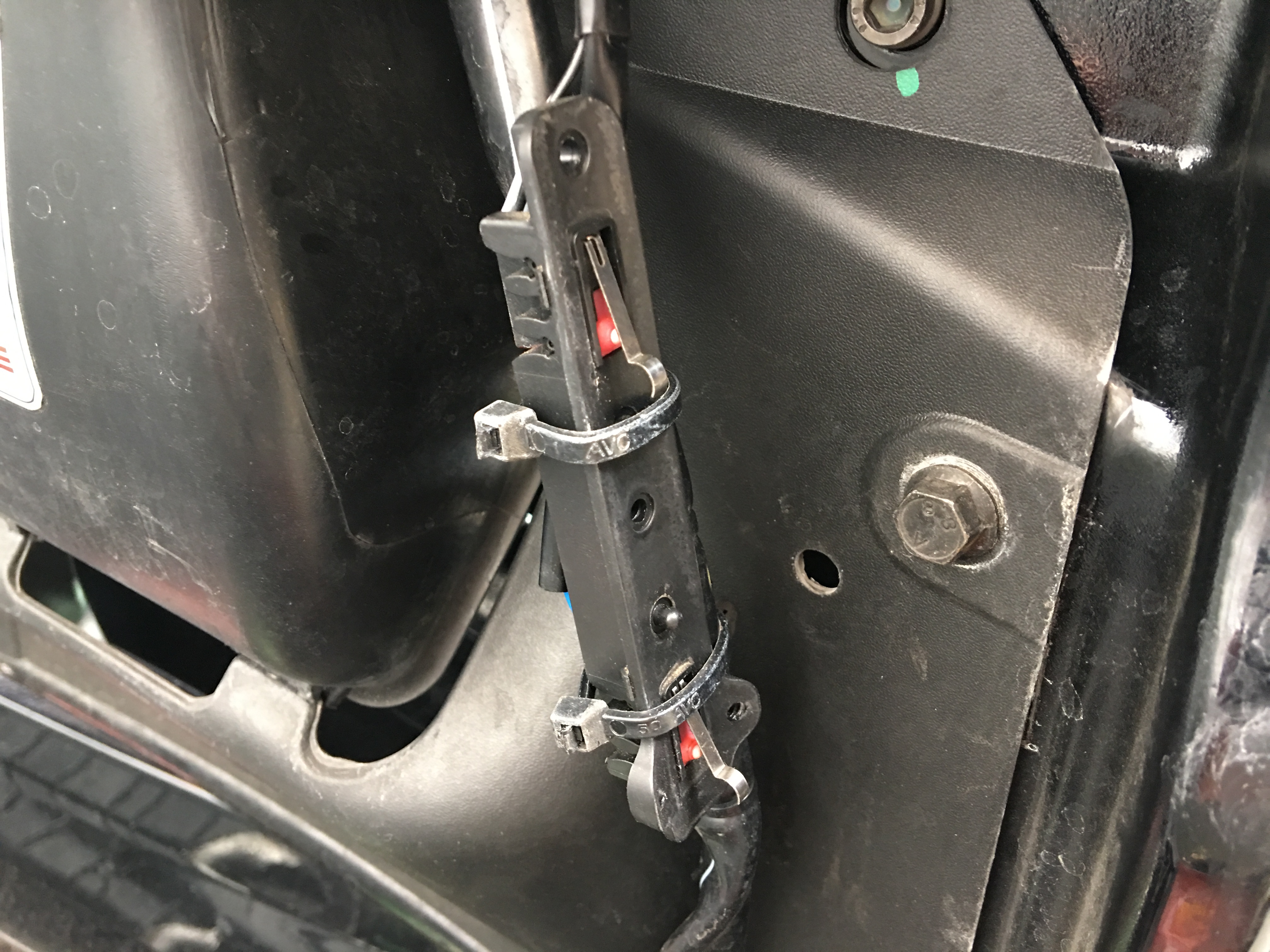

Originally Posted by olwe
Sounds great. A picture of how you dummied the sensor would be appreciated.
here it is
did nothing to the sensor, just demounted it from the hydraulic stamp and strapped it to the cabin light/ fan cable. No signals yet since long time
ID:	446895   Click image for larger version
