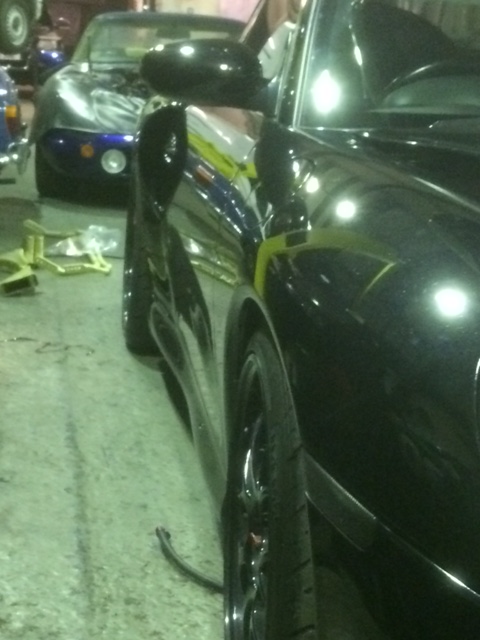

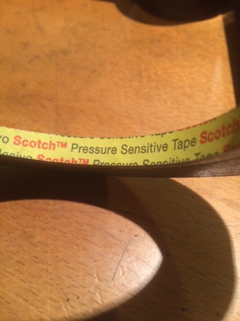

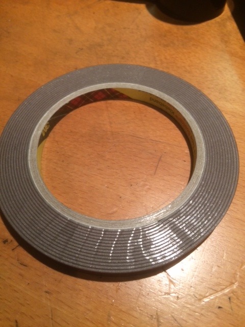

Ok now fitted permanently the tape will hold these HOWEVER I am wary of the stock ducts being torn from the fenders, I think I will have to use 1 self tapping screw to secure the stock duct.

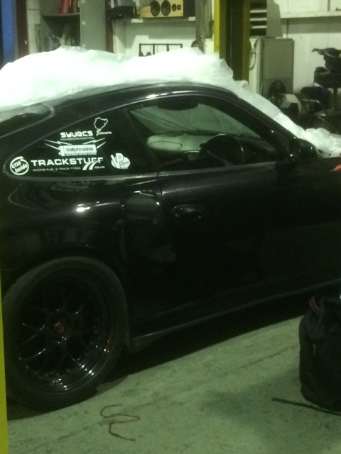

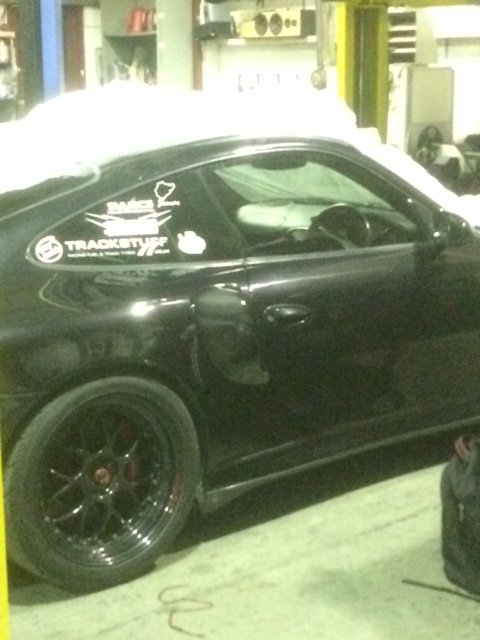

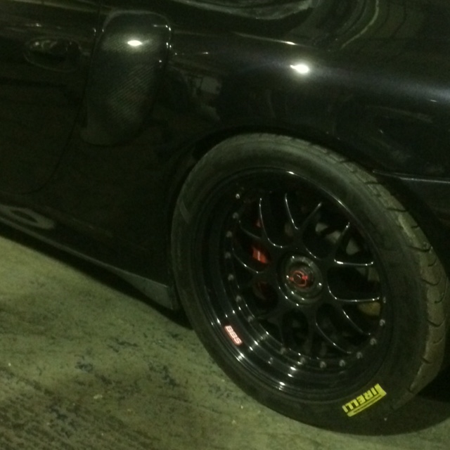

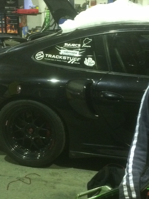

I tried to get some pics from further away but I think we need to get outside so maybe tomorrow or saturday

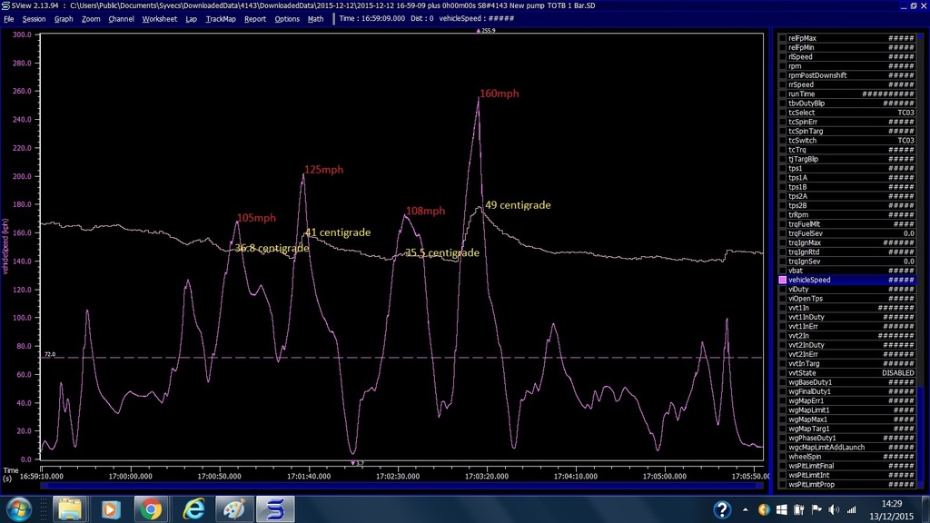

OK guys not as clinical as I would like but got some data from a couple of pulls tonight, outside temp was 12.5/13 centigrade so similar to last logs I sent to mapper
@105mph 36.8 dgrees
@ 125mph 41.6
@ 160mph 49.4
so thats under 50 degrees in 5th, the car was going into 50 degrees by 4th before, the interesting thing is how quick the ACT goes down after you let off the throttle its like its being pulled down by something, im going to send the logs off and will hopefully get something back I can put up as jpeg etc. It appears to be around 10 degrees cooler (centigrade, thats 50 degrees farenheit) thru the 1,2,3,4 th pull at 1 bar boost !!!!
Am I glad I bought them? Hell yeah
Would I take them off? Hell Yeah.......... If you could ever get them off the stock ducts then pry them from my cold dead fingers !!!! These work better than I thought. Joe........................You the man !!!!

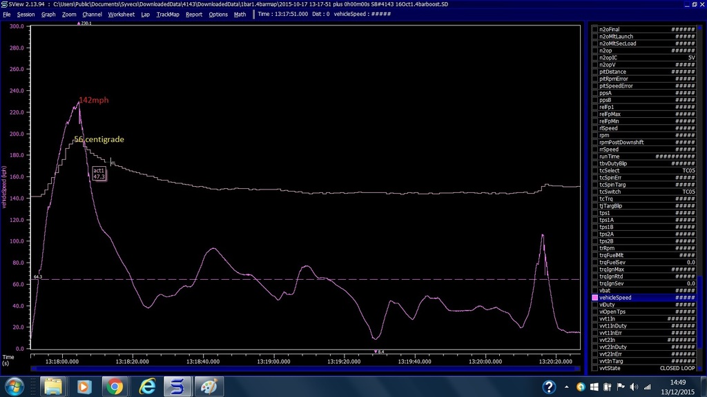

Until my mapper does his stuff and makes a comparison graph this is all I have, on the before graph you will see car is accelerating hard due to steepness of climb, thats 4th gear, second graph is after Joes scoops right into 5th
After

They stay on at speed as well

Heres a mail from my mapper
I need you to run the newer map that I sent you too, the car is still putting out knock signal on cyl4 and I want to see if the changes I made in that config are going to work. I've re-attached it and would appreciate if you can run that file, run it in high and low boost and send me the logs and I'll merge the data into one file that we can screen shot.
Temps wise, it's looking like you're 10 degrees cooler when on it - the air temp still shows 32degree when cruising but that's more due to engine bay temp than air charge temp.
Logs look better though, fueling at WOT is spot on - it's running 1/2% pull on bank1 but pulling 10% out of bank 2 at full throttle still but the final lambda numbers look a lot better and no drop in fuel pressure which is great to see.
When you're on the throttle the temps climb a lot slower with the new ducts.
