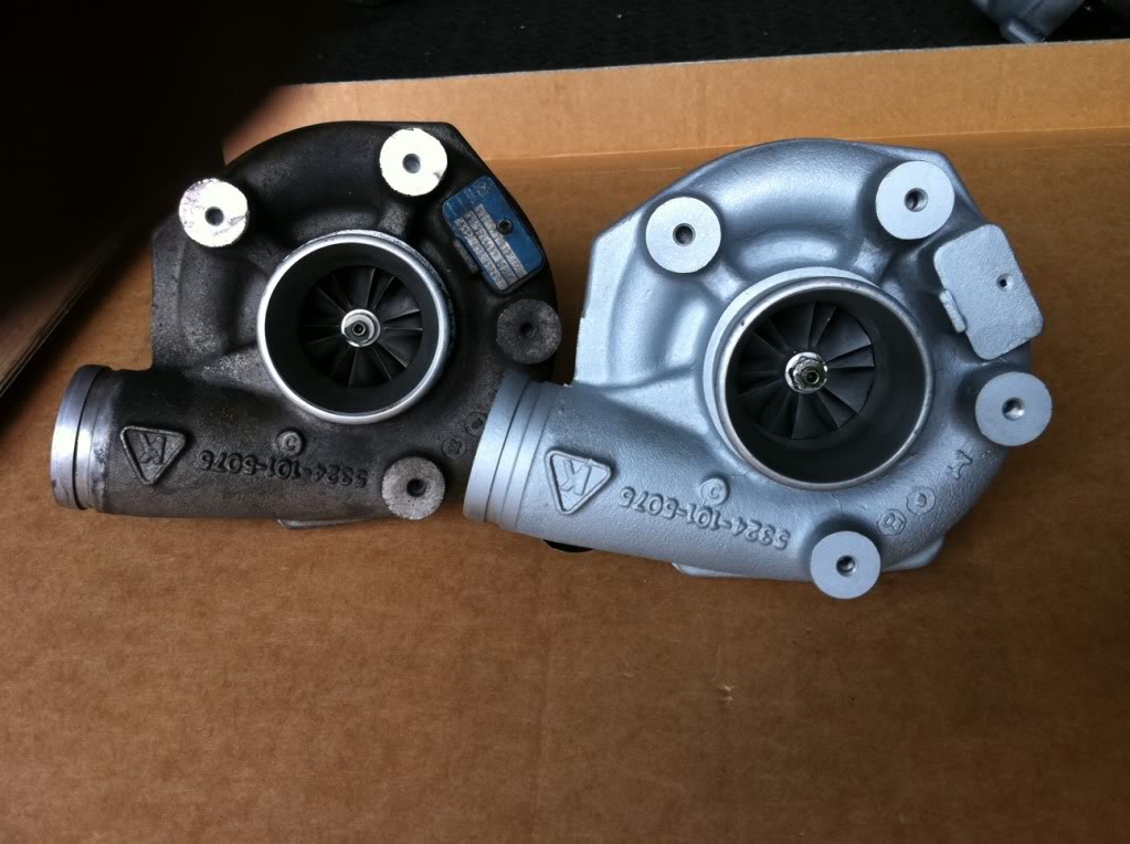

Here is a picture of K24s on the left compared to my K16/997GT2RS on the right. The difference in compressor size is clearly visible. The turbine inlet housing is enlarged and ported to reduce exhaust back pressure and funnel more air to the turbine further improving spool. Zero clearance process (the visible black coating) is used on the compressor housing to create a perfect seal between the compressor wheel and walls of the housing). The compressor wheel basically wears it's own pathway into the walls of the compressor housing coating. As such, a careful break in of around 1000 miles with gradual increase of boost is required. The compressor outlet is also ported and enlarged to reduce back pressure further improving spool and flow on the top end. There is a lot more to it than just sticking a large compressor on a K16 turbo..
Ideally you also want to run 2.75" inlet piping to the turbos to reduce any restriction on the intake. A high flow exhaust is a must.

Originally Posted by pwdrhound
Here is a picture of K24s on the left compared to my K16/997GT2RS on the right. The difference in compressor size is clearly visible. There is a lot more to it than just sticking a large compressor on a K16 turbo..
well, they sure are purdy!
so do the older versions of 16/24's that most made available not have the porting/polishing and "backplating" that the "newer" versions tend to have?
as in these pics of "newer" billet 16/24's? ( right pic obviously )
They do not. 16/24s do not have a billet wheel either.
